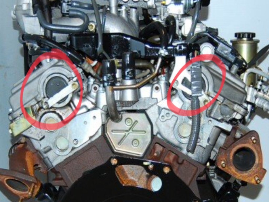

    Let's be clear with our language here. Camshaft PLUGS go in the back of the motor, shown here...

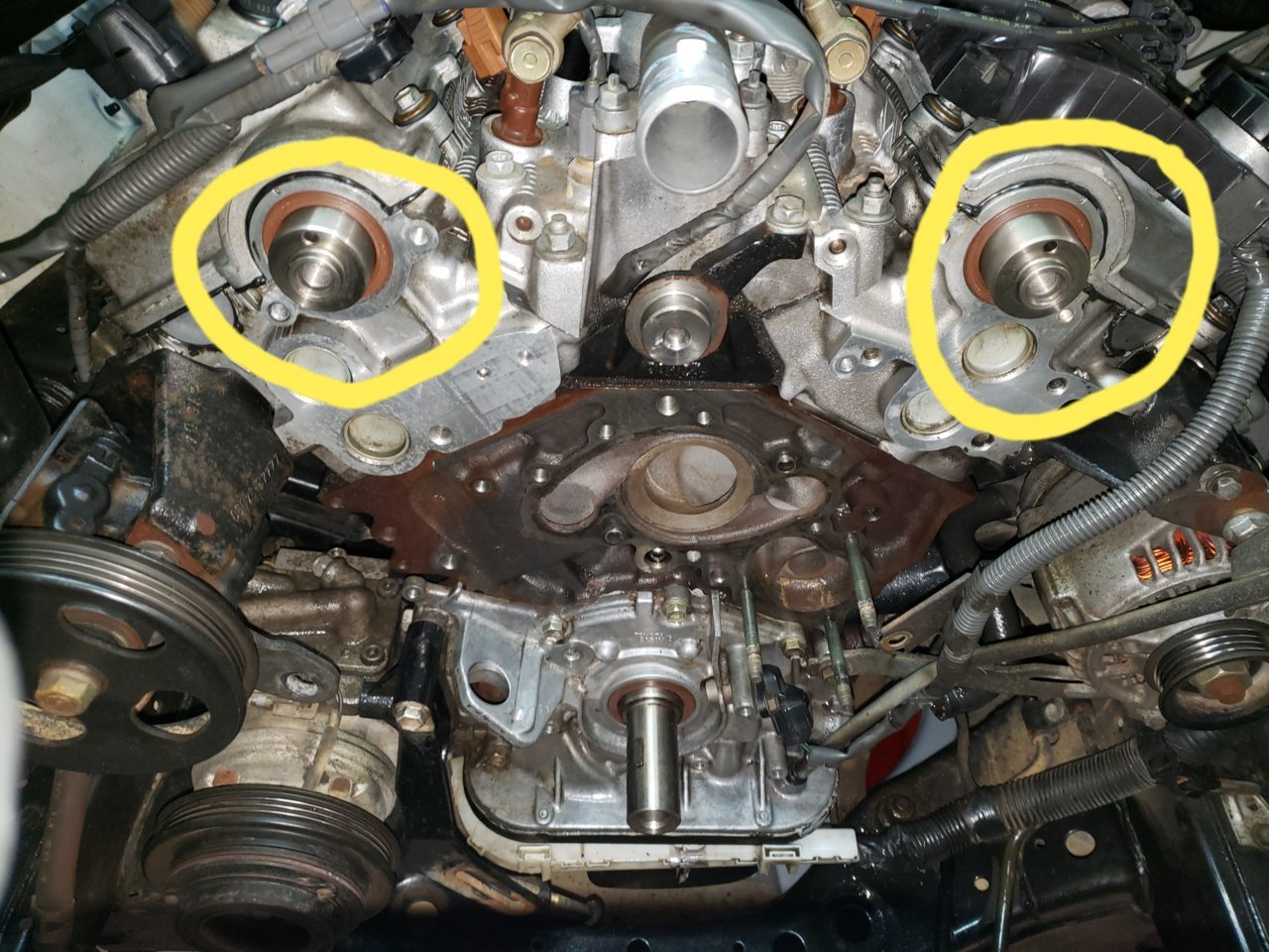

    Camshaft SEALS go in the front of the motor, shown here...
    The camshaft PLUGS should be replaced while the valve cover is off. It is probably possible to remove/replace the plugs without removing the valve cover, but good fucking luck. The camshaft SEALS on the other hand are completely independent of the valve cover, but the front half of the motor (accessories, fan, timing belt, etc) has to be removed.

    So you can get to those without removing anything? Or just a couple things? Cause it seemed tight when I looked at it.

    A few weeks ago, I changed my VC gaskets, half moons, spark plug seals, and cam plugs (the ones on the back). Even with my nephew helping (slows me down), total time was <8 hrs. You should of course get some intake gaskets. I also removed and cleaned my IAC so I also bought that gasket and I cleaned my thottle body with carb cleaner.
    I would just go that route. Those plugs are gonna be hard to change without removing the valve covers.
