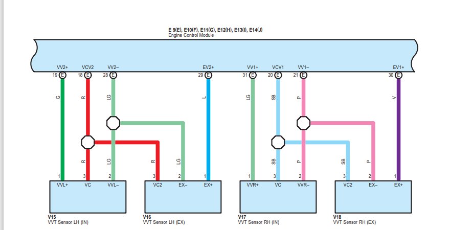

    I pulled my wires out while replacing a spark plug. I have a new connector just don't know which wires are which

    Pink is middle
    Blue - 3
    Purple -1

    Much appreciated. I looked everywhere for this and couldn't find it
