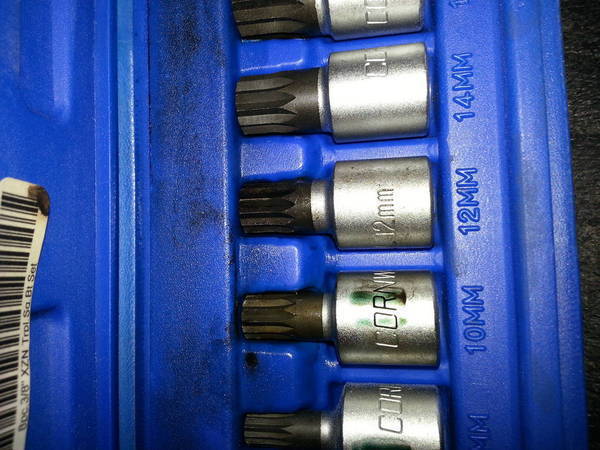

    Yup, if you are in there, you have to pull the timing cover to remove the intake cams. You have to drain all fluids to do that. So since one is there, at least install ARP head studs. www.dezod.com has the best price on those.
    Just need a tripple square socket to remove the factory head bolts.

    The answer to my question! was wondering what socket i needed. You are quite the life saver tor :cheers: Search button is awesome!

    I think its the 12mm
