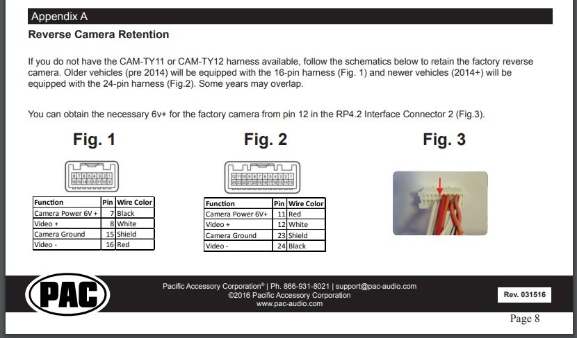

    Where does the 6V wire connect? The instructions says something like putting it in the 12 pin position on the 20 pin connector, but I can't figure it out.

    Clarification: the wire is called "Supply +6V". Is this just a power supply or a reverse indicator? If the former, can I key tie it into the red accessory wire?

    Per the instructions, this wire will need 6V, not 12. My understanding of the instructions is that this is what pin 20 (on the RP4.2-TY11) provides. The harness offers the ability to add an aftermarket camera to the OE radio, or connect the OE camera to an aftermarket radio, which is why it has options.
    So... do you have the RP4.2-TY11 as well?

    Yes I do. The problem is, the RP4 does not have a 20 pin connector that looks like that with the pin 12 location open.
