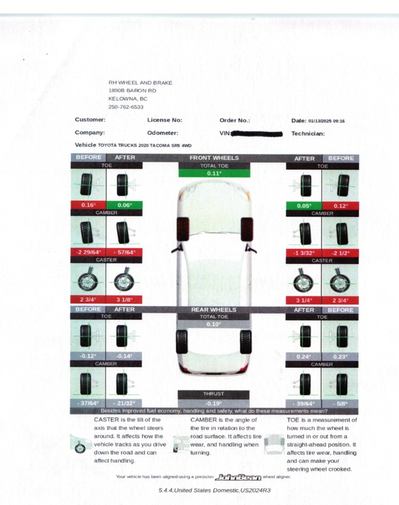

    I recently installed a 2" lift with 5100s, OME coils, and Camburg balljoint UCAs (Pre x-joint version with Moog style Bjs).
    My alignment shop is experienced with lifted Toyotas and custom aliments with SPC arms etc.
    For some reason they cannot get my camber in spec any more than it is on the printout I've attached, and I was told "These arms have a lot of negative camber. We can't get your camber much higher than 1 1/4 degrees left and right."
    The shop has never seen Camburg arms before and therefore aren't 100% sure if they are the issue or if its something else. They recommended I swap to JBA arms but after spending over $2000 CAD on the Camburgs, JBAs aren't exactly in the budget right now....especially when they'll only MAYBE fix the issue.
    Truck handles fine enough, just worried about ruining tires.
    I've done some searching through the TW threads and cant find much info on this.
    Any ideas?

    Camber isn't horrible. I wouldn't worry about it. Caster is what you would like more of.

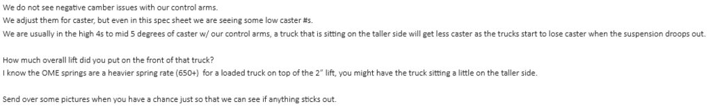

    Yeah i emailed camburg and I should have way more caster. Waiting to hear back from them but something definitely seems off.

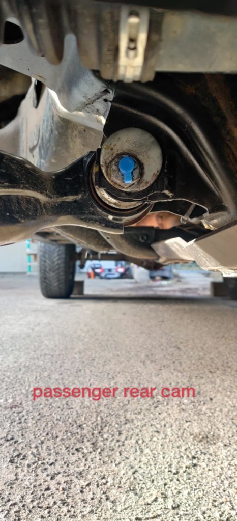

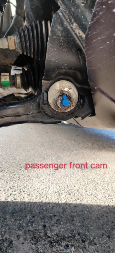

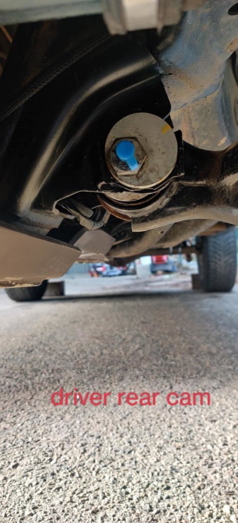

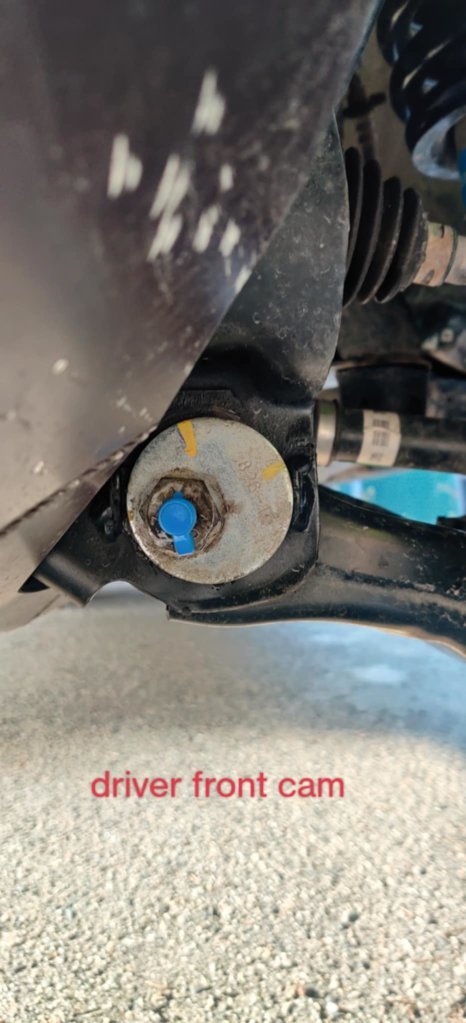

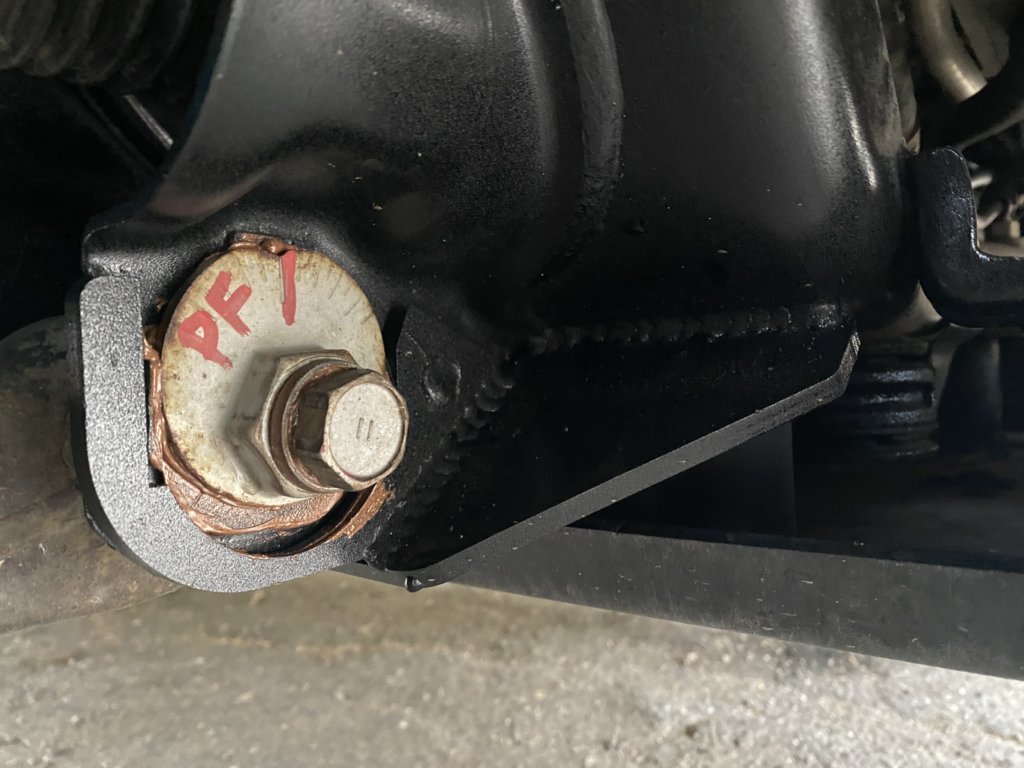

    post pics of how they have your alignment cams set

    The fact your driver side is full in on both and you still have almost a full degree negative means your uppers are either too short (if adjustable) or something is bent.
    Passenger can come in a little on the front (camber-dominant) to eat a little more of that camber and there's slack on the rear (caster-dominant) to go out a hair if you need to get caster back.

    Smells like a bent spindle or UCAs too short then. Caster/Camber will be mounts/joints, control arms, or spindle.... there's nothing else that will impact it.
    Spindles bend super easy so would not be surprised.

    if i was a betting man id say drivers side spindle is bent and the shop aligned passenger side to match as theres loads of adjustment on that side. technically if you went with spc arms you could use the adjustability to compensate on that side. i personally dont recommend them as their quality has gone down significantly over the years and they wear out fast
    on a side not if you still have stock bushings then do not grease them with those cam bolts. rubber bushings have no moving parts and do not need grease. having the sleeves spin on the mounts would be bad.
