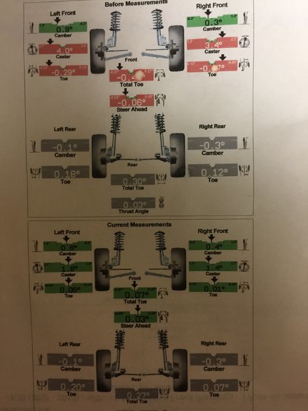

    So I took at the pre-alignment specs. Look at that. Way more caster and almost the same camber. I'll head back to the alignment shop Tuesday and see what they can do.

    I think you need to go back to the alignment shop and ask for 0,0,3
    It seems as if they just went by the green on the computer but no actual experience on lifted trucks

    Yeah they just didn't know what they were doing IMO. They definitely were just looking to get it in the green and go. That tells me they can get caster to 3 with camber close to 0 no problem.

    All fixed. Took it back to the shop and the got 2.5 with 0 camber. No more tire rub!
