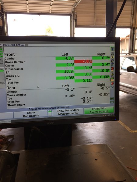

    @YotaDan Should I try to get more Caster on the left? Or leave it alone?

    I would say only if you are having a pull issue to the left. If it is driving straight, then no need to mess with it.

    Ok. Thanks. It goes straight down the road with my hands off the wheel.
