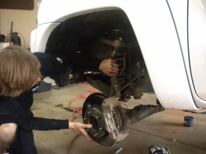

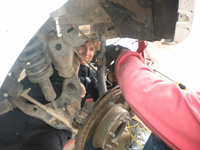

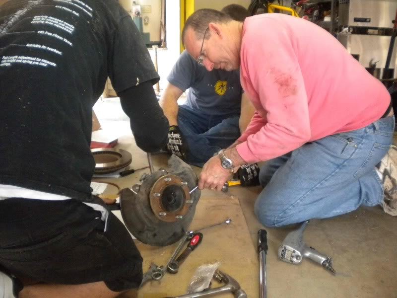

    disconnect abs sensor and brake lines from the existing mounting points. also disconnect the steering from the spindle.
    unbolt disk from the rotor assembly and hang somewhere. unbolt the upper and lower control arms.

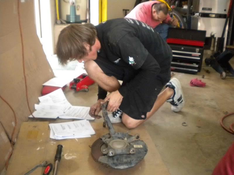

    stock spindle with hub assembly
    remove hub assemble from the stock spindle
    new vs old spindles
    install hub assembly on new spindle
    install new springs at any time now

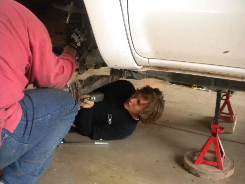

    now put on the spindle. 2 bolts lower for the lca and 1 bolt for the uca
    install new brake lines, abs sensor, and disk brake. might have to grind down the disk brake a little because the welds on the new spindle are a little beafy and get in the way of a proper mount

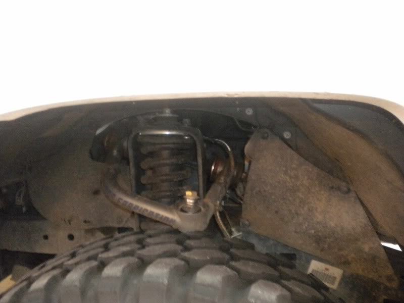

    everything attached in the wheel well ready for putting the wheel back on

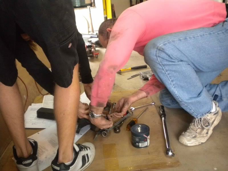

    a huge thank you to taylor (masada) and his dad for allowing me to use their garage and tools. taylors dad was a tremendous help especially when it came to those damn brake lines, so thank you!

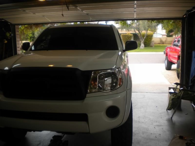

    i will post after pics later, been to busy enjoy it! the ride is 1000x time better than my ome 884 setup, my setup actually doesnt clank when going over a speed bump and i dont feel every single bump in the road.
