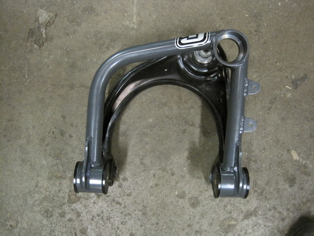

    Yeah...I can live with removing the front mud flaps but I'm torn on trimming any further than that. I may just have to suck it up...especially if I go with larger tires in the future
    I found this pic online (it's a Tundra ball joint UCA) but it compares it to stock. You can see where the ball joint sits further back.
