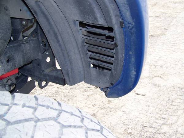

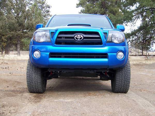

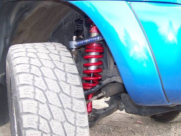

    I, with the help of my brother, a few days ago installed 2.5" Camburg coil overs with Total Chaos ucas. I had a 2.5" spacer lift but the front coils were starting to sag. The camburgs are set at about 2.75" lift. In the rear I have an Alcan add-a-leaf on the non-tsb leaf pack and a 1" lift block. We also put 2" racerunner shocks in the rear and they are awesome. They are the extended length version, but ideally could still be about an inch longer. Probably a bit overkill for the way I drive but I figured hell why not.
