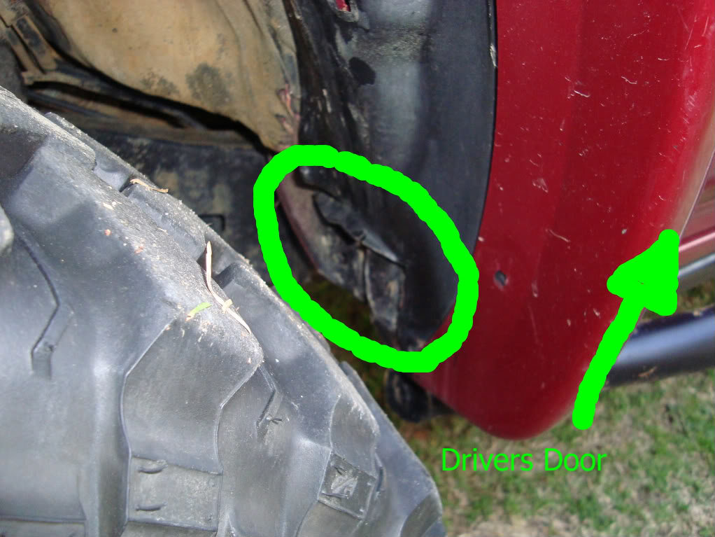

    I have Camburgs coilovers installed on my truck and recently changed out my stock tires for 285/75/16 BFG All-Terrains. I am getting a little bit of rubbing in turns on the rear of the fender well. I trimmed out some of the plastic liner which helped, but the tires are still touching a little bit of metal in turns. I know that I can adjust my coilovers to give me a little more height and added clearance for the tires but I'm not sure how much of the thread should be exposed on the coilovers. For those of you with Camburgs on your 1st Gen 4x4's, how much thread do you have showing? Thanks!

    JB
    2014 DCSB TRD 4x4
    hold on i think everyone forgot about the pinch weld mod
    OP...hammer the pinch weld flat (thats the exposed metal underneath the plastic liner)
    thats where youre talking about right?

    Tiger, yeah, that's exactly where I am talking about. I'll let you all know how it works out once I'm able to do it. Broke my leg a few days ago so mods are on hold for a while.

    now that youve trimmed the plastic...its easy to do
    you can remove the tire and use a BFH...but i chose to leave the tire in place...i used a regular sized hammer and got it pretty flat...then all the paint i chipped in the process i sprayed with flat black rattle can
