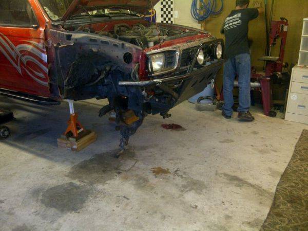

    I took a break to go play some poker:)needed some money for those rack bushings:) haha
    All I got left is both the lowers and that's it.
    The uniballs are a mm too long so the clips won't set in right. So my dad is gonna put them on the laithe at work tomorrow and trim down a mm:) more progress tomorrow!

    Nice,
    Did you do any more crack hunting?
    And can you post a pic of the crack on the side so I can see what you're talking about,
  8. Dec 12, 2011 at 7:08 AM

    Not yet, ill take better pictures tonight when I get home, but so let's say the coilover was bolted up to the shock bucket. The crack is right on the crease of the bucket where it bolts in, on that 90 degree angle.
    Mobin dez bro.
    I'm not the nicest person to my truck. I drive like a bat out of hell off road, hence why I got the cage first lol.

    Not to sure what you're talking about still so I'll be waiting for pics :cool:
    Should probably do some good crack hunting tho, as the front most likely isn't the only place there are cracks.
  11. Dec 12, 2011 at 8:20 AM

    Eric you're going to break even more shit unless you do this right. Do yourself a favor, aside from fixing the cracks, put in some coil bucket gussets. I would even go so far as to put in the secondary shock hoop even if you are not planning on running a secondary.

    The way you beat on her, yes probably not a bad Idea, as if you change the location of the UCA it'll change the whole kits geometry, so you're going to need them anyway. As running a 12" COisn't going to be changing the geometry of the kit, just allow you to run dual springs.
    As for the cracks, crossmember are a good place to start anywhere were to plate or parts meet or somewhere that take a lot of load.
    And Jason's right, should get some secondary shock hoops just for now for the extra support of the CO Bucket.

    Yeah, but that's good piece of mind, I'd def get those UCA Shear plates on there before New Years.
    Well the proper way to weld over cracks is to drill out holes at each end of the crack then groove the crack slightly so the weld sits in further, then weld it, then grind it down smooth (optional step)

    okay ill order the coil bucket gussets. ill probably see if brandon has a couple hours one day to weld those for me.
    thanks for the help on the cracks, i wouldnt have done that!
