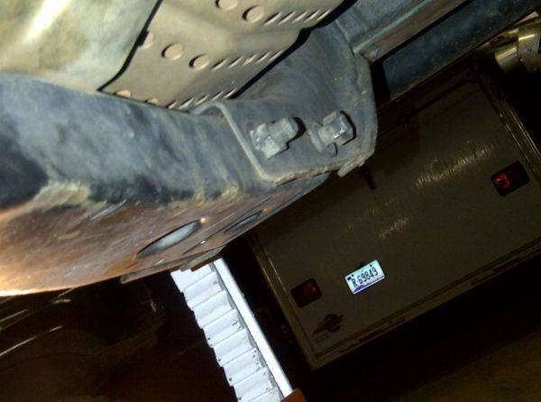

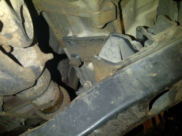

    Okay so that hollow piece in the lower is not coming out. Got the rack off and new uniballs pushed in. But this fuckinh hollow thing won't. Tried a bfh, big fucking air hammer, pb blaster, and a torch. Help??

    There's pics of it on the previous page, the bolt came out hollow sleeve and the sleeve is froze in there. We took a sawzall to it, but now I'm at harbor freight waiting in line for more sawzall blades:)

    of theres no other tranny mount bolts in there either..

    heres a picture of the crack that you couldnt see.. inside the coil bucket on the top, where its clean is where the crack is, right on the 90 degree angle
    i can see completely through the crack BTW, pic makes it look small but everywhere its clean theres a crack that whole length
    and decided to take a sawzall to the lowers to get them off. after a couple hours with a BFH and a air hammer you get tired of that shit. i need to go get even MORE blades.
    i think im gonna need to cut one off the other side too.
    joy of working on a truck with 170k miles

    the cracks in your coil bucket are from the suspension not being strapped. those 3 bolts act as the limit strap when the suspension fully droops when you air the truck out

    That crack will probably be okay if you just drill/weld over it (and grind it smooth) try and close the gap making the plates touch before you weld it so everything lines up, and you'll have the pinch plates on there for extra support. As well as Matt pointed out, with Limit straps on there they'll take the load from full droop instead of it being on the C/O fulling extending.
