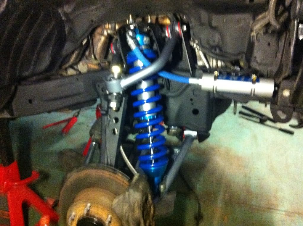

    Mine look like this

    Connical shape is to keep the coil away from the axle.
    This is what full droop with axles and very shitty quality is supposed to look like:

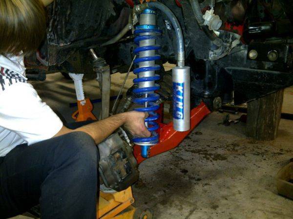

    it is full droop for sure.
    i moved the collar all the way to the top and i think i can just collapse the shock some. even with the upper arm off and the lower all the way drooped possible it still about 2 inches off. ill get a picture
    uh oh.... anthony ran it with 4wd? it is full droop for sure
    yes it droops like another 2 inches
    im sending a pic to live right now

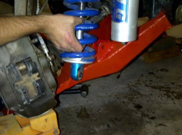

    thats with the upper arm off and the lower allll the way down, absolutly no preload on the shock. do i need to compress the shock to make it fit?

    how did you measure to make sure the shock is an 8"?
    did you remove the coil? you should not have the compress the shock to make it fit

    Now I see a jack under the LBJ. Why is that there?
    Get eveything out of the way and stand on that fucking brake rotor. :D

    just the shaft length?
    the jack isnt touching anything haha. want me to move it to show you?:)
    i can stand on the lower without damaging the axel?

    Trust me, if you're skinny ass hurts that axle, you're truck has bigger problems.

    you measure ex and col lengths from center lower mount to top coil mount... which means you need to remove the coils springs. those shocks look like 10's... and take out all the preload like we told you girlfriend!!!

    the shocks should be 24" ext. and 16" col. per the king website
