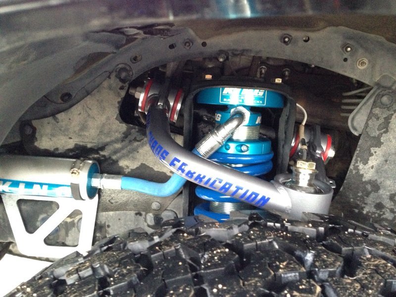

    TCFTW...haha... Really you can't go wrong with ether company they both put out quality product. My DD has TC UCA (uniballs) for the past 2 years, I lube them with Tri-Flow every 3-4 months while I check everything else out. Not sure what all the talk about not wanting to perform "preventative" Maintenance is about, its a part of owning anything with wheels.
