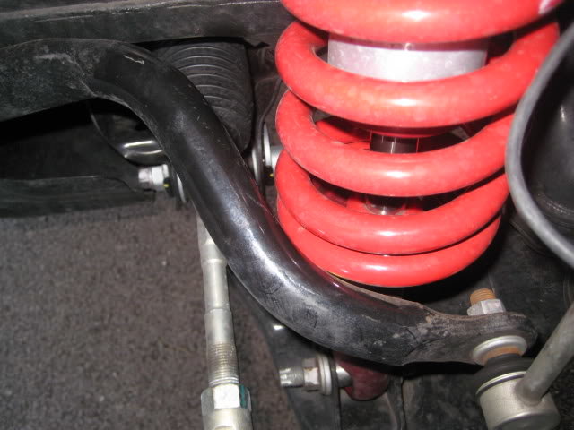

    In mid-October, I got my 4" Camburg Spindle Lift and Camburg Coilovers installed on my 2009 Taco and got this irritating squeaking sound like something needs WD-40. I took it in to the shop that installed my parts and found out the coilover spring is touching/sitting on the sway bar. Anyone ran into these issues. I guess Camburg addressed this issue in the past by providing a spacer for the sway bar to prevent it from touching but maybe it's not compatible with 2009+ models.
    I gotta wait till Monday for the shop to call Camburg to see what they say.

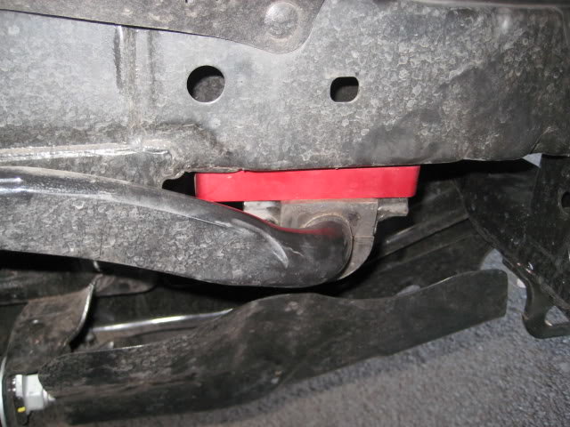

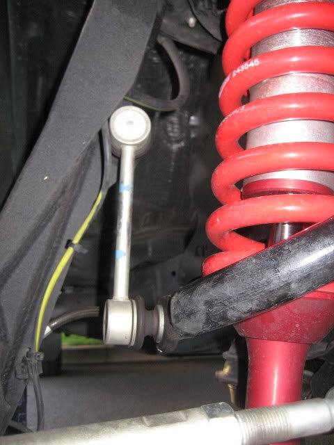

    The shop recommended 3 possible solutions...1) Extend the sway bar mounting bolt near the spring to lower the sway bar but could possibly interfere with steering(too close), 2) replace the spacer that camburg provided with the spindle kit with a bigger one to lower the sway bar, or 3) move the sway bar forward more(which they already did).
    Either way, I hope it's Camburg's fault so they could cover the parts necessary to make it right.

    Before anyone says this thread is useless without pics:
    Here's the spring sitting on the sway bar:
    The spacer that Camburg provided with the spindle lift kit:
    And this is the bolt that they could possibly extend but might affect steering:

    cjimenRR is the winner. Camburg's response is to grind the area where the spring rubs and it'll fix the issue and won't have any effect on the sway bar. I was ready to just remove the sway bar because having a nice looking truck that sounds like crap when you drive it makes the whole ride crappy, but I'm gonna have the shop shave a lil off the sway bar for now.
