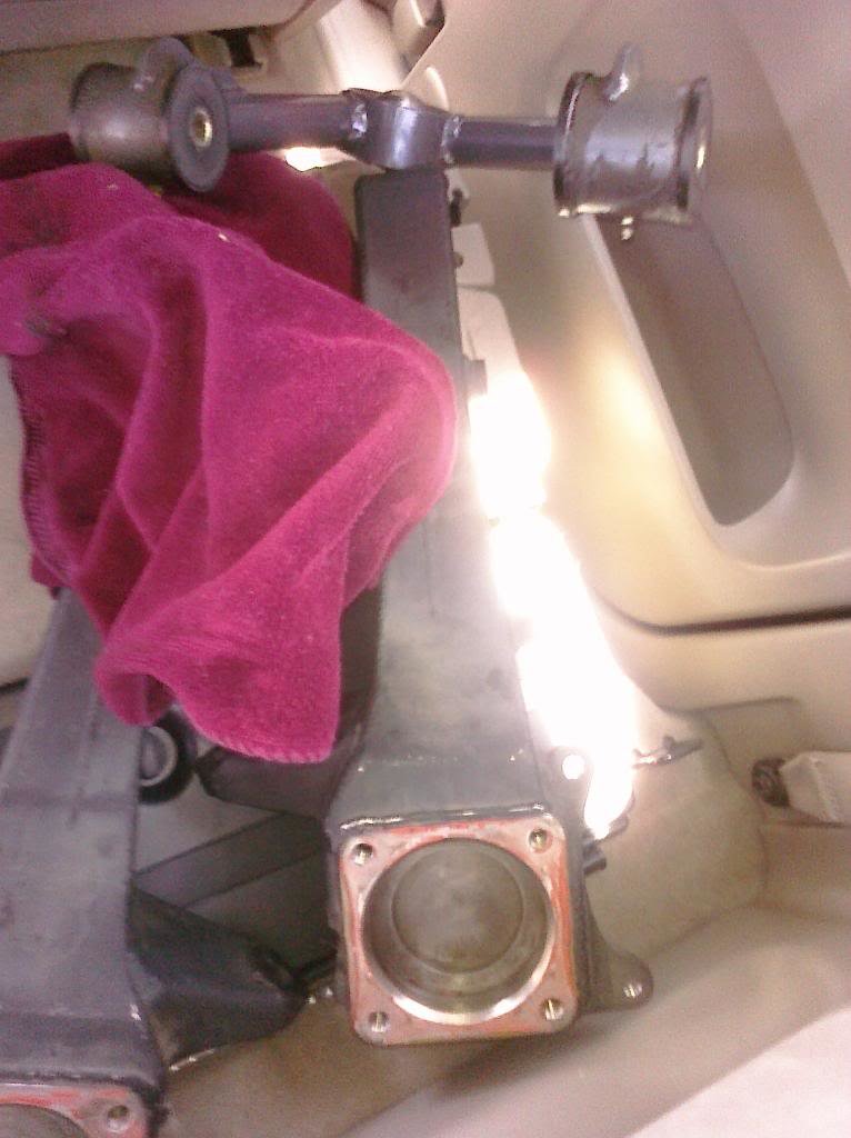

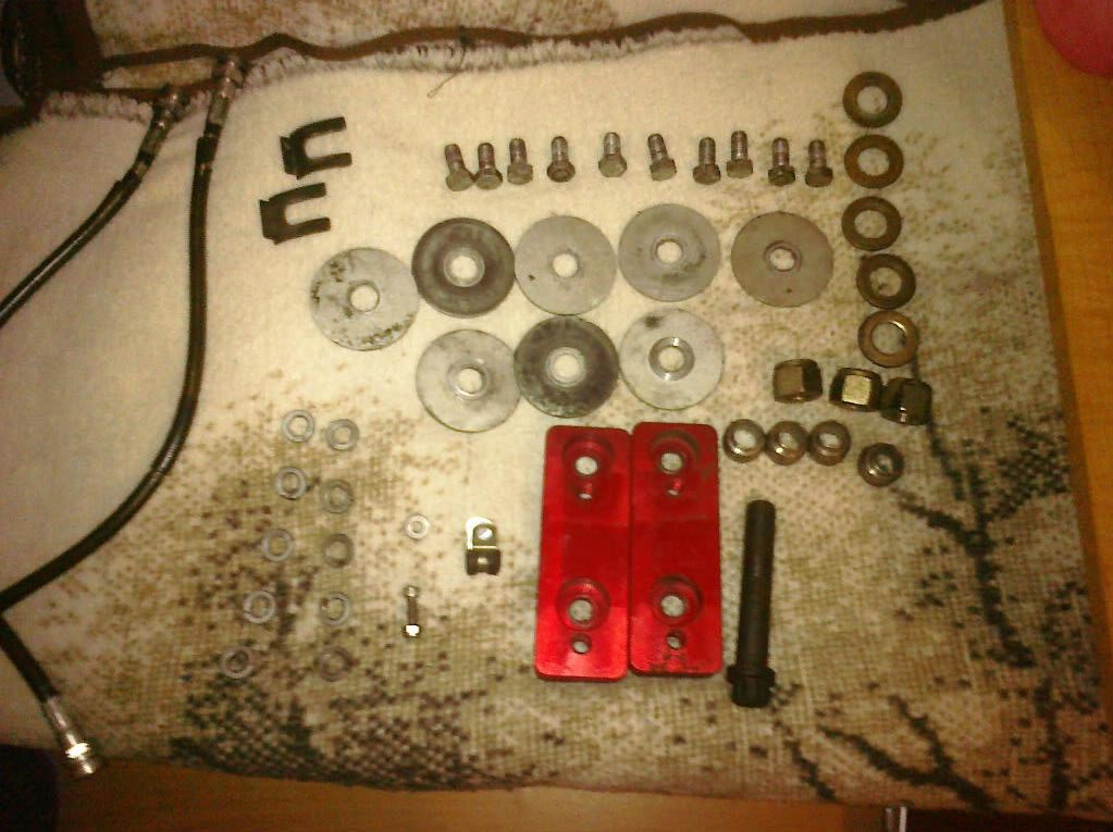

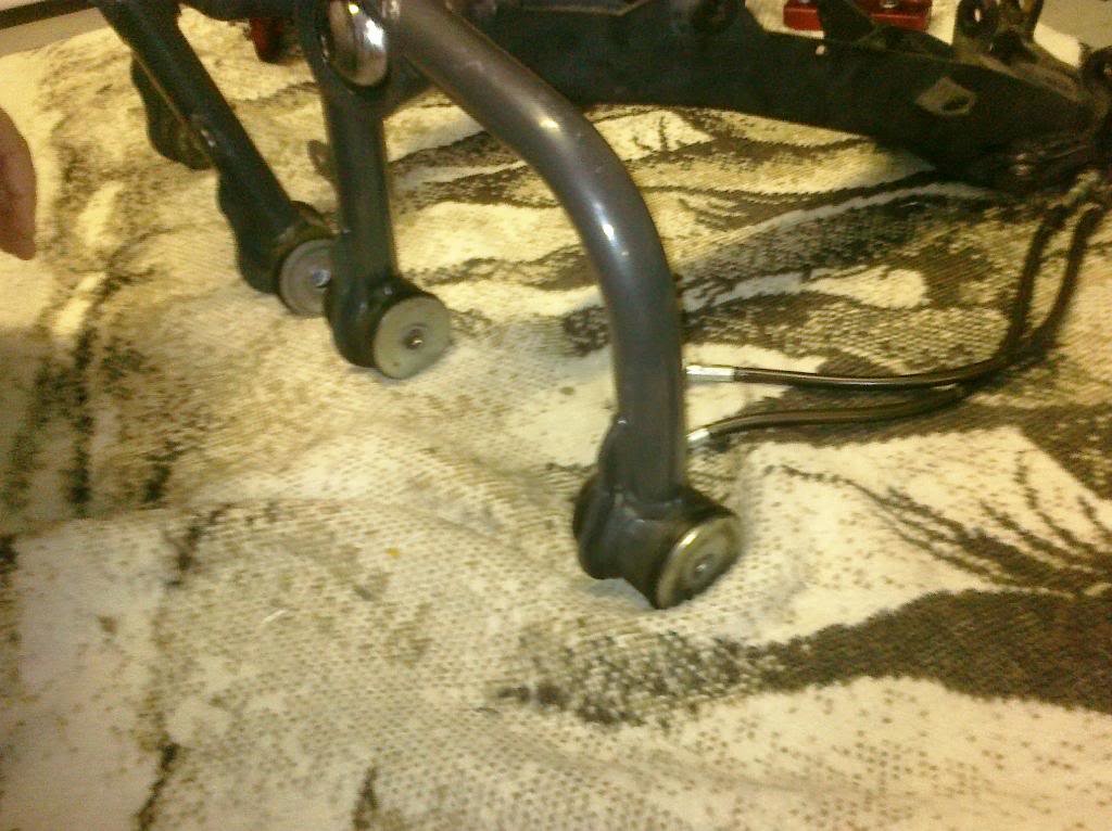

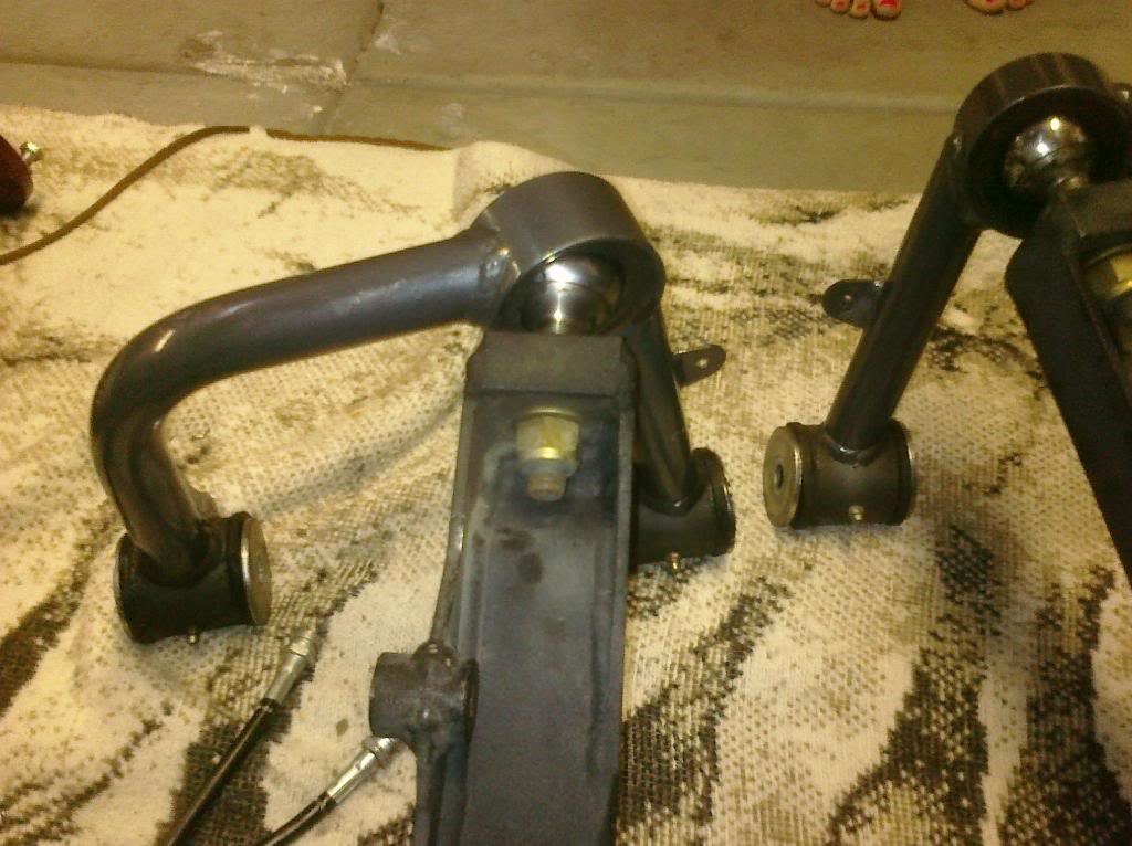

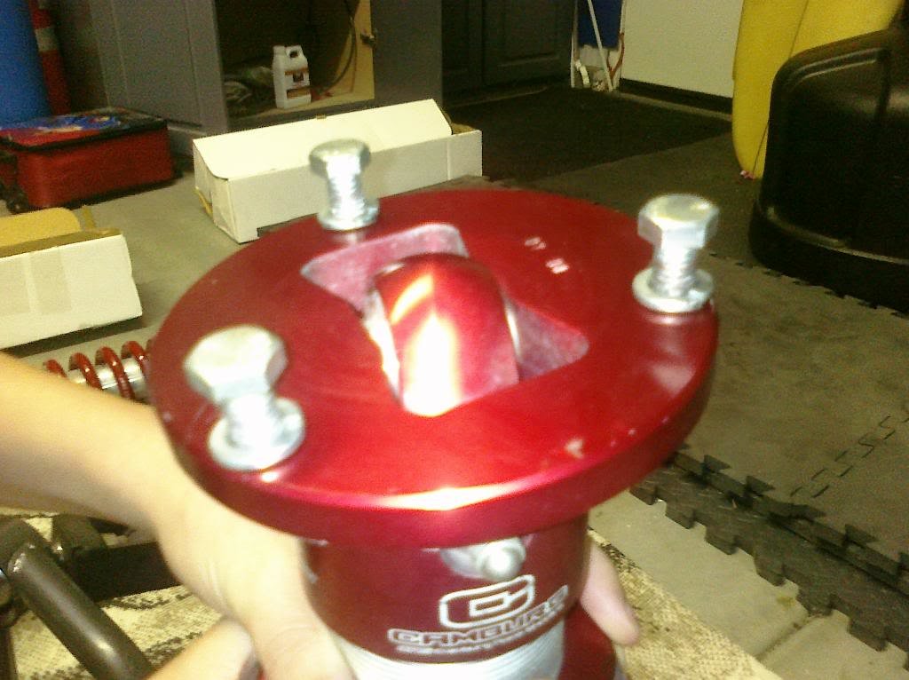

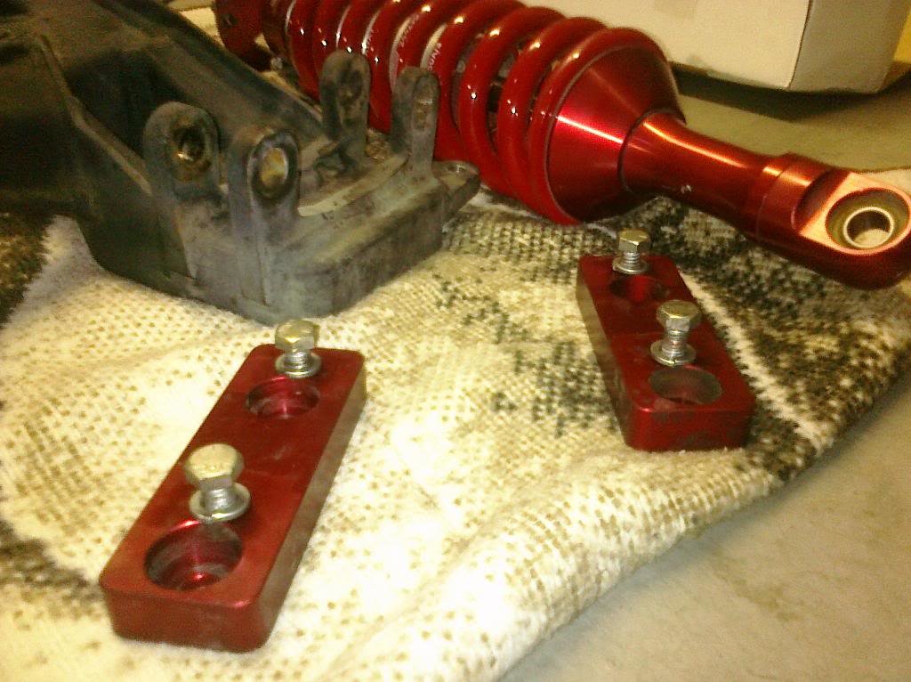

    I NEED HELP!!!! So i bought all of this used and it all seems in pretty good shape. But when i bought it, all the bolts,nuts,washers,ect.... can in one bag. I hope some1 can help me out here and tell me if i have everything i need to install them (which im pretty sure im missing something). Also if you guys could tell me what goes to what that would be great and thanks in advanced for all the help - Chris
    Sorry for the shitty cell phone pictures
    CoilOvers
    Spindles & UCA's
    Bolts,Washers, Nuts, ECT....

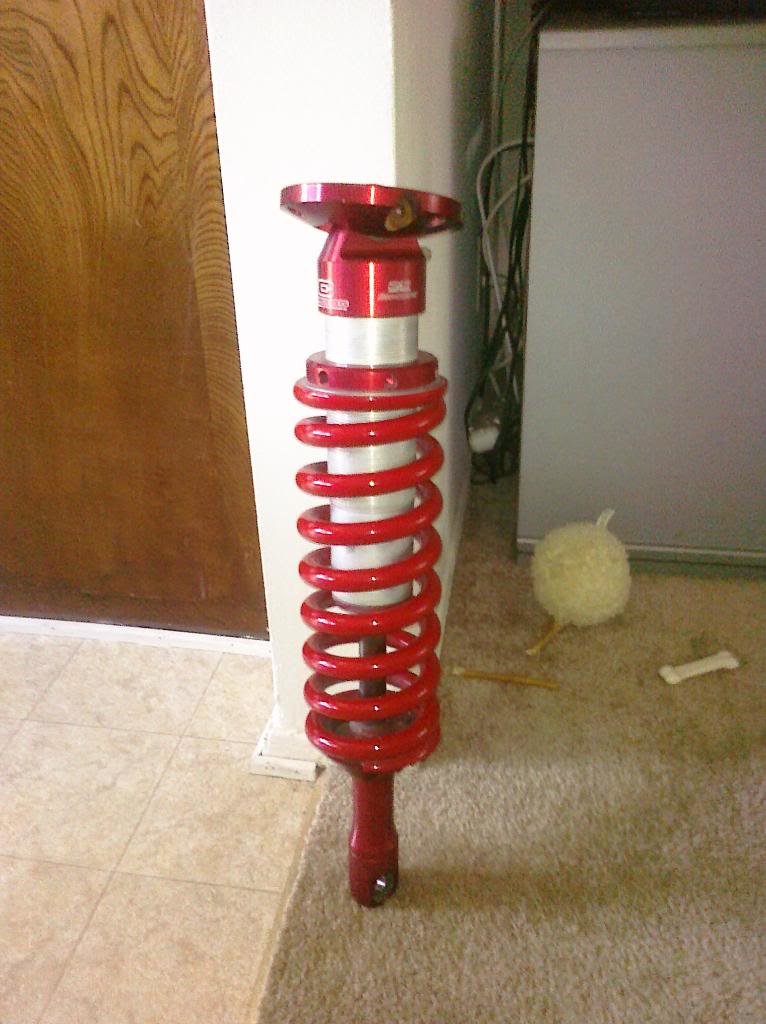

    The smaller bolts are for the CO's to bolt to the top plate (3 per shock), and the other 4 are for the sway bar spacer. The larger black bolt, is to mount the spindle to the lower control arm. You should have 4 (2 per side).

    Thanks Chris for the help that just helped so much. Now what about the UCAs I no that's were the washers go right? Am I mishing the bolts for the UCAs ?

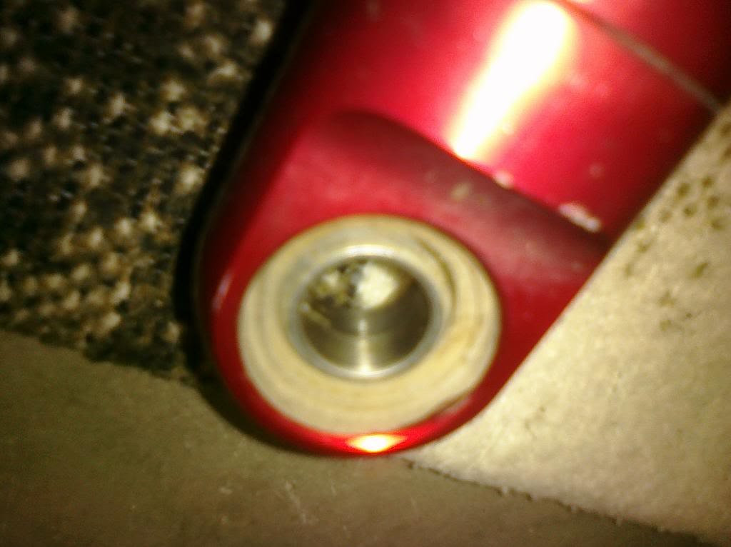

    I have the same CO you'll love them. There is suppose to be a bearing or bushing thing on the bottom of the coil are you missing that? I don't see it in your pictures.

    Yeah bro I'm prerry sure they are in there, I think it's just the angle of the picture. And I hope mine ride as good as yours (im sure they will). Thanks for the help FixedTRD

    That large black bolt attached the UCA to the spindle. You should have 2 of 'em.
    The shock pictured appears to be missing spacers at the bottom. Is this all of the hardware that you have?

    You re use the factory bolt, and nut for the UCA's. The large washers go along the sides of each bushing for the UCA.

    Thanks for all the help again guys i really appreciate it. And if any1 can help me figure out where all these other bolts go or if im missing something that would be great. Also let me know if i put something in the wrong spot so i can change it. - Thanks

    The Black bolt is one of 4 that bolt the spindle to the LCA. 2 per side.

    thanks chris, do you know if those washers go on the black bolt? Can any1 else chime so I can put this on next weekend. - Thanks

    those nuts go on the black bolts tho right cause they fit right on there. Or does it screw in the LCA?

    IIRC, they screw into the LCA.

    The 2 clips on the bottom right hand last row are for you brake lines. You should have 4 total. You might have to reuse your old ones since you only have 2.

    no the bolts go straight thru with no screwing and the nut holds them on thats how mine were any ways
