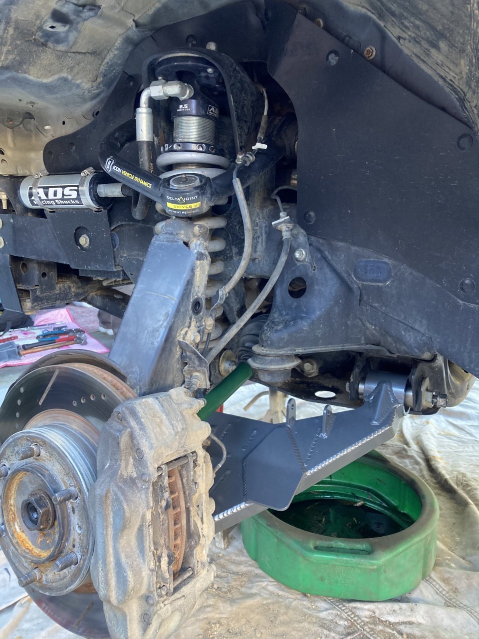

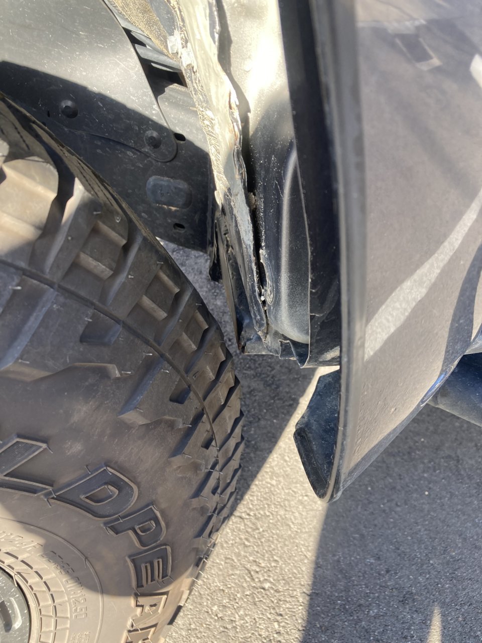

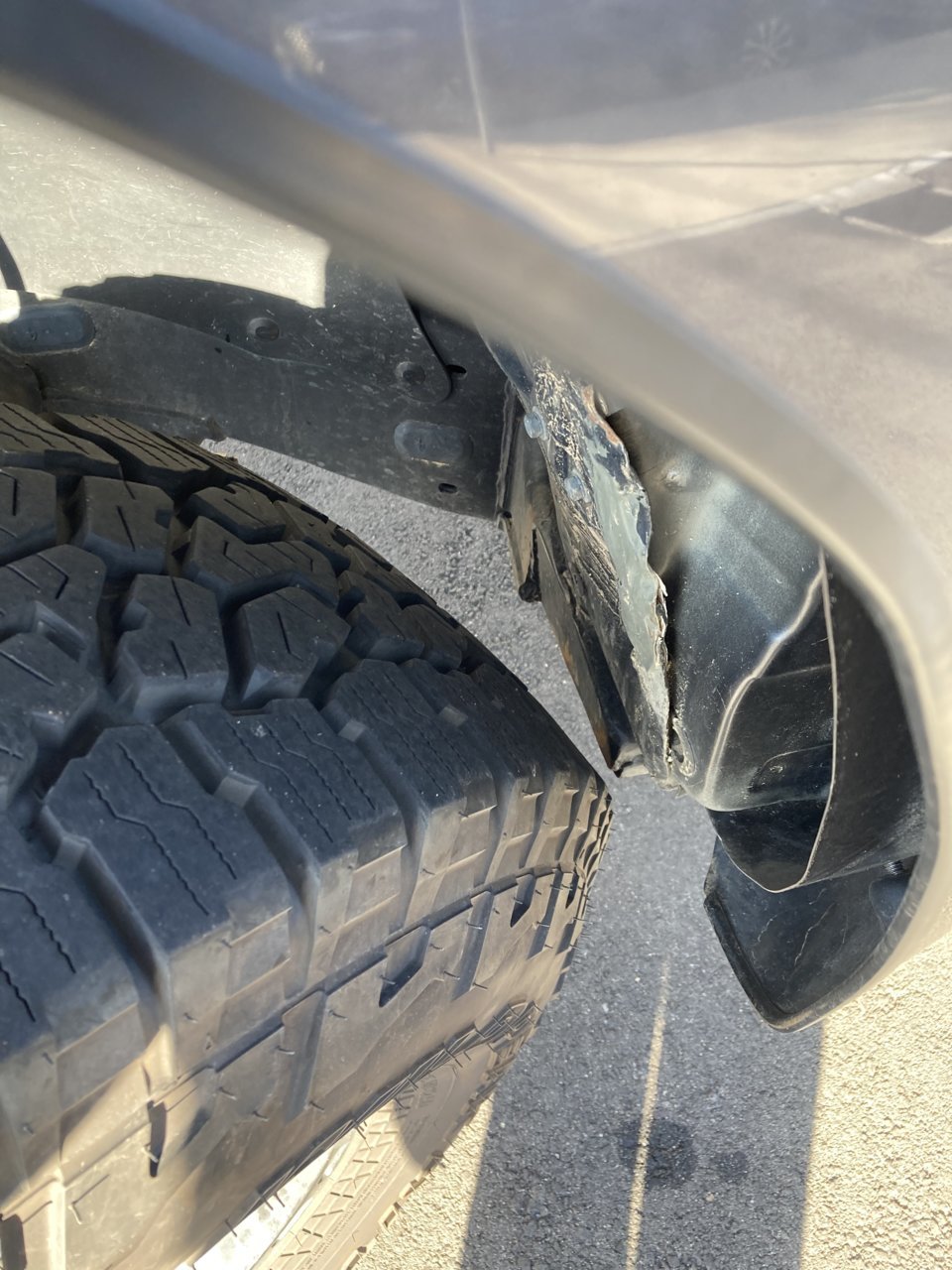

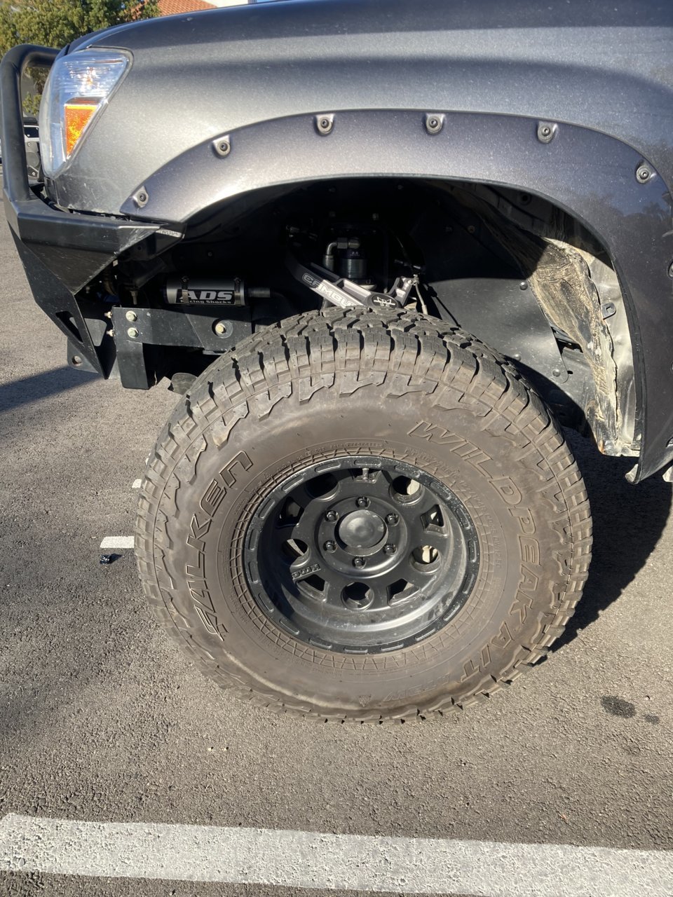

    Post install issues.
    CMC is not enough for 315’s on 16x9 with 4” backspace. Will be doing cab mount relocation from All Pro next weekend.
    Obvious is the need to get alignment. Tomorrow.

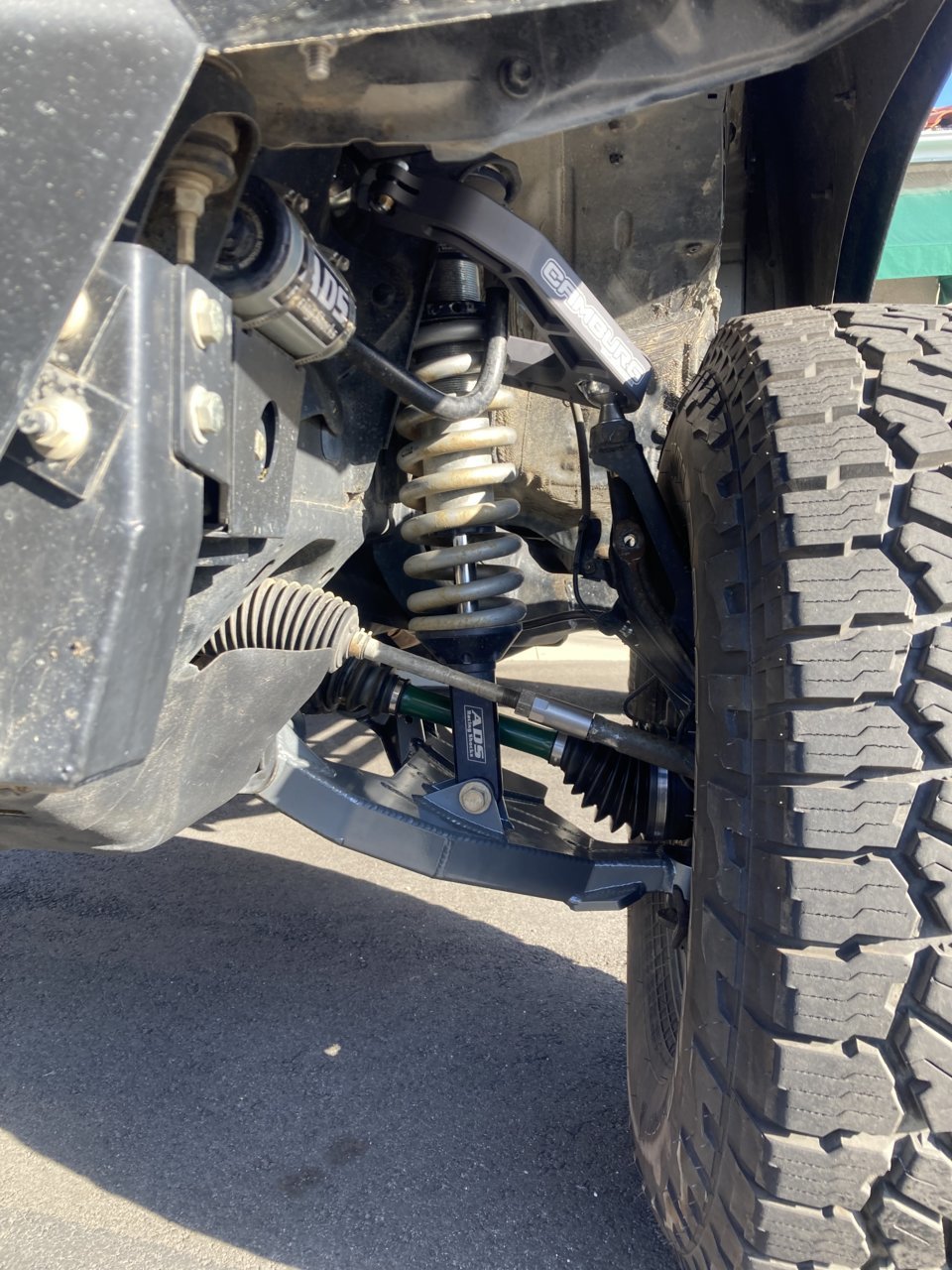

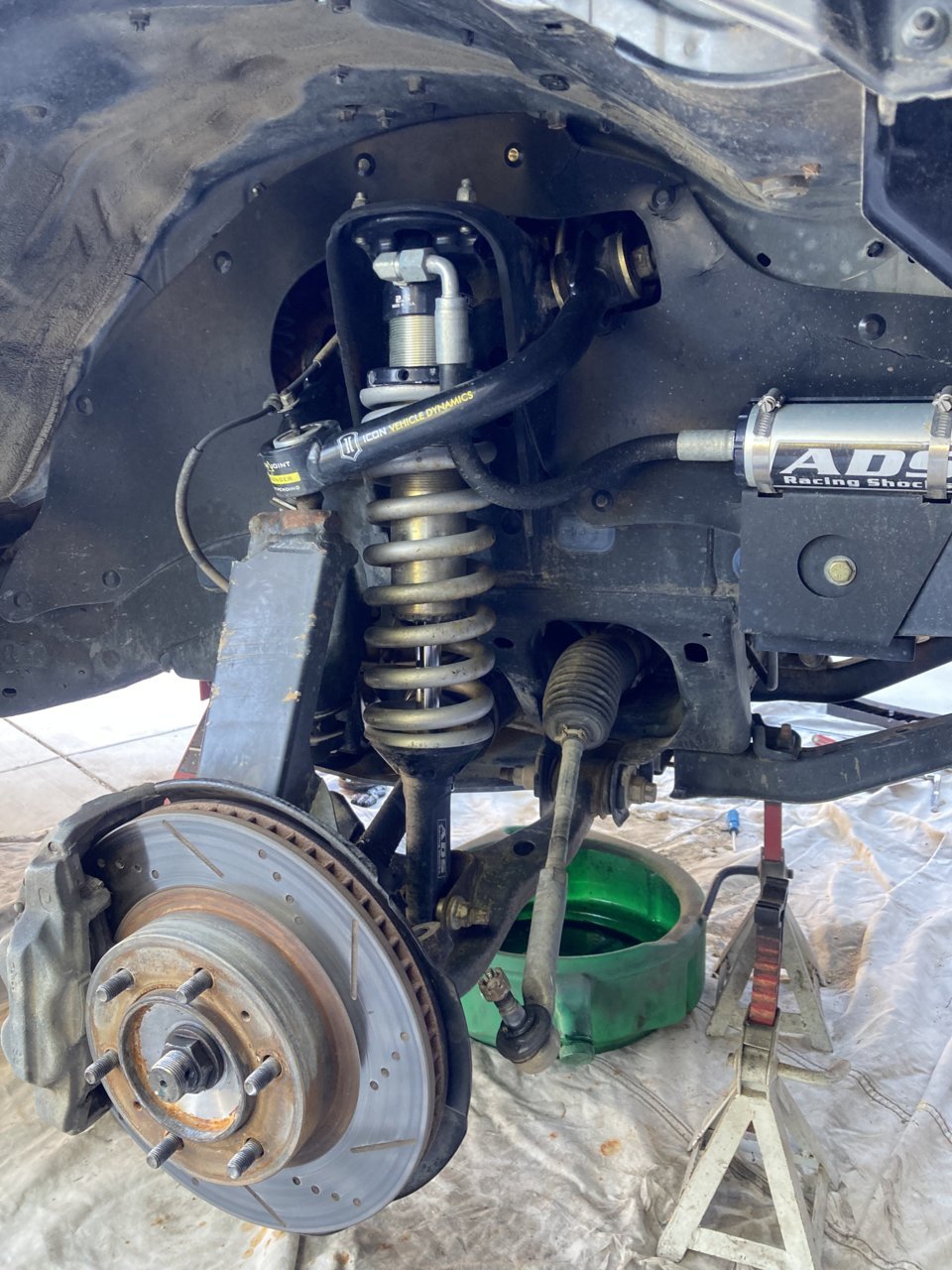

    Install straight forward. Camburg didn’t disappoint. LCA & UCA are stout. May need to lessen pre-load off of ADS ext travel coilovers.
    Waiting on alignment to truly assess ride.

    That’s awesome @bhova !! Can you post pictures of the install and issues you’re having with clearance? Mine arrive tomorrow!

    I know when Camburg quoted me for install, it included a ~1” fender trim to accommodate the +2” width.

    Had 2” trimmed off of fender and a CMC before install this weekend. After alignment and cab mount relocation, coilover may need adjustment for less preload. Just need to see how it all works together.

    Huge improvement in ride quality. The wider track width and sway bar removal softened up the ride noticeably. Haven’t thought of lessening pre-load since before an alignment was done.
    What size tire are you running or gonna run? Any changes planned for the rear?
    I’m gonna run spacers but need to swap out for longer studs.
