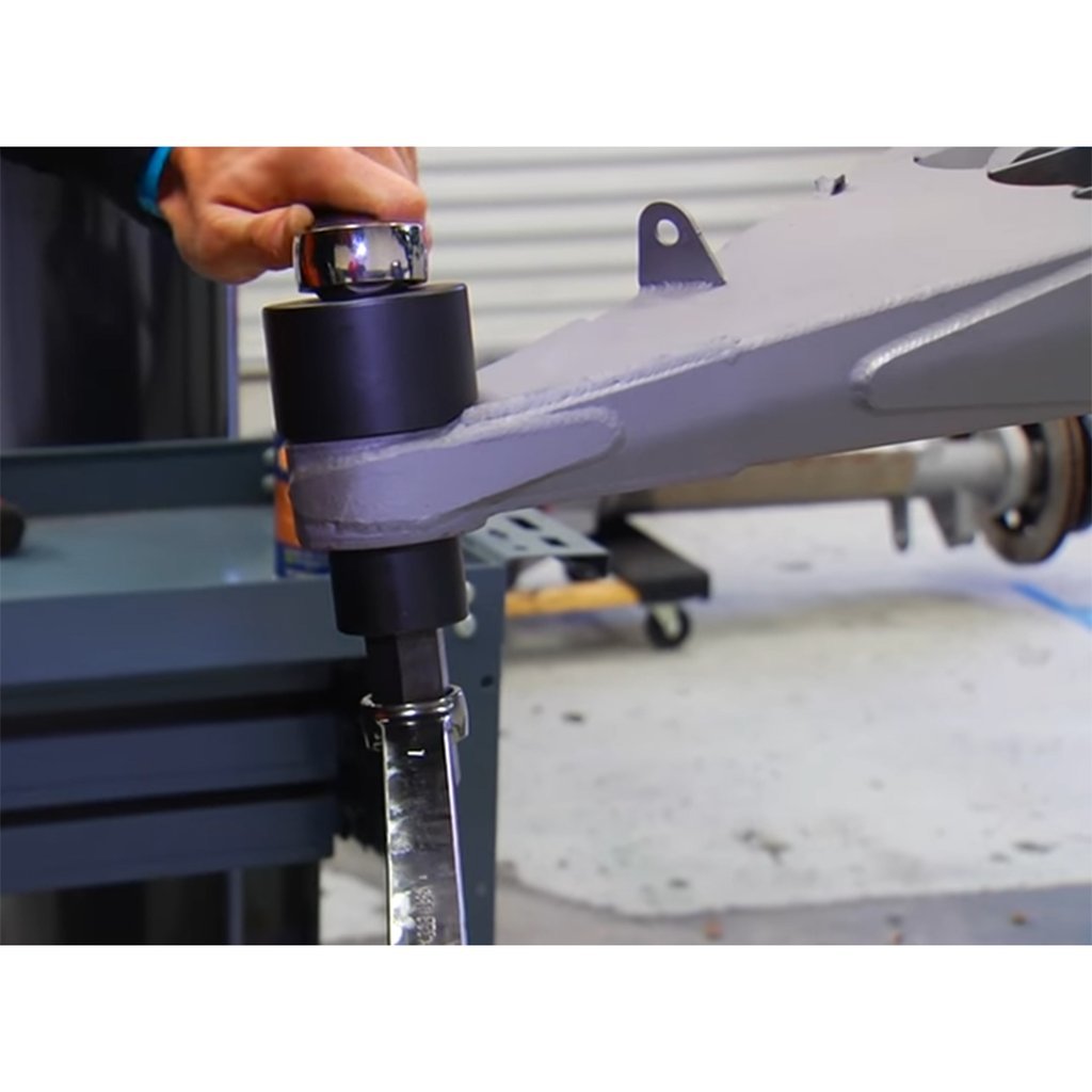

    Maybe its because a press is the wrong tool to use.
    Just a random picture I grabbed from the internet regarding uniball removal.

    I have the same UCA's and use the tool in the video (mine came from All German Motorsports). Came right out, very easy.
    A few thoughts for your mechanic, did he remove the snap ring that holds the uniball in the cup? And/or is he pressing it out the correct way? and pressing on the correct part (the outer sleeve) of the uniball and leaving room for it to fall out of the cup?

    I would 2nd what @JJ04TACO said. Verify the snap ring has been removed and pressing is in the correct direction.
    IIRC, the first time I changed mine they were hard. But they are also very dry. Since then, it has been much easier (3rd set now) since I use a little anti-seize between the outer bearing race and the cup.

    Wow, prices went up. I paid $150 from AGM several years ago. I don’t know of any other places that sell them. Maybe ICON?
    All I can say is the price I paid was worth the time saved. You can change the uniball without taking off the UCA. Takes about 20 minutes a side to replace. I ate the tool cost hoping I’d get 2-3 uses from it. Our 4Runner will get new UCAs eventually but they are 1.5” maybe 1.25”? I forget. So I’ll need the adapter for that size.
