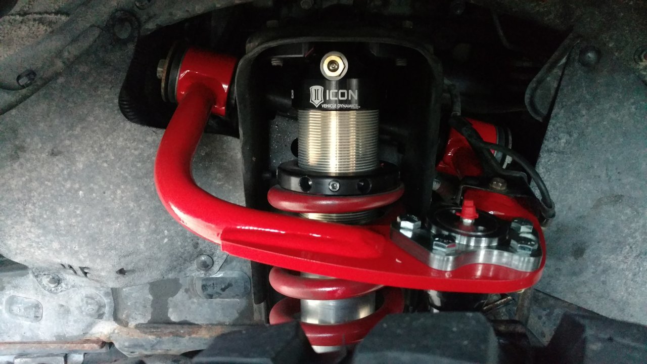

    I'm going to second this. Love my JBAs. They give you great travel and are significantly cheaper than TC. Not trying to bad mouth TC at all. I've heard they are great too. IMG_20170305_175027572.jpg

    It's a matter of opinion and choice so, no use arguing.
    It's a lazy, half assed, cheaped out design of a ball joint.
    And yes, rivets do a play role...IT'S THE ENTIRE REASON FOR THE 4 BOLTS. DERP.
    JBA could have used the same idea...and used only 2 bolts, some 12 or 14mm bolts. 1 per side of the BJ with the bolts being much beefier than the little bolts used.
    I think the JBA UCA is cheap personally. Weld a flat piece of metal between 2 tubes and slap a Chebby BJ on it. DONE! Blah.
