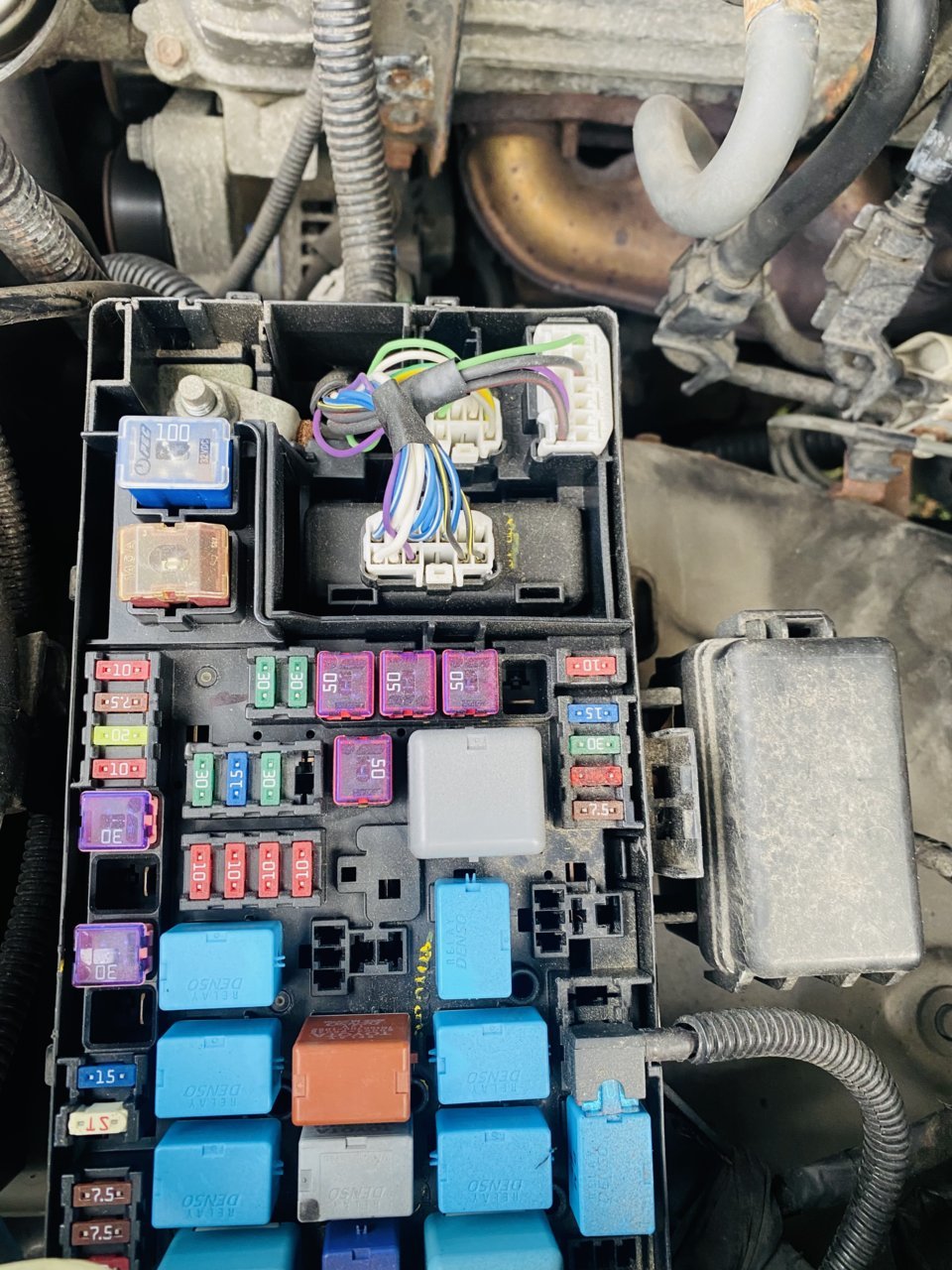

    OK I have some really good news. I found a loose fuse, apparently whoever installed the lights tapped into the EFI number two and it was loose as I had removed the fuel pump relay while I was away as a last resort if someone tried to take the truck.
    lights are gone but still rough idle. Finna go around the parking lot.

    Water in fuel isn't going to cause a problem in the 02 heater circuit. That's a faulty sensor or open/shorted circuit (the fuse falling out opens the circuit)
    Try cleaning the throttle body for the rough idle.

    A shop added lights a few years back that tapped into a fuse that got loose when I went to put back the EFI fuel relay.
    easy fix. Now I need to rewire and set up an auxiliary fuse box to avoid this in the future
