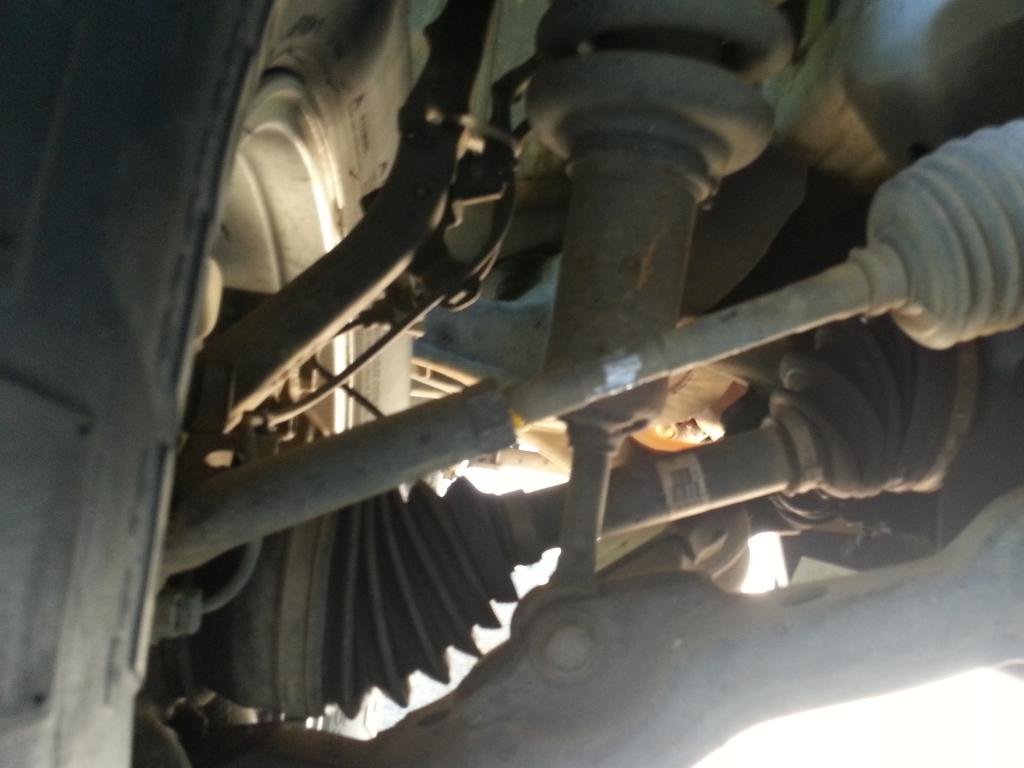

    I went to get an alignment, and after returning home, I noticed some oil on my driver's LCA. At first, I thought, "oh God, I didn't tighten the oil filter, or possibly the oil drain plug when I did my oil change last weekend!!" However, the filter area is dry. The plug was a bit greasy, but nothing on ground where I park. I had plenty of oil on the stick.

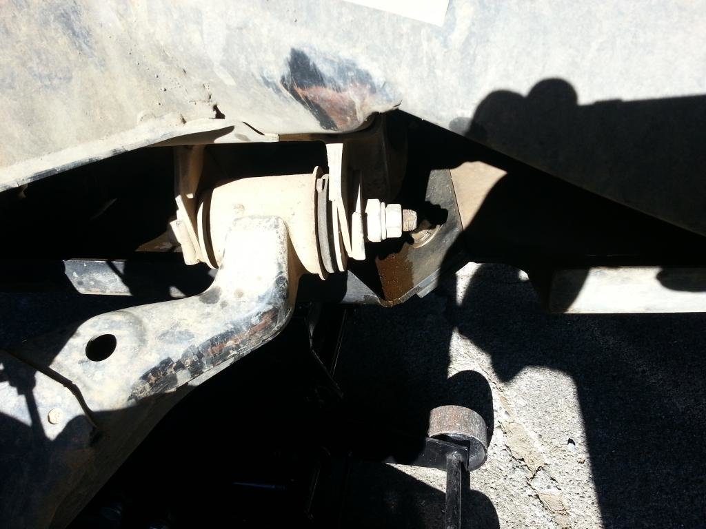

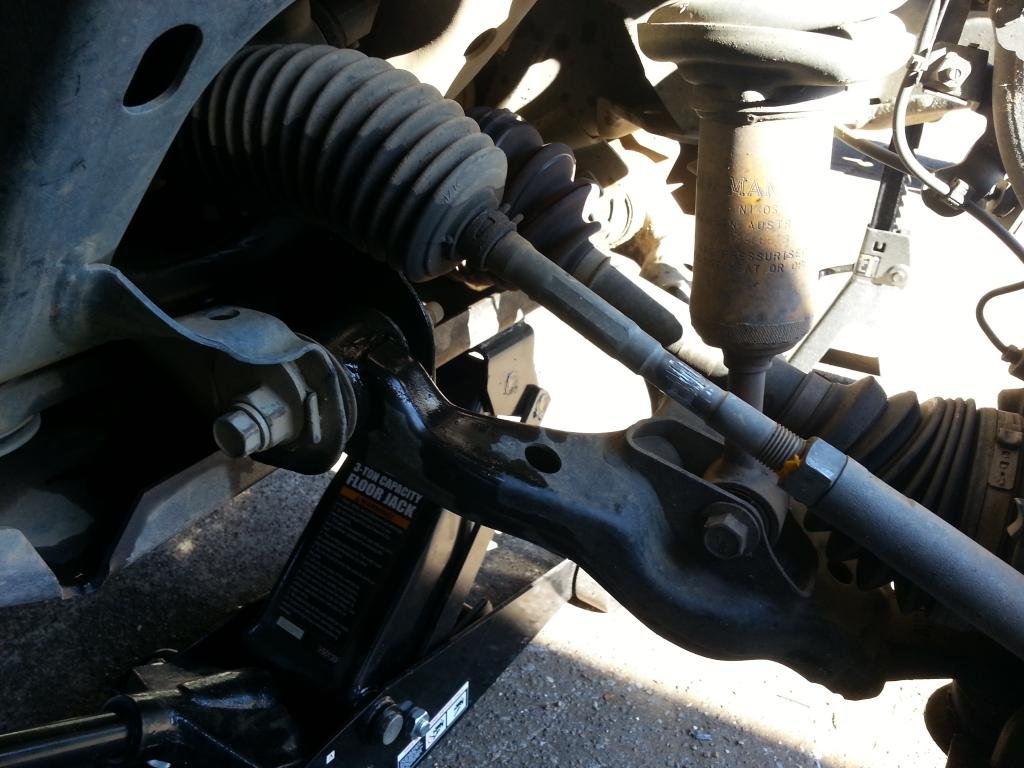

    I proceeded to pull off the tire, and found this. Notice the oil on the LCA, and how someone decided to get serious on the tie rods with a pipe wrench. The tie rod boot is dry.
    The oil drained back to the rear of the skid where it meets with the mid skid. I'm not as concerned about the mess, but that seems like a lot of oil/spray for whatever they needed.
    Passenger tie rod is the same, but everything is dry.
    I dont' see anything much else in terms of witness marks, either side. I did notice that they sprayed their yellow marking spray on both tie rods as seen above. There's some more yellow spray on the front side of the driver's camber bolt, but it looks old.
    So, what were they doing and do I need to be concerned?

    no they probably sprayed it with pb blaster to help break everything loose.
    i know thats what i do before a alignment

    ^This. The LCA cams are known to seize with rust. Truck is 5 years old in a northern state? I'm surprised more butchery wasn't needed to break them loose.

    I was more interested in the tie rods. Talked to the shop and they said I should maybe start looking at new ones because they were getting difficult to adjust.

    Pipe wrench. A lot of times it's what you have to use. No big deal.

    ^The shop should've gripped the wrench flats right next to it with a crow foot adapter and breaker bar. But what's done is done.

    Normal. I'm a professional and that's how you adjust a tie rod.

    It's an adjustable part on the underside of the truck subject to all sorts of conditions. They can be extremely hard to turn.
    When I do alignments one of my main tools is a 3 foot pipe just to break loose the nut if needed. Then I use slip joint pliers to adjust. I do it the same way on my truck.
    I've had to use a torch to brake loose tie rods before as well that doesn't leave things looking pretty either but if that's what it takes to get the job done
    The yellow marks are index points the tech used as reference probably to see how far he adjusted things others use it to prove to overly anal customers that yes we did do what we said we did.
