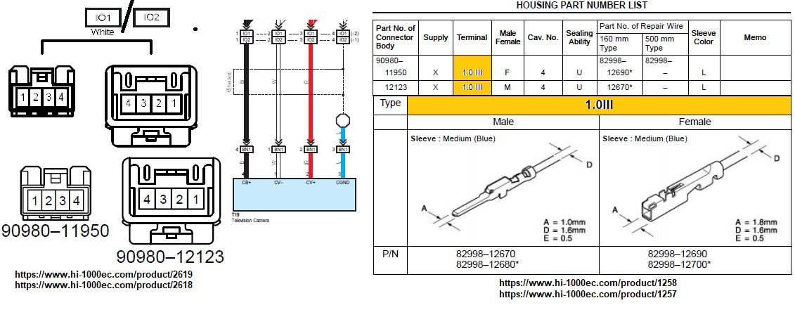

    Does anyone have a part number or know of a place to purchase these two connectors from. Any help would be greatly appreciated.

    Thank You most helpful
