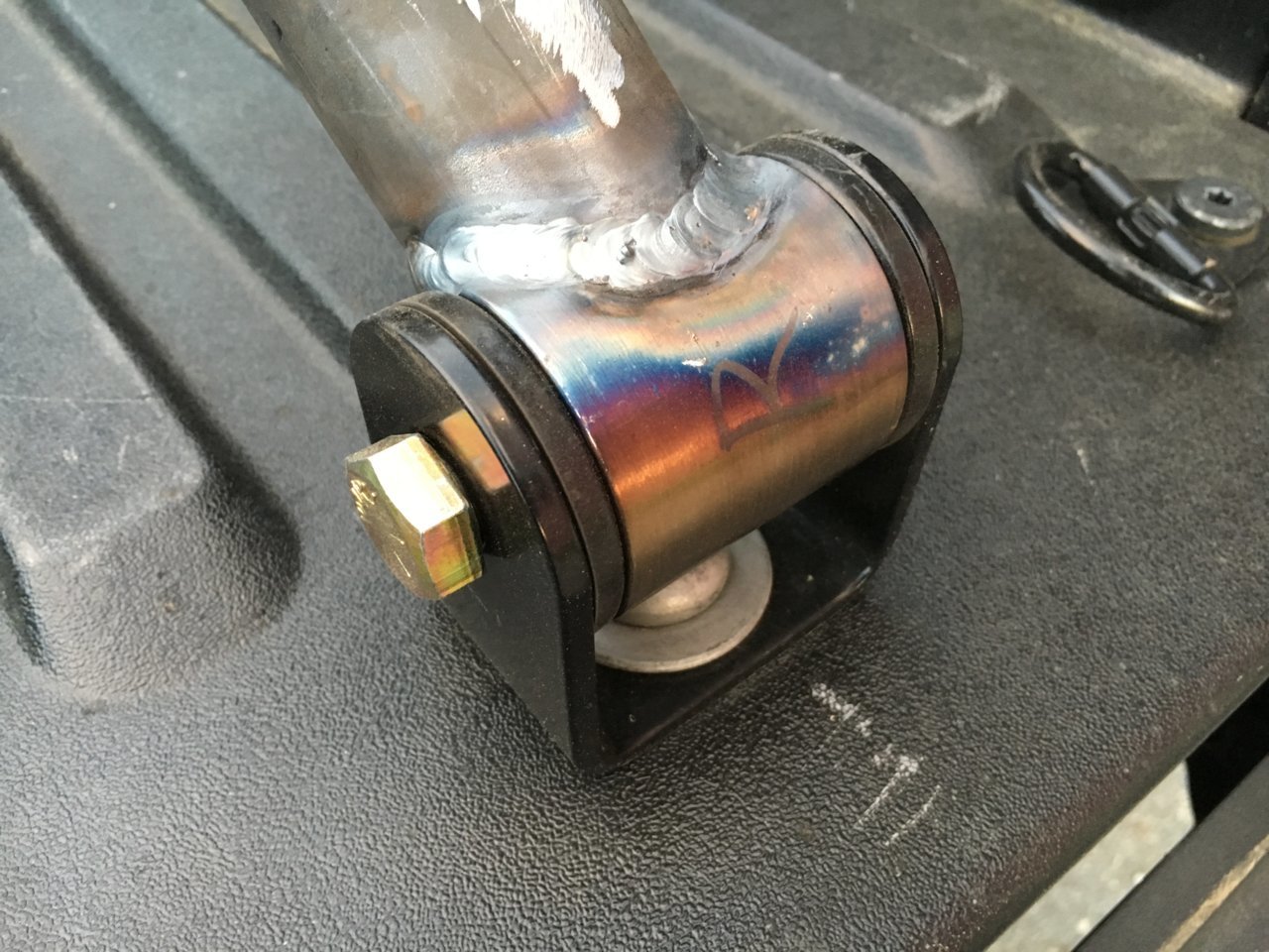

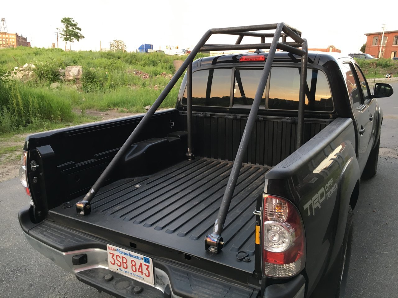

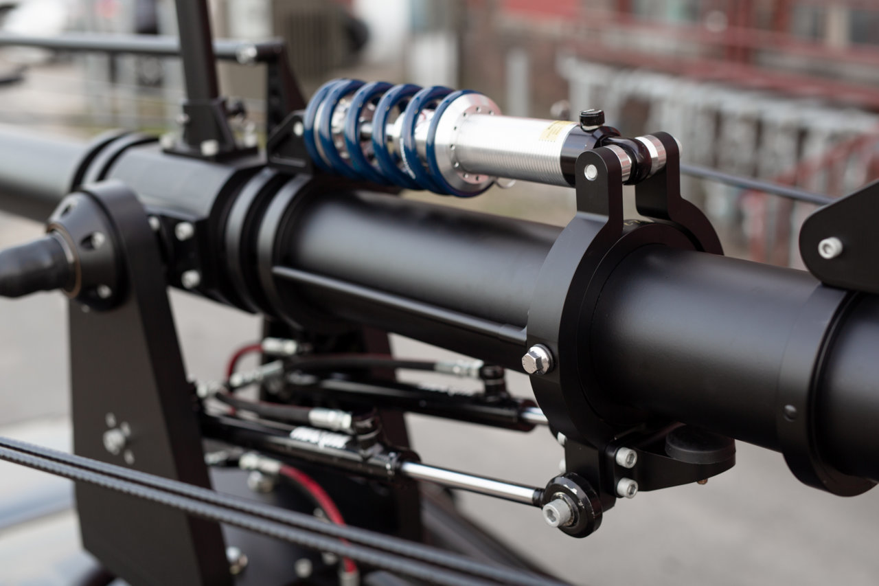

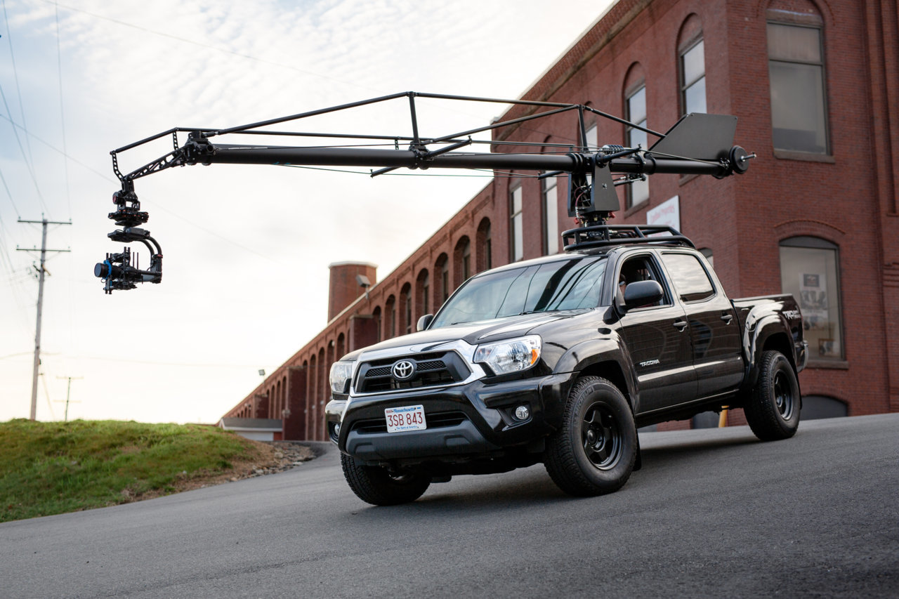

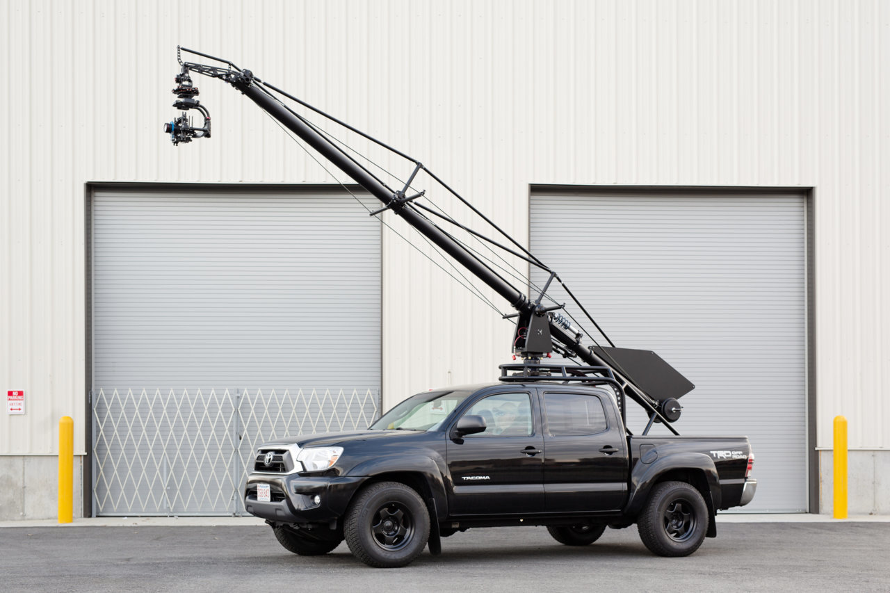

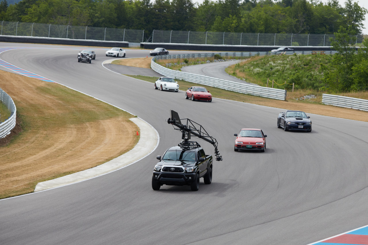

    Sure. I made brackets that attach through the front-most and rear-most bed bolts. That way it's tied directly to the frame of the truck. The tubular chassis itself is 1-3/4" DOM steel, same as you'd build a typical roll cage out of. Polyurethane bushings allow it a tiny bit of flex.
    Old pics here but clearly show the mounts.
    In full ready-to-shoot trim (camera payload, counterweights, hydraulics, etc.), anywhere between 300-500lbs.

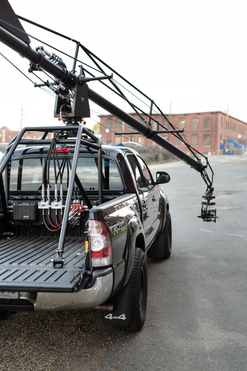

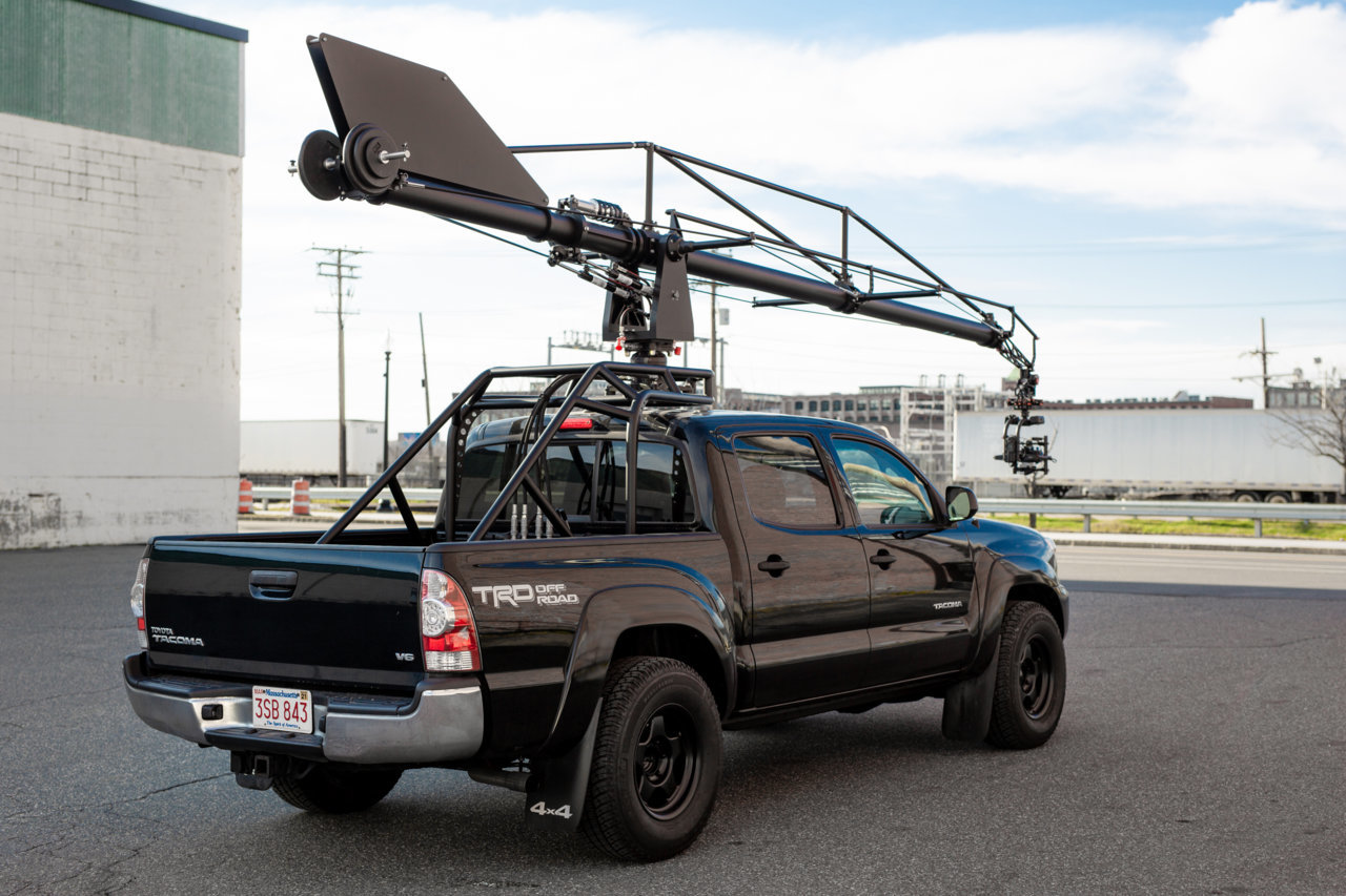

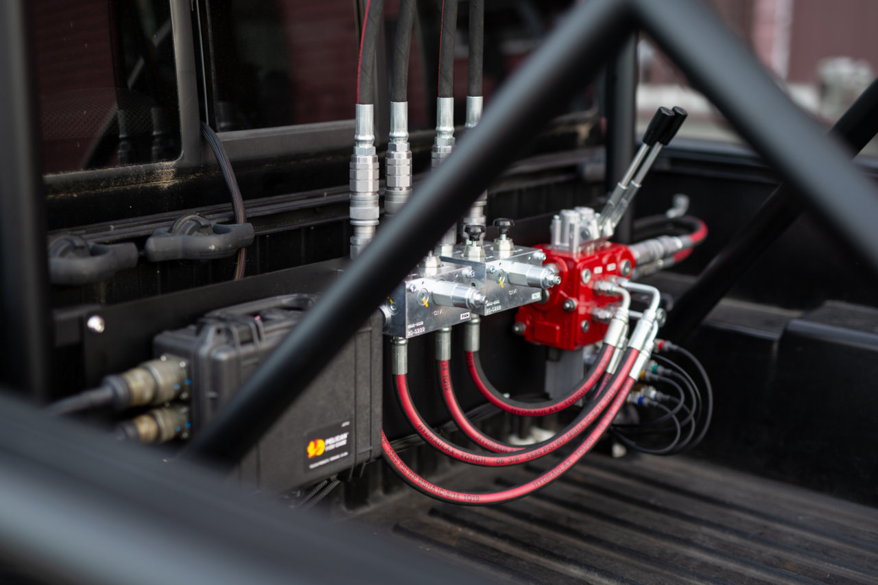

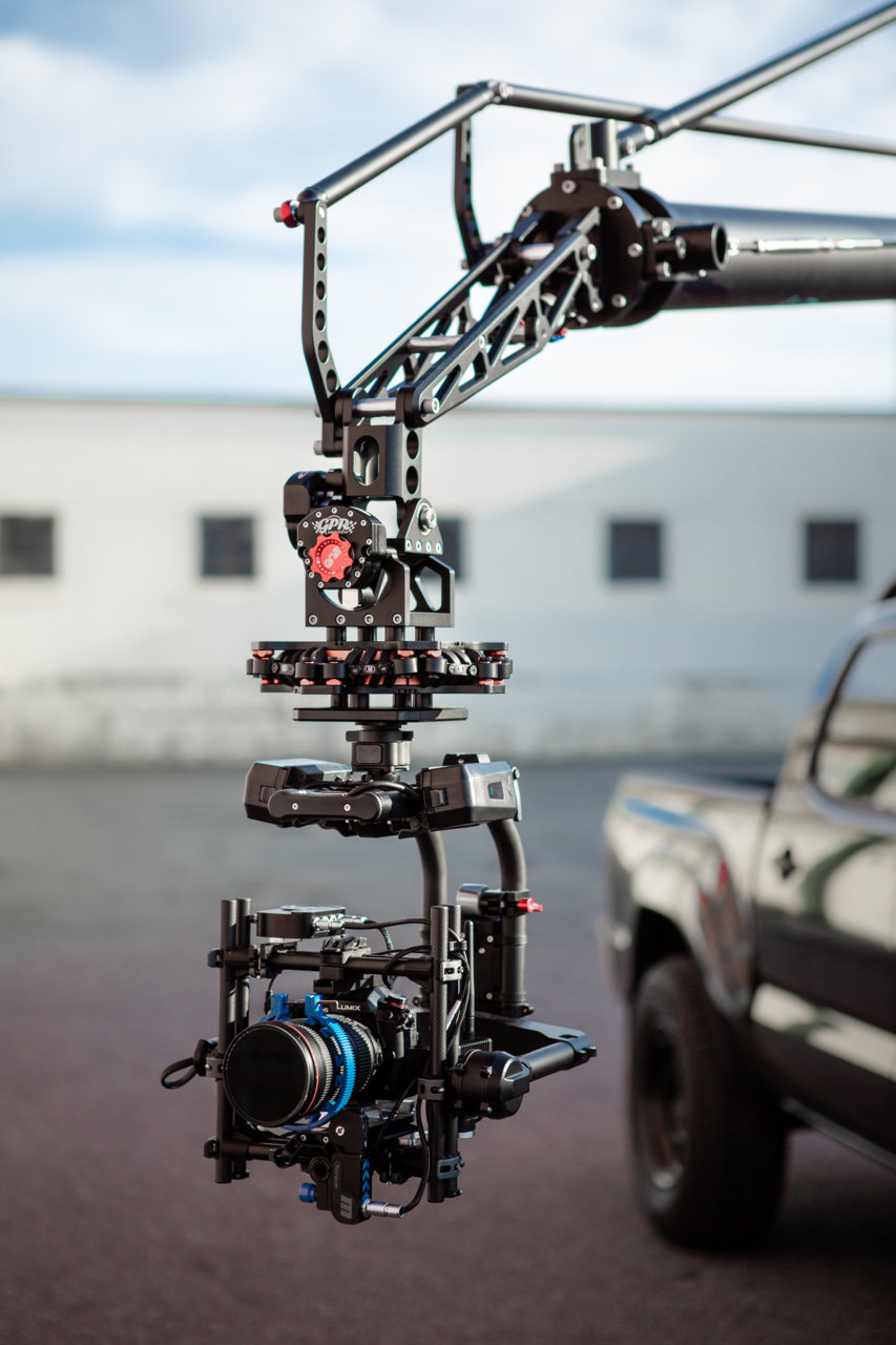

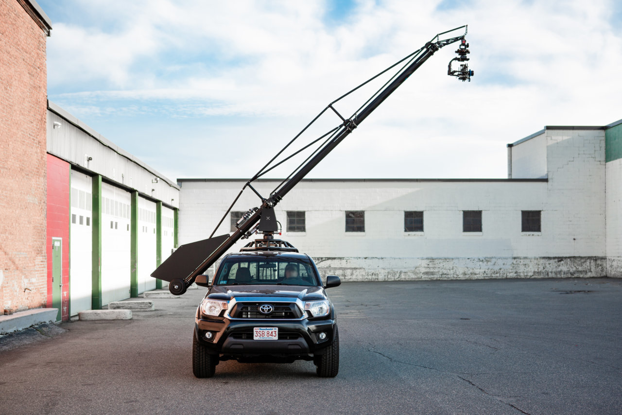

    The revamped electro-hydraulic system is working great. I also made a handful of other modifications and then powder coated everything. The crane truck can be considered 'done' for now (although everyone knows how that goes :D).
    Begone virus! I want to take this out on some shoots.

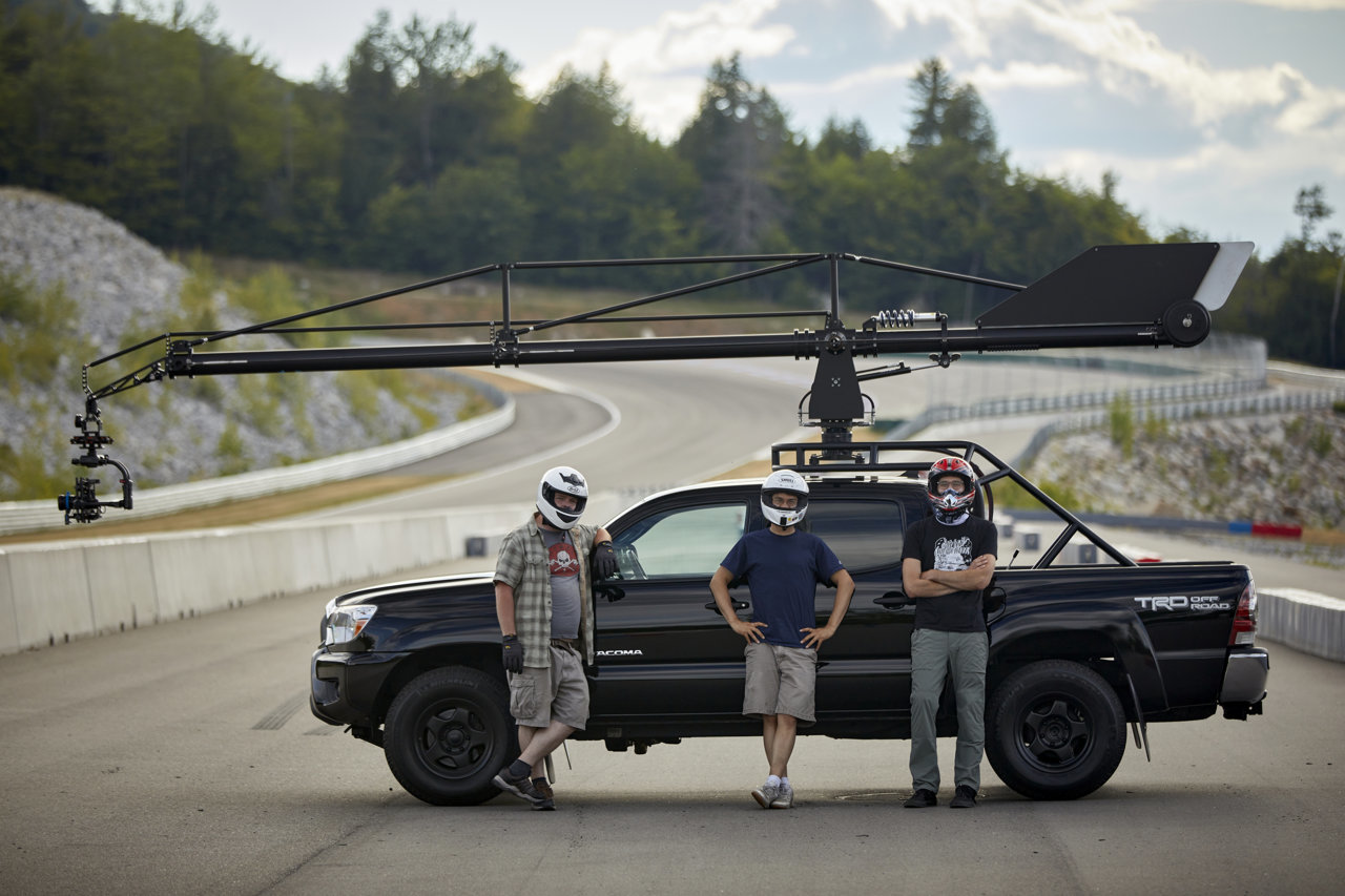

    We had a very successful track day with MassTuning at Club Motorsports in Tamworth, NH yesterday.

    Cool rig! Does this take a crew of 3 to operate? Driver, boom operator, camera operator?

    Yes sir, it's exactly as you guessed. Minimum crew of 3 - driver, crane op, and gimbal op.

    Sure, here's a little montage from the day:
    Tires are stock size which is 265.
    Shooting on the Panasonic GH5S. Didn't want an expensive camera and lens package on there in case I crashed it! :eek:
