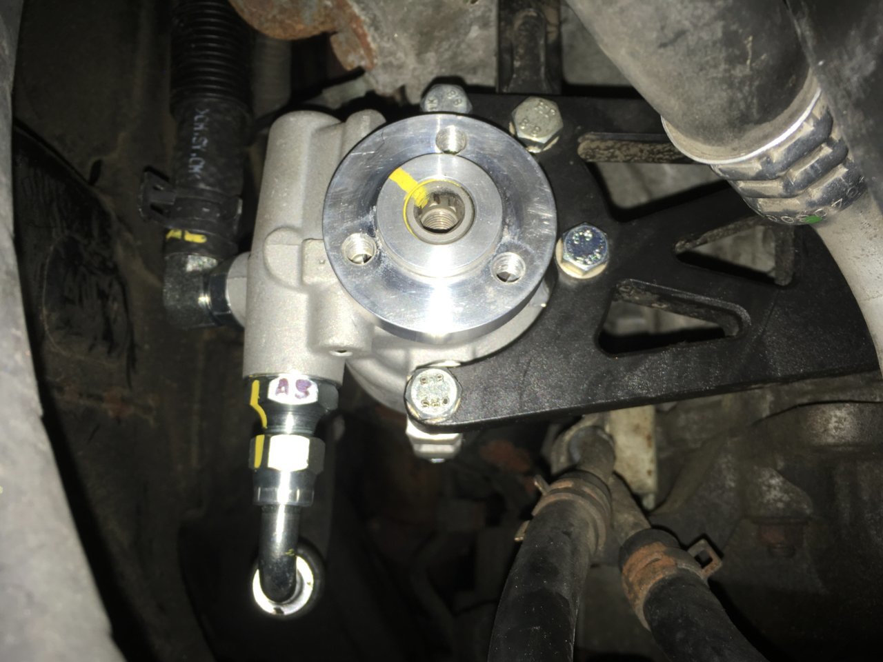

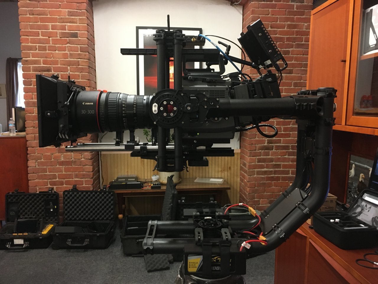

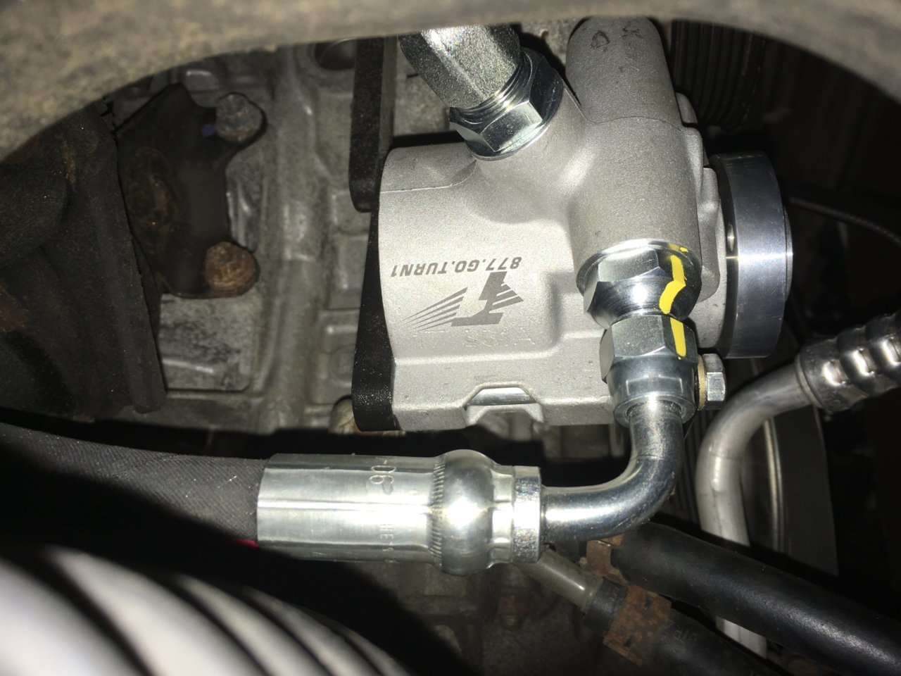

    Upgraded the pump (that powers the crane) to a higher pressure unit. 2000psi vs 1200psi of the first one. More pressure = more torque to move the arm against forces like high wind speed.
    Also, I'm prepping for a shoot this Thursday and we're gonna run a pretty heavy camera package. 45lbs! It will put the crane and gimbal to the test.

    Digging the paint marks on the hydraulic fitting.

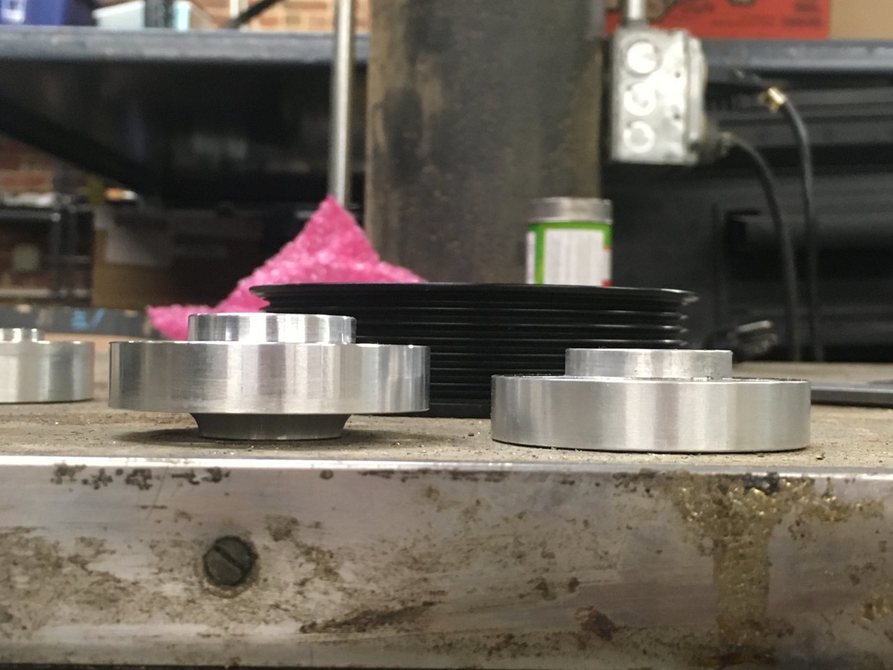

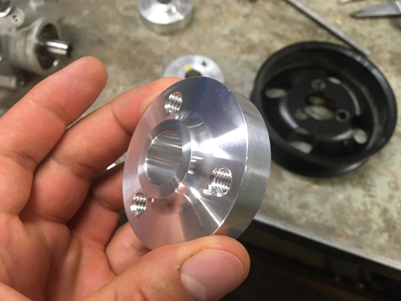

    Gotta have em! In fact, thanks to the paint marks, when I started testing the new pump, I noticed the pulley adapter was ever so slightly slipping on the pump shaft. No good. So I machined a new one that's a couple tenths tighter on the bore as well as being longer (more surface area to grip the shaft). Been holding strong since.
