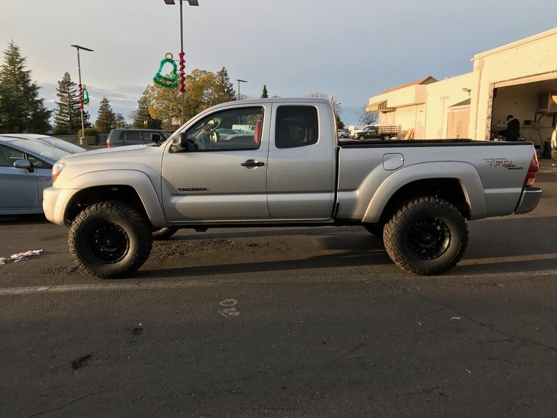

    So. Toyota is taking about $4000 of my money saved up for this, due to my tranny and clutch going out, and other little things.
    Therefor in about 2-3 months I will be purchasing the LT kit.
    From here on out, it's all about learning more and preparing myself more. I want this truck built right, not cheap.
    This will be an overland/prerunner rig, so if anyone has any ideas please tell me! I'm open to anything as of now I don't have my mind set on anything...yet:thumbsup:
    IMG_7140.jpg Here's how my truck sits now. Just realized I haven't posted a pic yet.. :D
