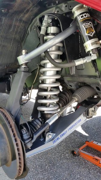

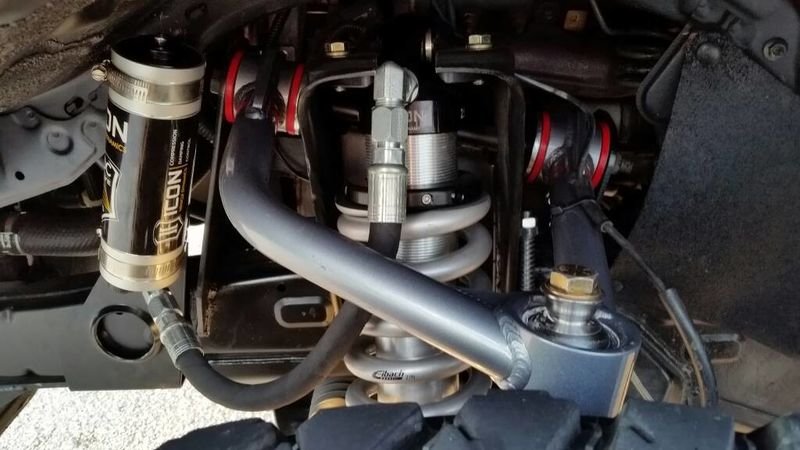

    Man I'm interested. As I'm still learning... what exactly is the purpose of a CDC valve? Do you have pics of them?
  8. Nov 26, 2016 at 3:02 PM
    #68
    jberry813
    Jan 21, 2011
    #49636
    28,477
    Jason
    Lake Tahoe
    2012 DCSB Sport
    ...too much shit to list.
    CDC valve is a valve in the resi that restricts oil passing through the adjuster orifice. It basically allows you to simplistically tune the shocks. Driving around town you turn it low and crank it up for when you are beating on it.

    Those look damn nice! I'll definitely get back to you..

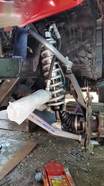

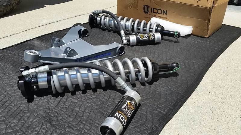

    Resi mounting brackets included too.
