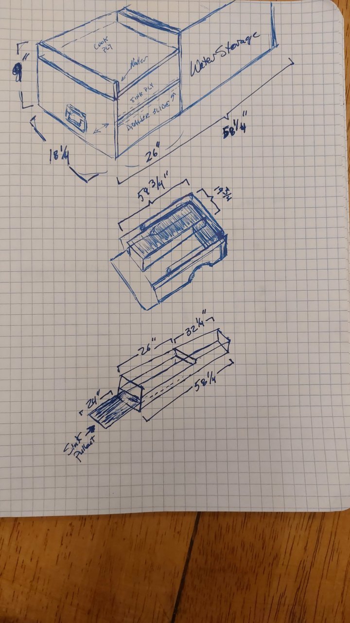

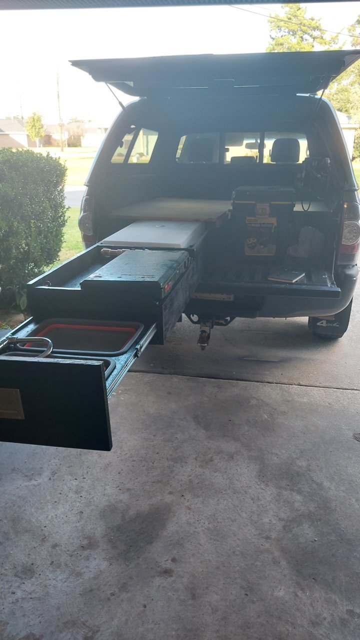

    Today I finished adding a camp kitchen to my 2 gen tacoma. It's nothing glamorous, but I'm pretty stoked.

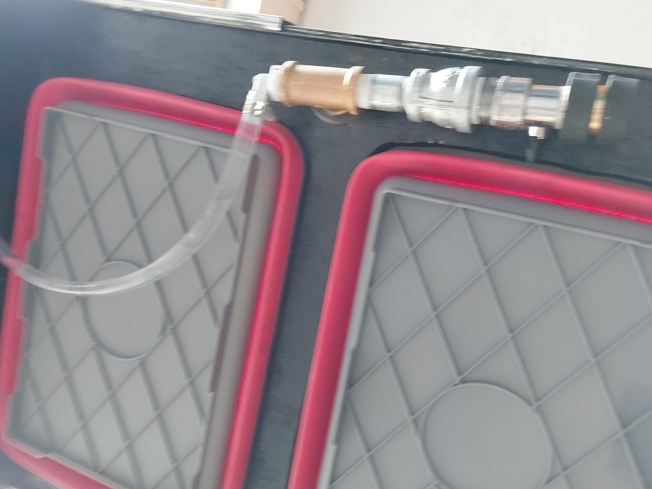

    I bought an on demand pump from northern tool, and sinks, rv faucet , and 15 gallon water storage tank from Amazon. Plumbing supplies from homedepot.
    Not shown in video: quick connect hose hookup for shower/clean-up located under sink drawer.
    Woop woop. Now I just need time time to go camping/fishing.

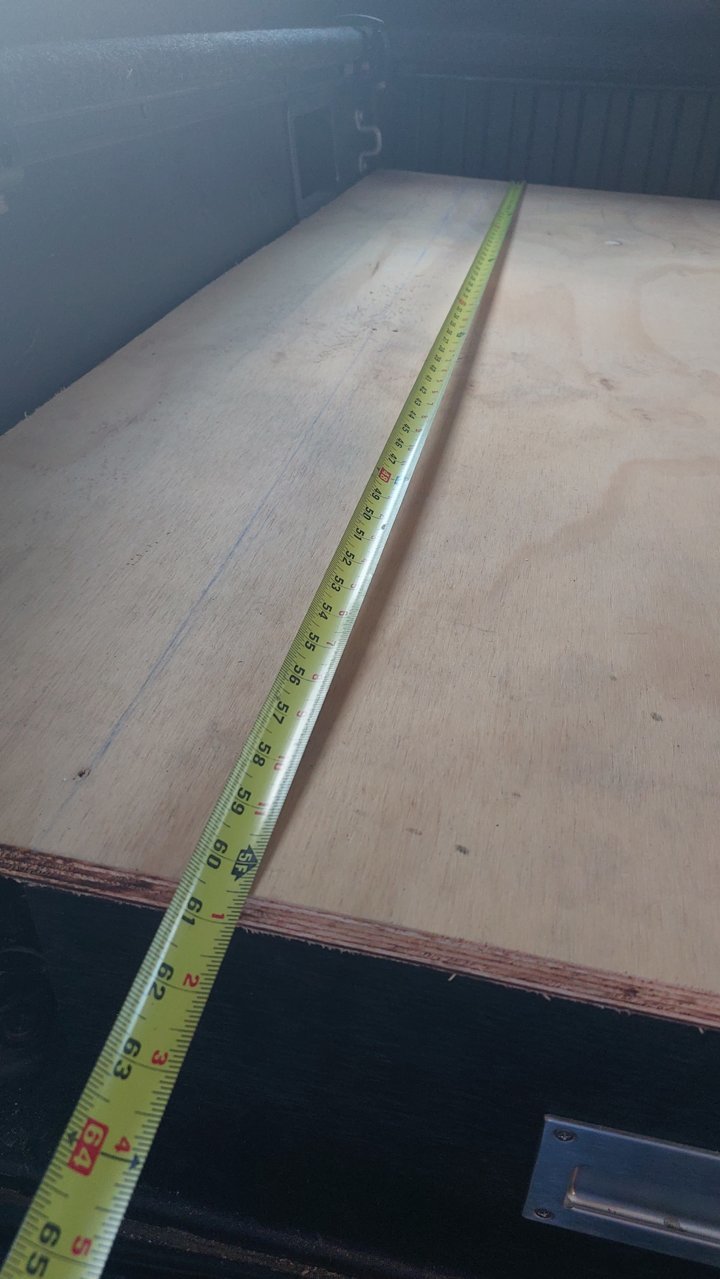

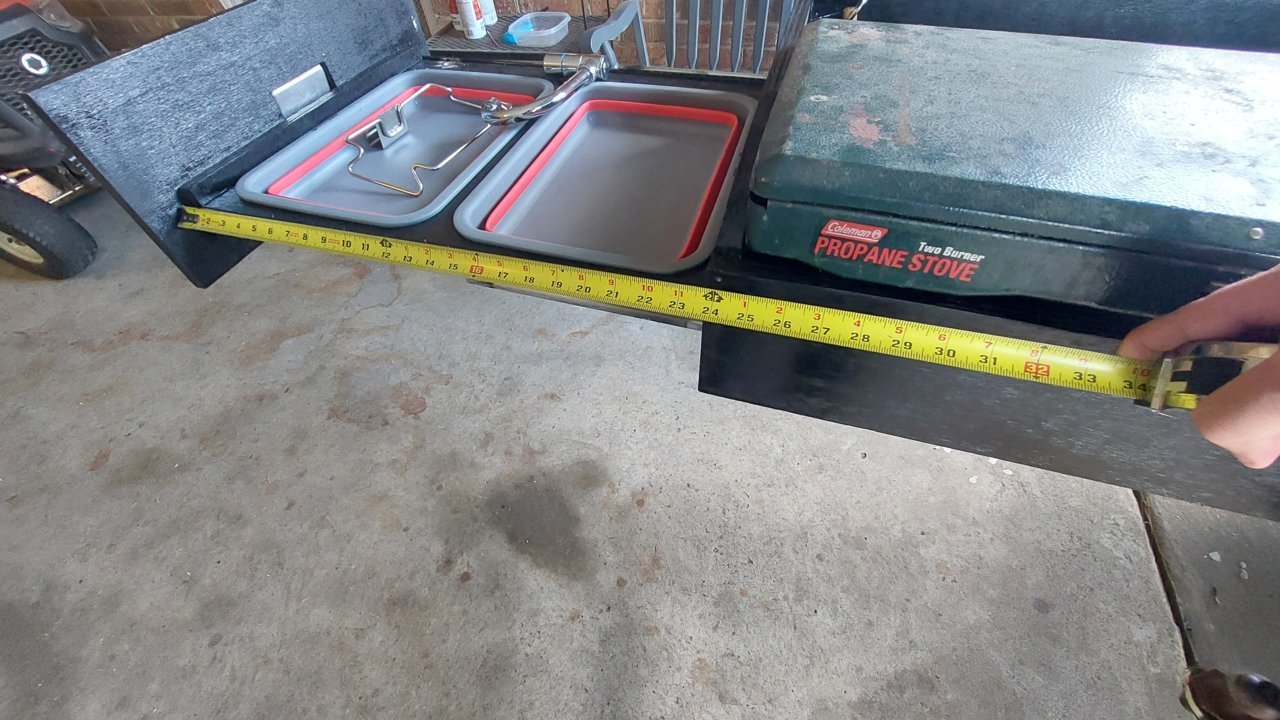

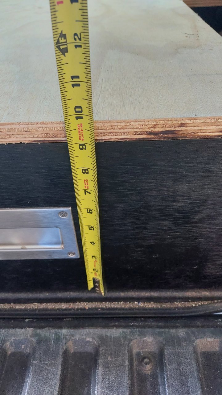

    Aw shucks, thanks. I'll try to get better pics and description posted tomorrow. It was fairly simple construction though. The hardest part was having room enough for the faucet and plumbing. Clearances are tight considering there's only 9 or 10 inches between the height of the bed and the height of the wheel well.
    I didn't use drawer slides for the main drawer. Only the sink pullout. Those are 24" cushion close drawer slides from Home Depot. $20~
    Check out youtube for others systems. Lots of folks have made similar. Youtube gave me the spark, and I drew my own idea out on graph paper, adjusting as I went.
    My guiding principles were: cheap, simple, functional, fast (to build snd deploy).Tempting to make it more complicated than it needed to be.
    I used plywood I already had. I wanted it to fit the camp stove I already had. And other supplies were pretty inexpensive, too. With unlimited time, it'd been nice to make it prettier. All in all Im pleased :)

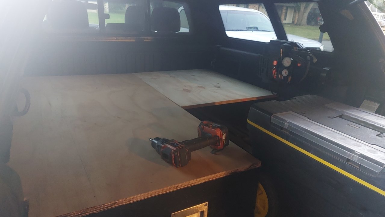

    Right now it's not anchored. Just the weight of the deck keeps the drawer up level when the water tank is empty.
    When the tank has water in it, it's even more of a balast. The portion of the drawer with the tank in it never needs to extend past the tail gate. So, more than half the drawer is still on the truck.
    When the sink slides out, it's a little more than 50/50, but the sink pullout is light and the back of the drawer and deck are heavier. It all stays put pretty well. I dropped another sheet of ply on the passenger side to complete the bed, and it keeps the drawer from trying to walk away from the wall while driving.
    I planned on adding a couple cleats along the driver's side and against the cab that will mount to the stock track, and hold the deck down tight using friction. So far, they haven't been needed. Off road, bouncing around more, I think I might want them. (Remains to be seen. It's pretty tight with the gate closed)
    You could anchor everything more permanently, but I'm really trying to keep it simple/easily removable.
