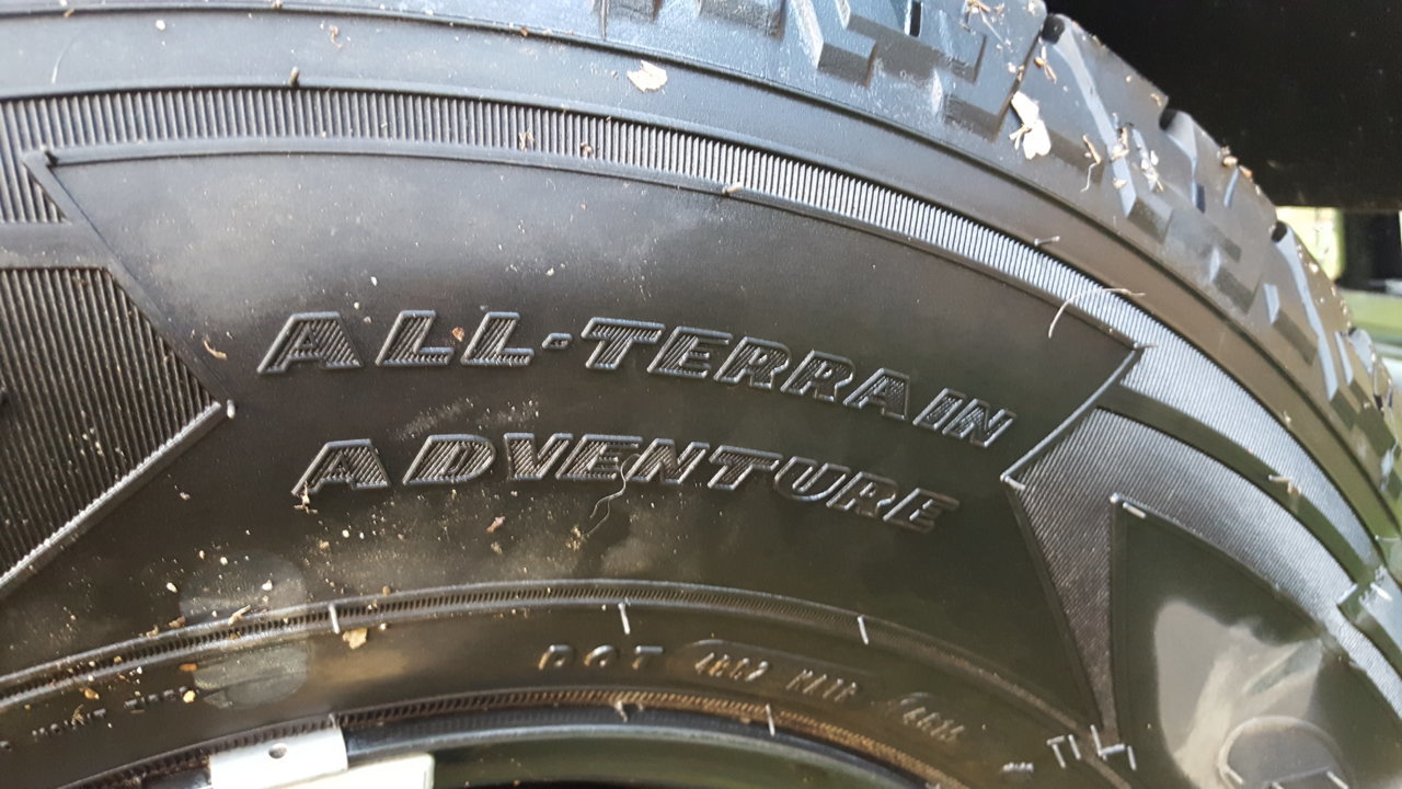

    So I rounded up some factory Tacoma steel spares the past couple weeks, and they seem to be perfect for these hubs. The lugs centered the wheel up quite nicely! Will have a test report next week.

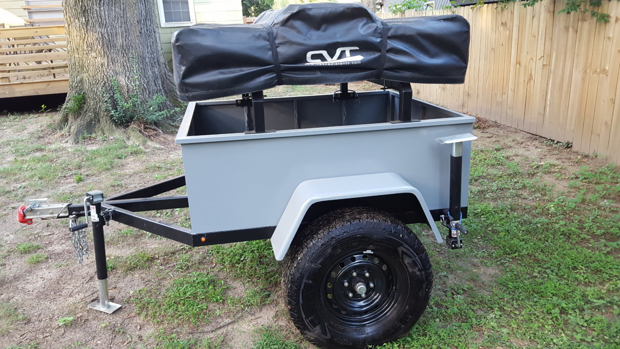

    Absolutely! I have about $1500 in materials in this, I bought drops when could to save having lots of extra tube. It came out a little heavier than I would have liked, but I erred on the side of overbuilt and ease of welding. The frame is 11ga (.120" wall tube) and the calculated weight is just under 600lbs.
    Next one I would like to make lighter.

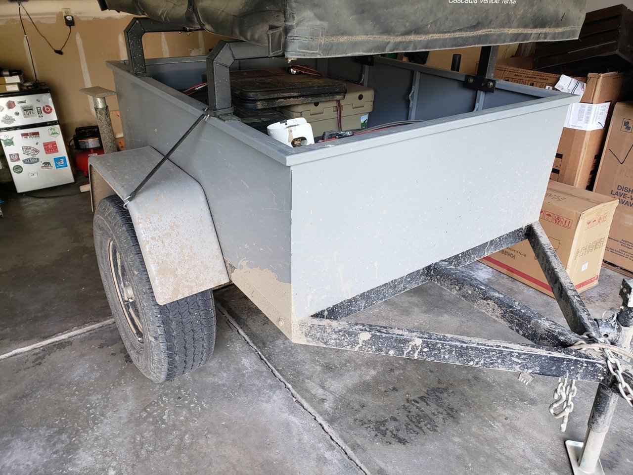

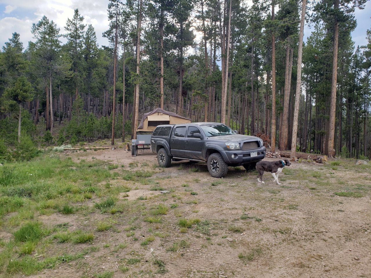

    We did make it out with the trailer! First proper offroad trip and the fenders nearly came all the way off LOL. Overall, it was awesome and served us very well the times we did use it. Getting the dog up and down was tricky sometimes. We ended up on an ATV trail (whoops) and it pulled just fine through everything, but I wouldn't want to make it a regular thing.
    We sold it during the pandemic to make some room for other toys. Thinking about a wedge camper as it will be much easier with the dog, but really have no solid ideas.

    So it got some time on a pretty rough trail. It bounced a lot. I think probably because it was still oversprung. Shocks may have helped it settle down?
    SummitBound[QUOTED] likes this.
