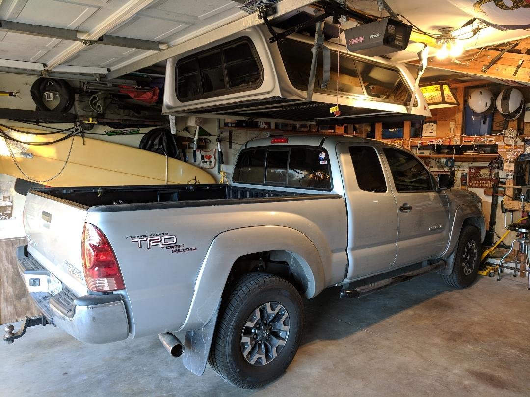

    This worked for me. My topper has the built in rails. I can ratchet it down more to store it higher. Best part is I can take it off and on by myself.

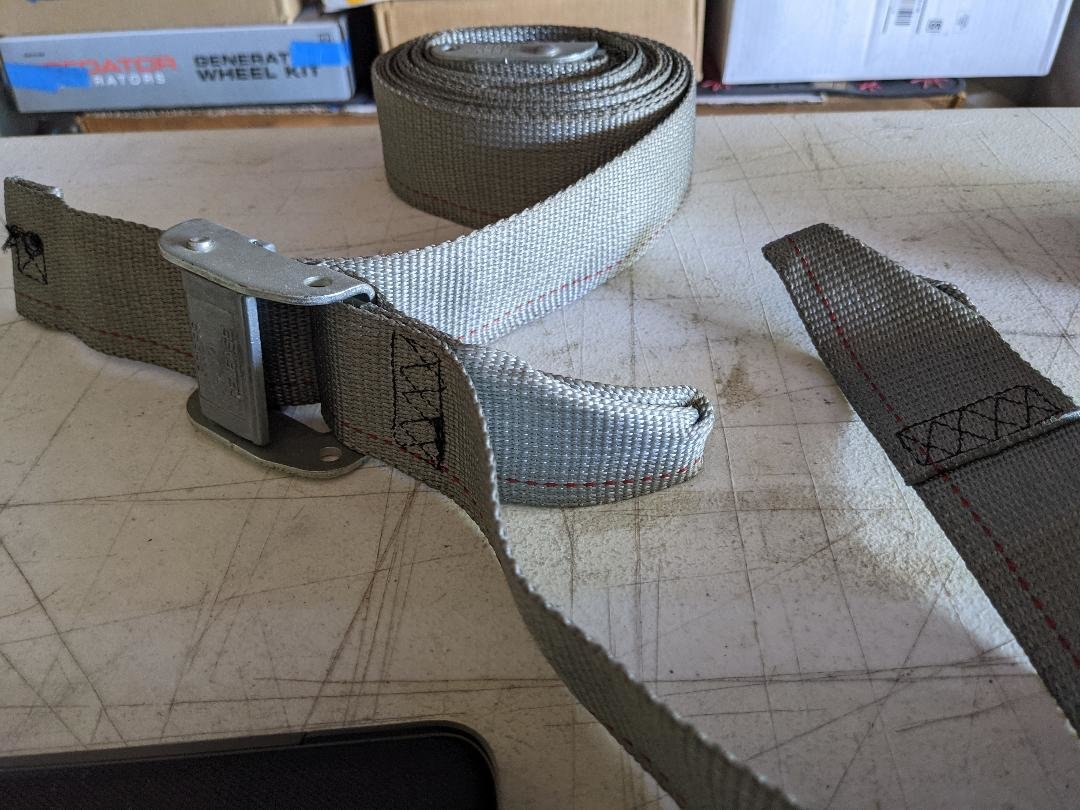

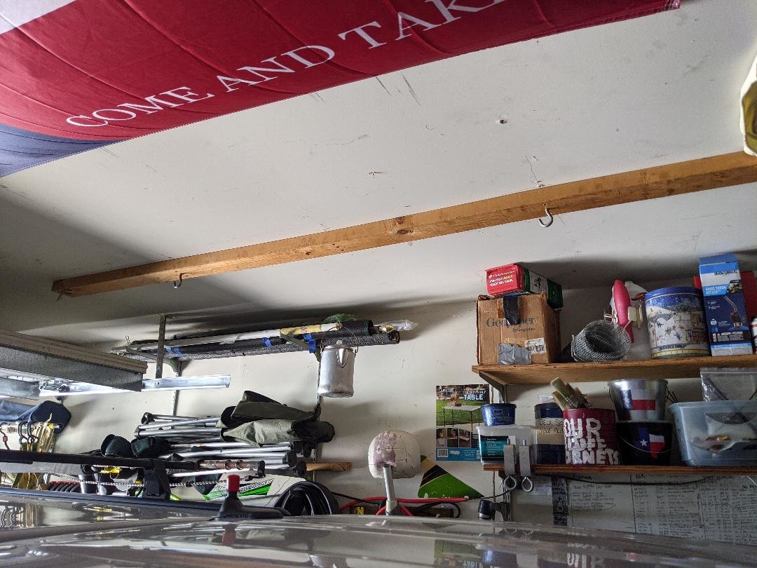

    I purchased mine from JC Whitney more that 25 years ago and it's still working great. A simple design that consists 2 - 2" webbing straps maybe 20' in lenght. Each strap has 2 camlock type buckle on each end that is used to sinch the cap up and then to lower. Each camlock buckle has a "tail" with 2 loops used for attachment points. One short, one longer so you have a choice on how much ceiling clearance you want. I use the short loop to lift the cap until it barely touches the ceiling in my garage. I'm not a big fan of camlock style straps so I tie a safety knot that will prevent the webbing from slipping through the cam. I've searched for the same system several times, but cannot find anything that even comes close.
    BTW- I'm 66 and able to take off and put the cap back on without too much trouble. I use my legs to lift the cap (one end at a time) and place a 2x4 (4) to hold the cap off the bedrails. I then slip the webbing under the cap on each end and slowly lift the cap going from one side to the other and from one end to the other. The process is then reversed to lower the cap back onto the 2x4, remove the straps, use my legs to lift the cap to remove the 4-2x4 blocks and final adjustment or placement of the cap on the bedrails.

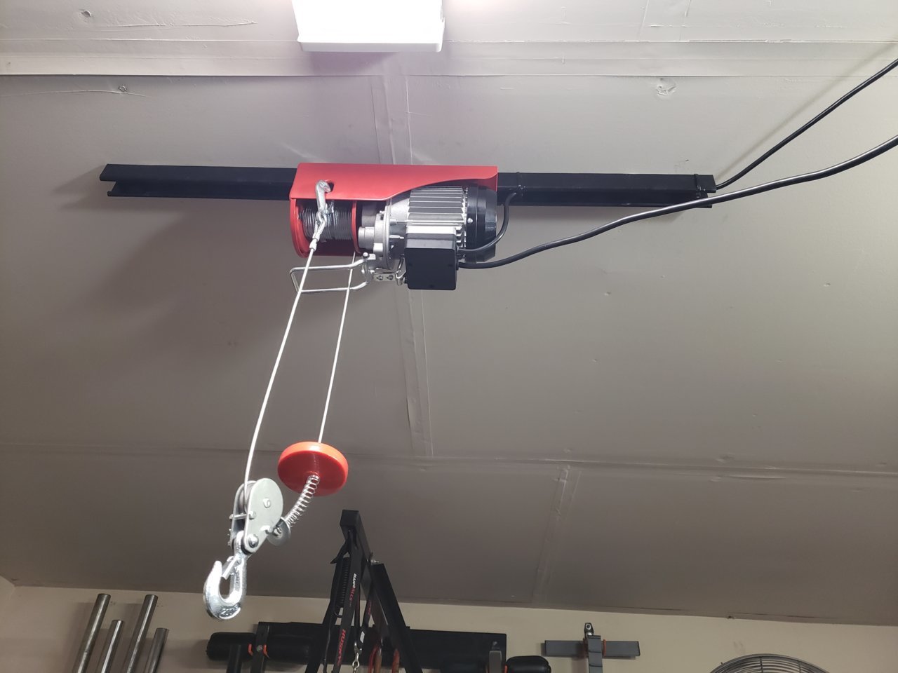

    I bought a cheap electric hoist from harbor freight and attached it the ceiling to help unload my bedrack. I use it to load/unload any heavy load in the truck bed. Handles up to 440lbs.

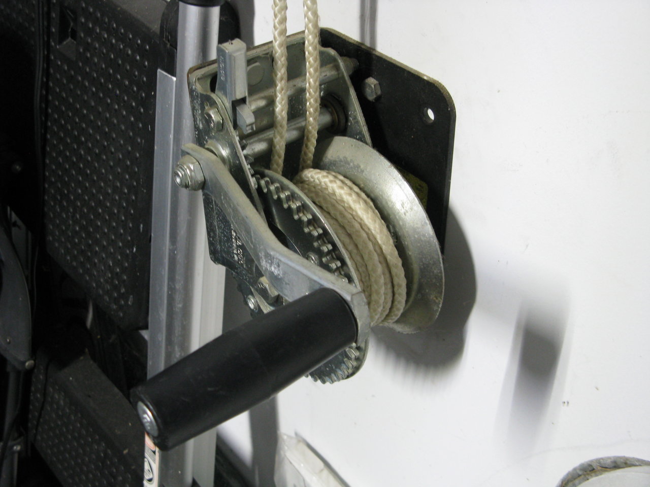

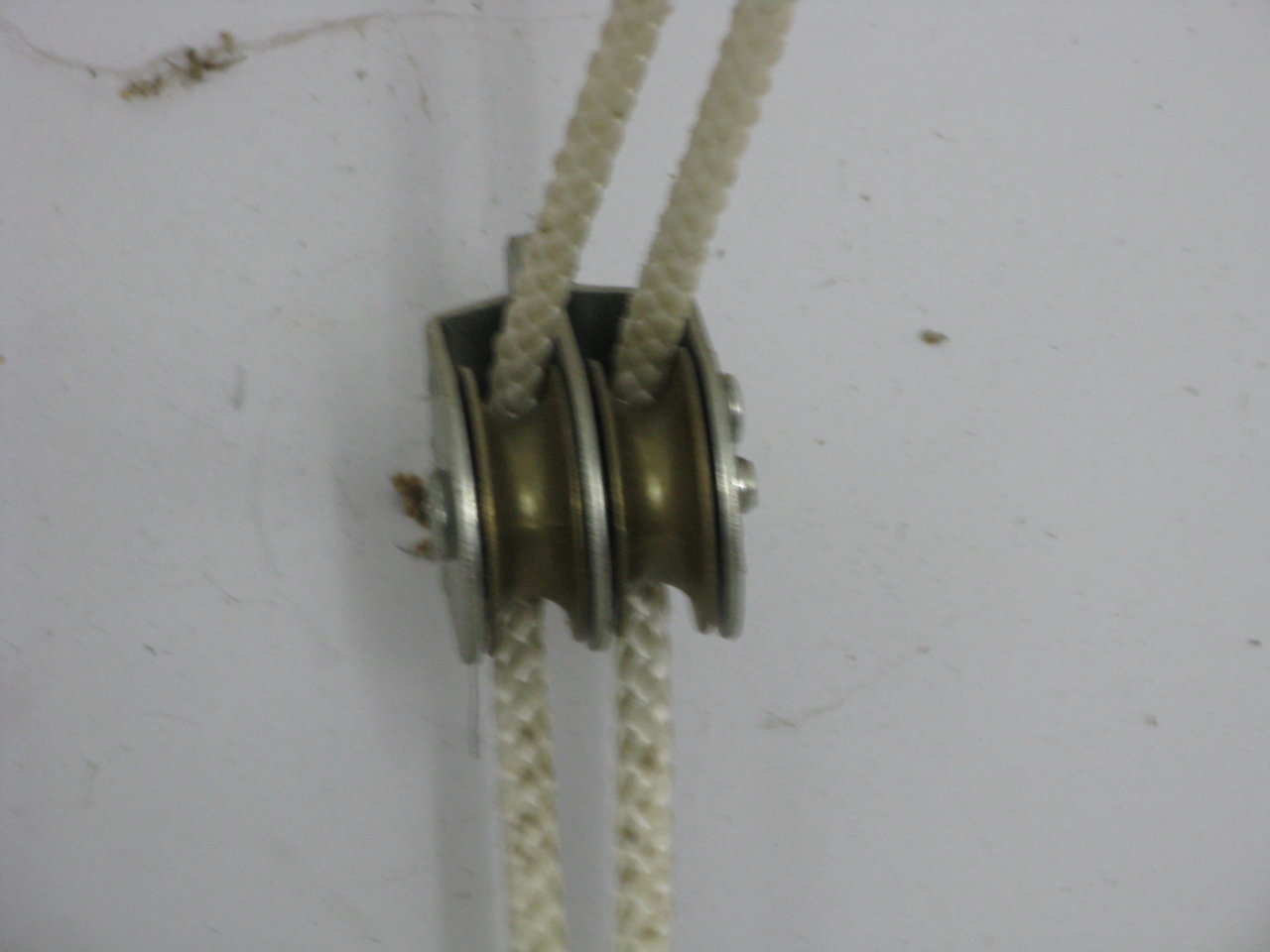

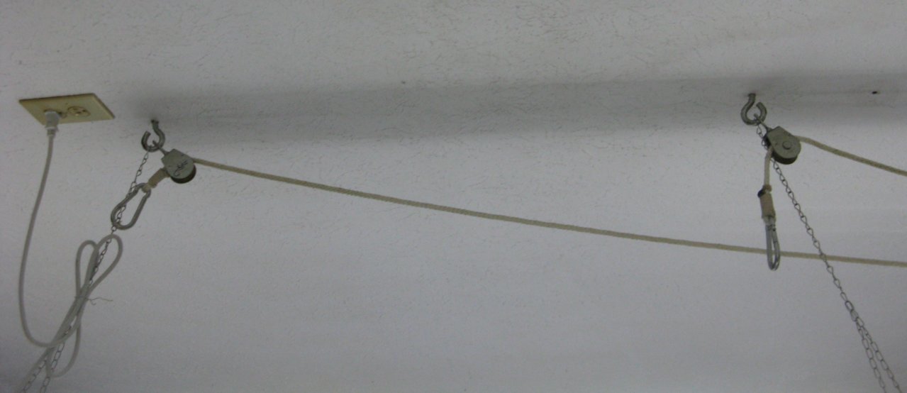

    I installed a boat winch on the garage wall. Ran two nylon lines around the spool. The lines run up the garage wall to a double pulley, secured to a wall stud by an eye bolt. The lines then run to pulleys in the ceiling attached to studs by eye bolts. The setup easily supported the hard top on my Jeep and allowed me to R&R by myself. I used ratchet straps to lift the top routed through the spring clips on the end of the winch lines.

    I've seen where my Leer can weigh between 180 to 200. With mine being lined, I thinking closer to 200. The system I use, each strap states 125 lbs max. With two straps I figure I'm good.
    Checking the Hoister, it also has two straps so the weight is split and IMO would handle your. The motor may be what limits the weight. If I had more ceiling height, I'd be looking at one myself.

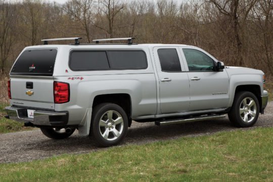

  16. Jul 30, 2021 at 5:41 AM
    #16
    Marshall R
    Marshall R Well-Known Member
    May 28, 2015
    #156224
    4,800
    Marshall
    07 White TRD double cab
    none
    Cap
    Camper
    Travel Trailer
