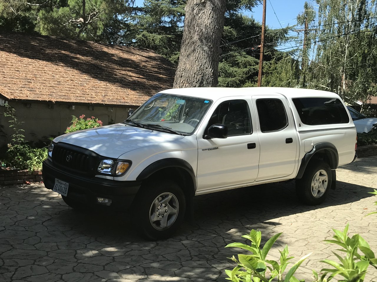

    I have the slowest, povert spec, first gen on this site
    Mine is a 4 door, DLX, 2.7L 4cyl Taliban edition with a gimpomatic
    3 cylinder Geo metro and first gen prius laugh at me as they dust me at lights
    That said, I have a camper to make it even slower and I am perfectly happy with it waving at VW bugs waving by at me uphill as they pass me and 18 wheelers snickering at me
    My slow tacoma, like aarp sex in Florida nursing homes is slow and steady, without need for additional enhancements, SC or blue pills
    Without camper, my taco would easily spin rear tires. With camper, not so much
