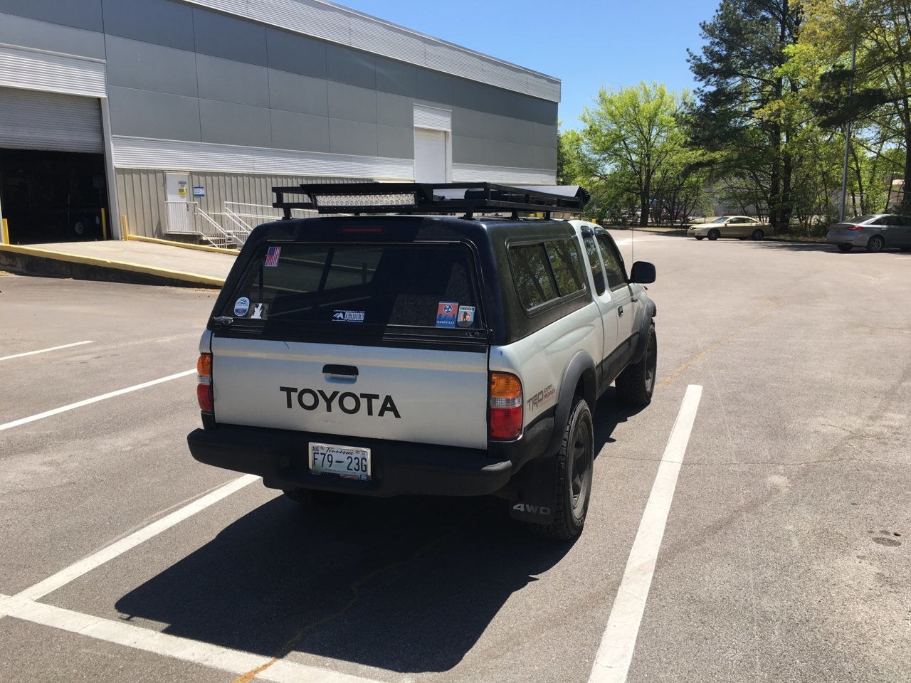

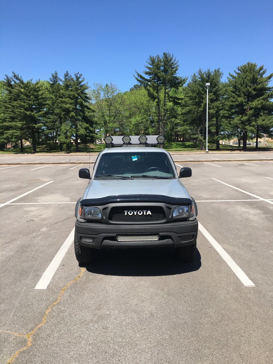

    Well... finally got it mounted up today. Looks sick in person. There are a few minor things that I want to change, mostly just come up with a better fastener system on the inside of the roof. I have plates and rubber before the washer and locknut which I believe is perfectly fine, I still want to find a better system, that doesn’t bug the engineer in me. One thing I didn’t anticipate-it actually rides better. I didn’t think it would add that much weight, but it’s just enough to improve the ride and cornering. I’m pulling the trigger on an OME setup in the coming months, the front is getting done in 2ish weeks and the back probably 2 after that. I’m hoping it improves the ride even more. I also definetly need to lift it an inch or two, I'm going with 883s in anticipation of a bumper, so that should solve that problem. I can’t speak to the lights yet, I’ll wire those up after schools out but I’m sure they’re gonna be bright as all get out.
    Overall, it was a sweet build. Definetly some things I’d do different if I did it again, but nothing that makes it a terrible job or anything that I have to change now. Supper happy that I have exactly what I want out of it!

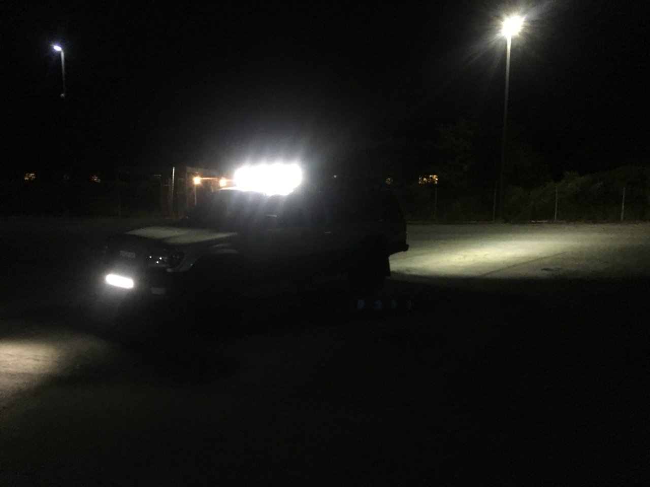

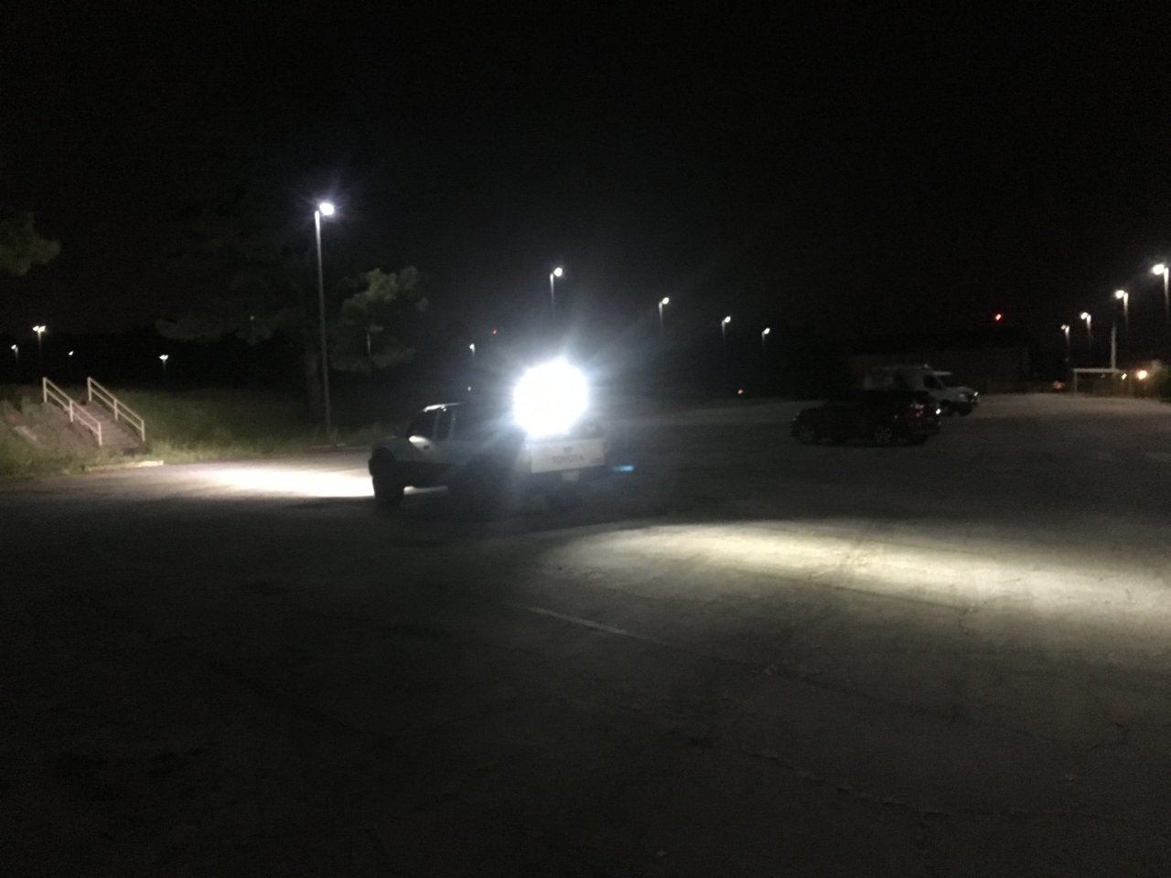

    Thought I should finally update this thread... my lights have been wired for a while, just never got around to taking pictures, but this morning was an early workday and so here they are!IMG_2297.jpgIMG_2295.jpg
