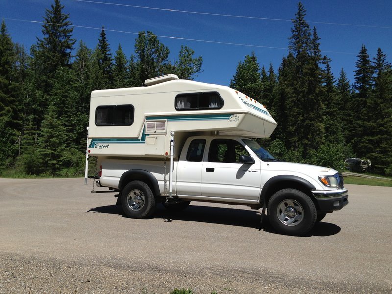

    I would second the Timbrens. Easy to install, much cheaper than most airbags, and they work very well. Check out the pic below (my camper is about 1000lbs or so).

    5

    That looks pretty good, how does it like hauling it? I've toyed with the idea of doing this, although I don't think they make a camper that'll fit in a short bed unfortunately. If that's the case, it's just another excuse to buy me another Taco just for camping purposes! :D

    Timbrens - that's it. However, the owner before me had redone the leaf springs and rear shocks. That would certainly add to the 'lack' of sag as well.
    It drives very well for the weight - I just take it easy and things are fairly predictable. When I looked at the Timbrens (with camper on) they were just resting on the axle/leaf spring (so about 1-2" sag). Haven't had the Taco/camper off of asphalt yet. I have the 6'2'' (74") bed, so there's a small bit of overhang onto the tail gate. I think there are some campers out there that would fit a short bed, that would also be light enough for a Taco.
