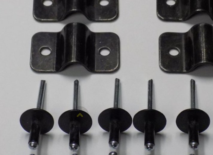

    So his pics of the interior show the closest to the cab bracket at an angle. Guessing one of the rivets popped on it. The brackets sit in this orientation -

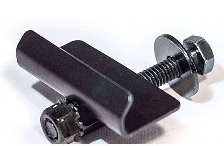

    The hooks to use are these. Might be hard to locate and go easy on torque to avoid damage to the bed rail lip.
    In a pinch, might be able to get away with using multiple (maybe 3 per side to be safe) good ol' fashion c-clamps to get it home.
