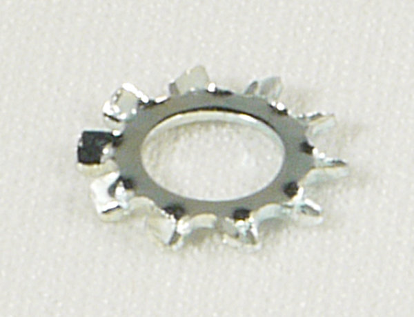

    Crappy ground, or, overloading the circuit. I'd double check the ground for the rear harness, and if possible add a good one with a snowflake washer under the connector.
    Snowflakes are good things in some circumstances. LMAO
