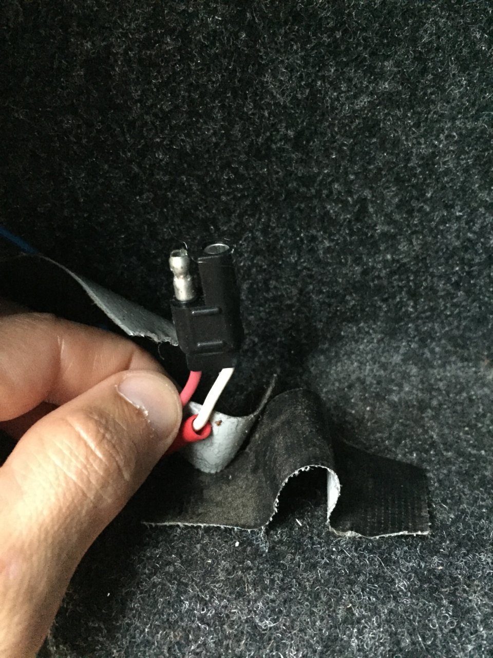

    I’m not doing this on a 1st gen, but I’m presented with the same scenario as you. Bought a used topper that has a two pronged quick connect already installed in the topper for the third brake light. I’ve been trying to determine what I need to connect the toppers two pronge harness to the truck. I’d like to retain the quick connect/disconnect capability.
    Looks like the battery tender harness might work for me too.
    This is what I have in the shell...
    1CADDC38-4529-48F3-B0C4-5C802F6F97FB.jpg 0ABFA771-C06F-4C60-83CF-FE5013503D58.jpg
