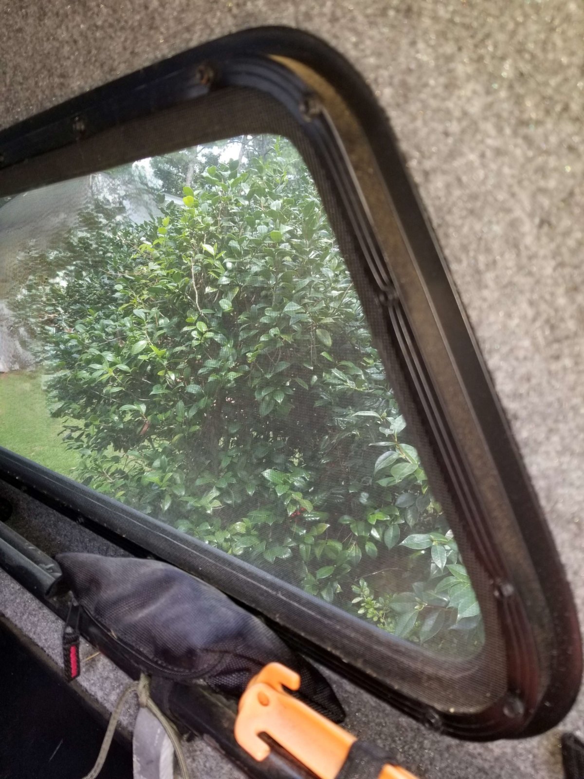

    Ugh, not sure why it didn't focus. Anyways, mine is an ARE but most of the aluminum framed windows are similar. You can kind of see how there is a frame screwed onto the interior side and there is a track under it that the screen is pressed into. If you have frameless windows I'm not sure what it looks like inside, there are several styles. The ARE pet screens are typically just secured using the screws that hold that trim piece on so removing the trim piece should expose where the screen goes. Be careful with the screws as they're typically just cheap sheet metal screws screwed into aluminum, you don't want to spin them out or overtighten them when reinstalling them.
    The junk under the window is for an awning.

    Good info bajatacoma thank you

    Hopefully that helps. I think you're just going to have to look at what you have and it'll probably be pretty easy to figure it out from there. Just make sure that if you do unscrew the windows that it can't fall out- the companies seem to think these things are made out of gold and charge accordingly, if you can even find the right replacement.
