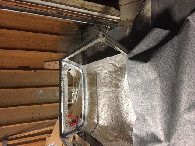

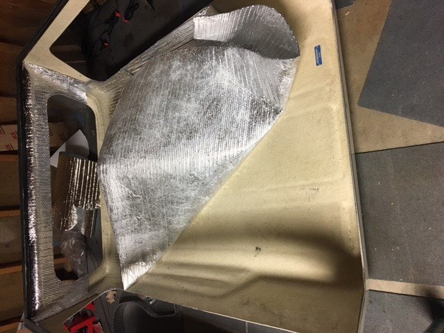

    Currently in the middle of insulating the cap and lining with carpet. Been using 3m 90 Industrial Spray Glue, and aside from an issue with the first can that lead to a respray of most of the insulation, it's been pretty smooth sailing.

    The insulation is Reflectix, comes in rolls from the hardware store. There's a noticeable difference in temp with it in place, and it's pretty easy to work with. Flexible and cuts well with a razor blade. I've got new seals on order and will be building a platform for camping once the topper's ready to go.

    Insulation and carpeting is done! Managed to get full coverage from a single 8x10 outdoor carpet from home depot. Had to get a bit creative filling some gaps and stuff, but it looks pretty nice overall. Waiting on a few more feet of window seal, but should have it on the truck by next weekend.

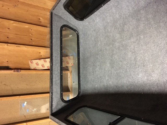

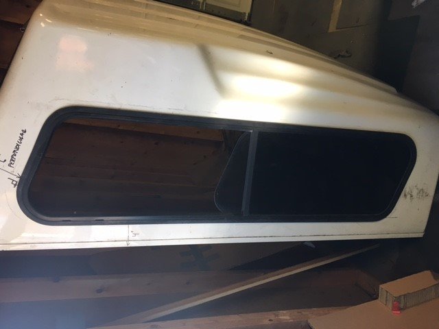

  11. Feb 27, 2017 at 8:32 AM
    lukester78
    lukester78 [OP] Well-Known Member
    Nov 3, 2016
    #201425
    885
    Luke
    97 Tacoma Single Cab 4x4

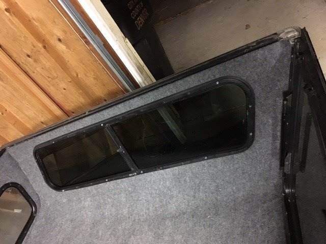

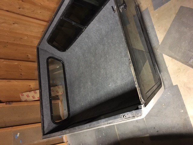

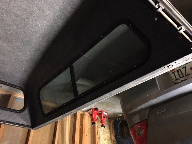

    Got the carpeting done, cab facing window and lift gate sealed and installed, side windows are just mounted to see what it'll look like (I'm waiting on the seals, the shipment was supposedly 3 day shipping, I ordered it last Saturday... lol)
    Some of the seams are visible, mostly at the front corners, but overall I'm happy with it.
    This project was a great excuse to buy a ryobi impact driver/drill set, I love it!
    Sorry for all the upside down images, I keep forgetting to rotate prior to uploading and I'm too lazy to change them out.

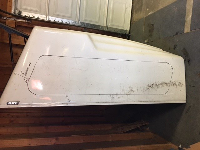

    I did install the windows, I pulled them out of another topper and used a cardboard template to make a rough cut using a cheap jigsaw.
