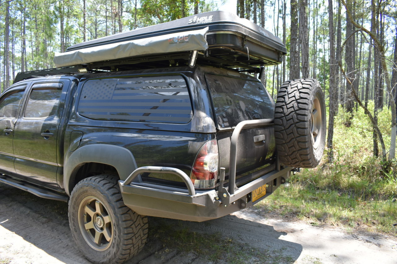

    IMO you should hold off on that AAL, my truck is still on the factory suspension in that picture as I'm saving for my lift kit. Yes its got a bit of a sag right now but Ive got a good 700# of armor, tent, shell, and spare hanging off the back. The shell alone wont affect the truck terribly. Buy the shell, then do some math to figure out the weight of what else you're going to be carrying (bumper, tent, gear inside the camper shell, etc.) and how you want the truck to sit height wise and then invest in a full leaf pack rated for your needs.

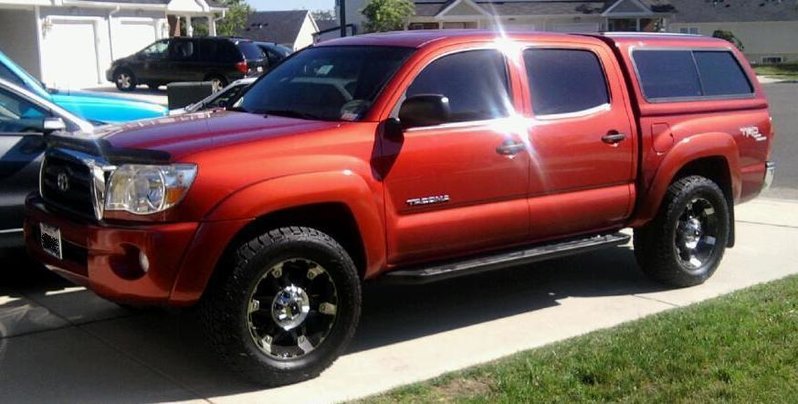

    It’s hard to know how far down the rabbit hole you’ll go.
    I started with a tonneau cover and Toytec 2.0 Boss suspension. Then as you can see it has progressed... first I added a leaf, more mods, changed out leafs to Dakars, more mods, added a leaf to the Dakars, more mods, changed out to custom valved 2.5 Kings, more mods, and recently swapped out Dakars for a custom Deaver leaf pack based on the actual weight of my truck.
    So like others have said, think about how much you’ll be adding in weight and do it right from the beginning. 956C4908-5898-4F33-8F8B-1B4F82CB3091.jpg
