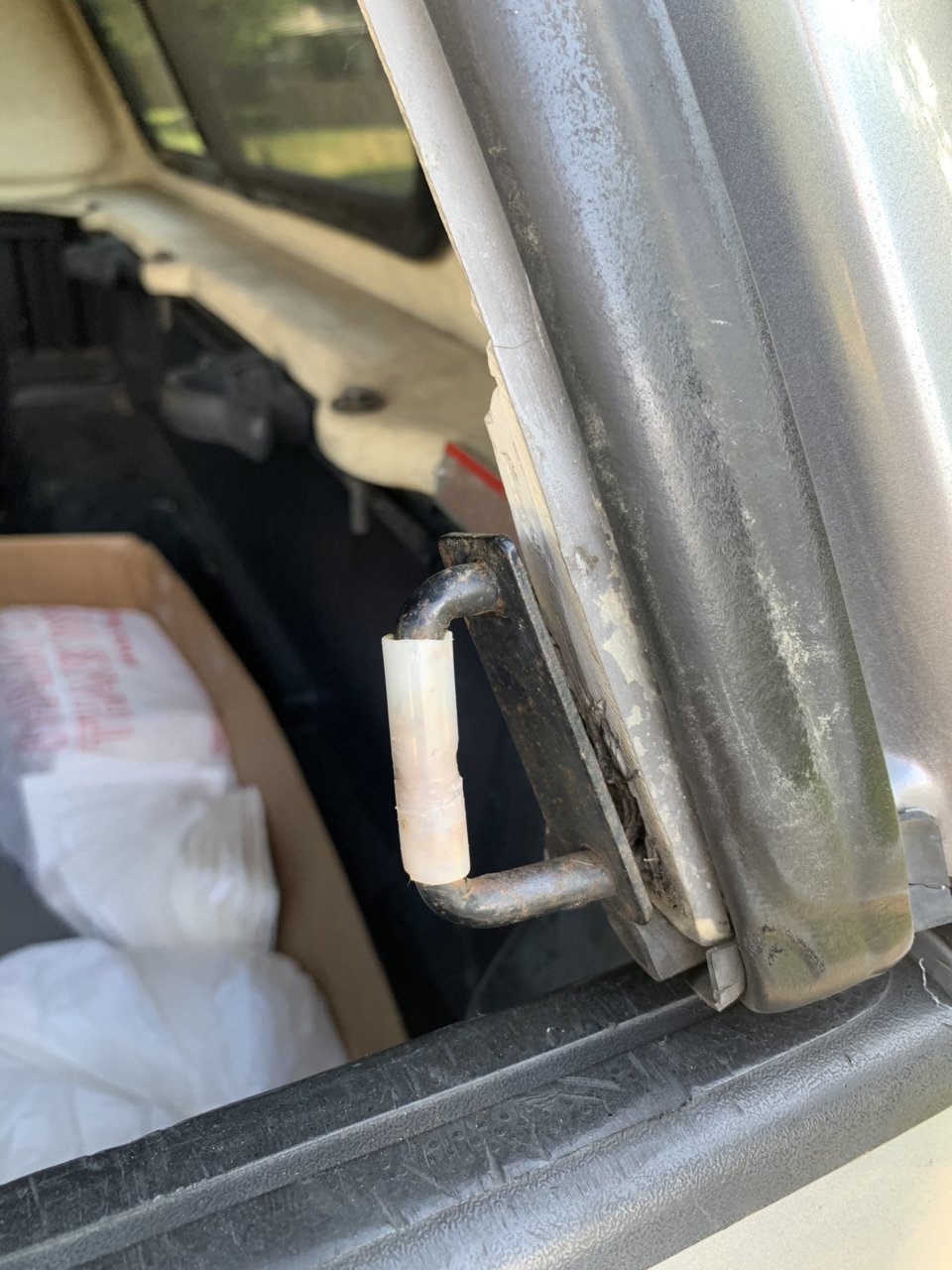

    Is there a curtain way to tighten them? I noticed a plastic cylinder piece around one side and not the other.

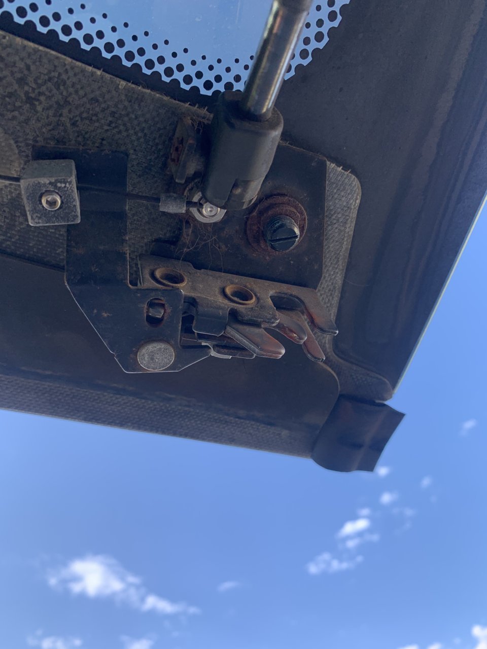

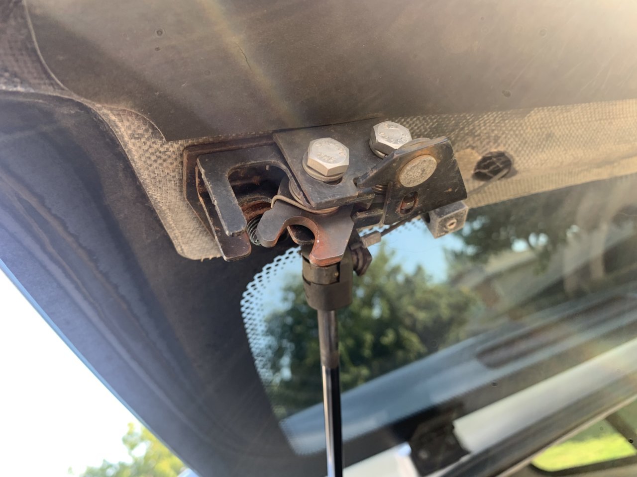

    Adjusting them really depends on what kind of latch/latches they are.
    Post some pics.

    It seems more like the latch. I can manually move it and make some noise

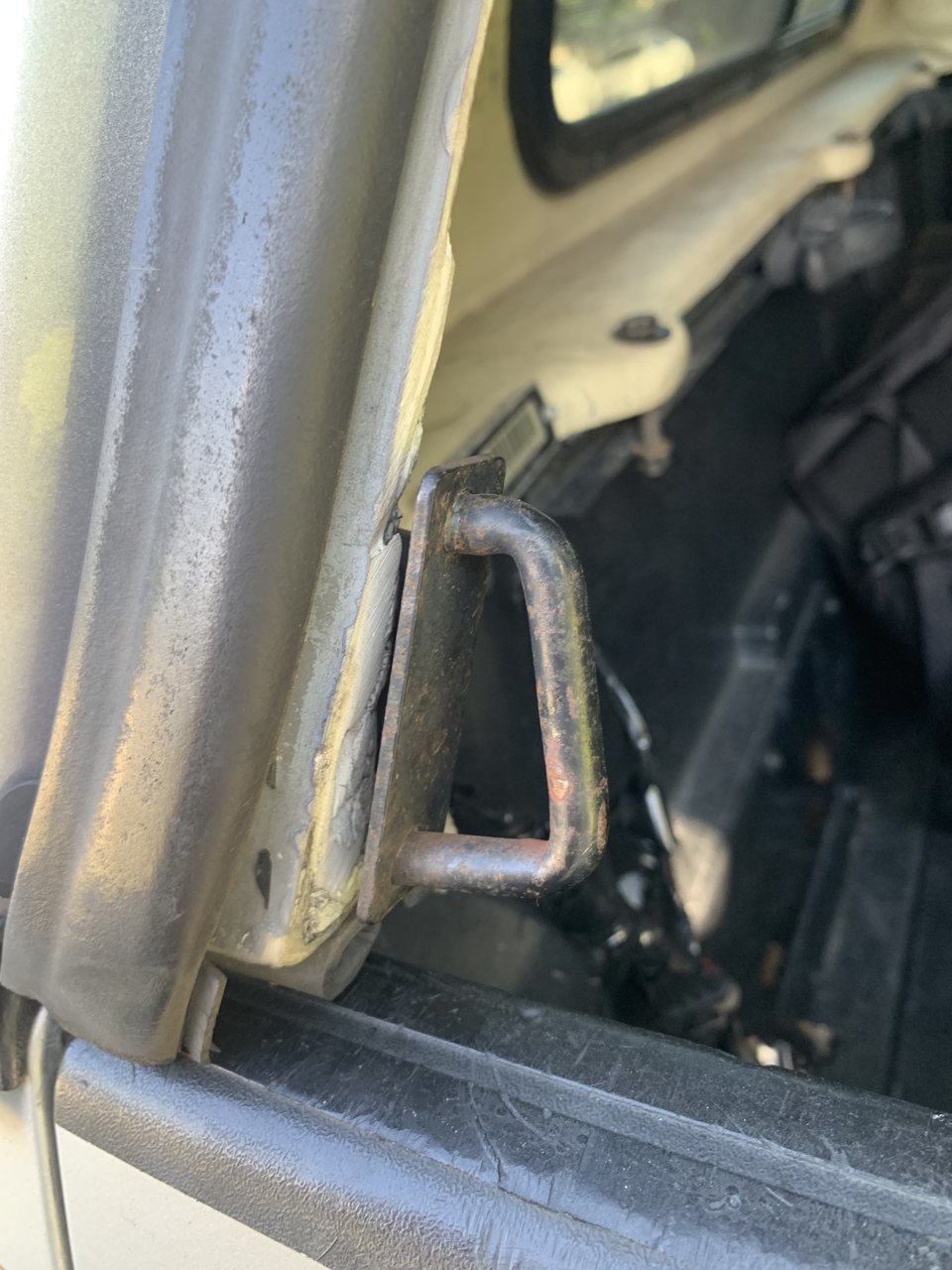

    Move the striker bars in. There should be some adjustment slots just inside

    My Leer rattled until I adjusted the strikers.

    I’ll try moving the striker bar. Yes it’s the side without the nylon piece
