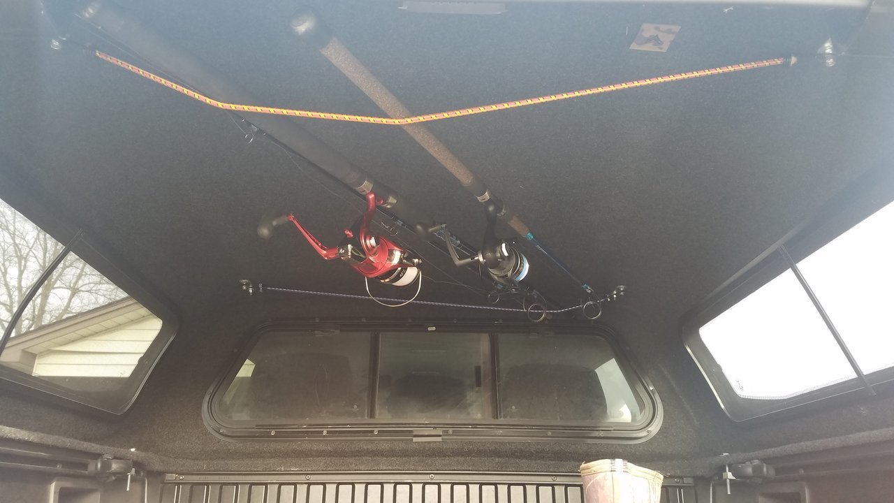

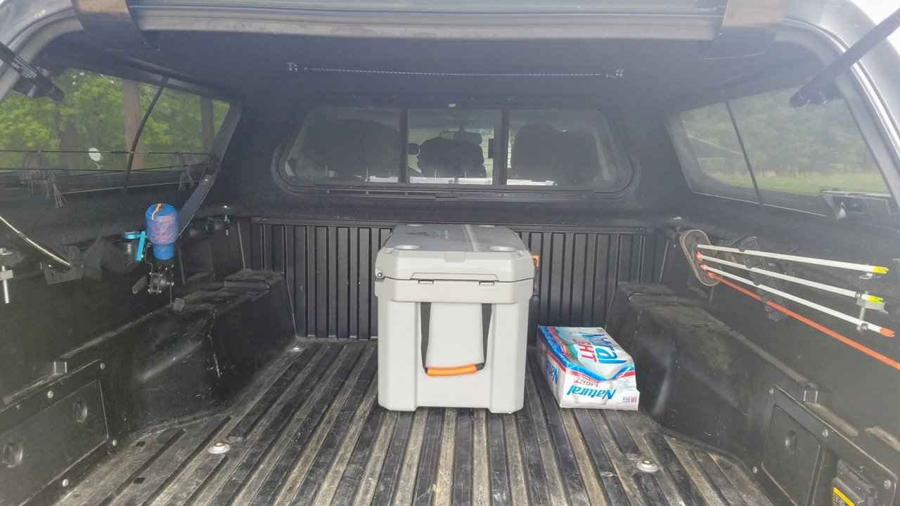

    I put a roof rack on my camper shell and use some of the bolts going through as anchor points for bungees to hold rods up there. Easiest thing for extinguisher and whatnot is some quick fists in the railing. I've also seen people make rod holders out of wood that go between the ceiling and railing where the windows are. I would guess some sort of threaded pressure system is used to keep it in place.
