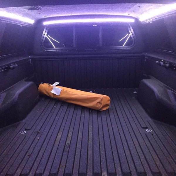

    and YES! found this RGB LED controller thanks to another forum member who's google-fu exceeds mine...
    MUCH nicer than the stupid credit card remotes I have been playing with.
    velcro works /great/ with the snugtop lining. assembled my strip in the alum channel and velcroed to roof. daylight picture coming up in a sec.

    ok, early twilight pic was *boring*
    here's some after-dark pics...
    first bunch are all 30s exposures at f/10 and iso400, thats approximately what it looks like when you're dark adapted.
    dimmest red:
    dimmest amber/orange:
    dimmest white:
    same, from farther back...
    BRIGHT white. eek, almost too bright.
    party mode!!

    it lives in my truck, gets used every time I'm doing anything at night. dim red for astronomy, random colors for campouts. power drain is very low so I can leave it on for hours and hours without denting the battery.
    the controller is velcroed to the side of the back of the cap. the black-red wires are to the cap's brake light, which I wired through the same 3-pin connector...
