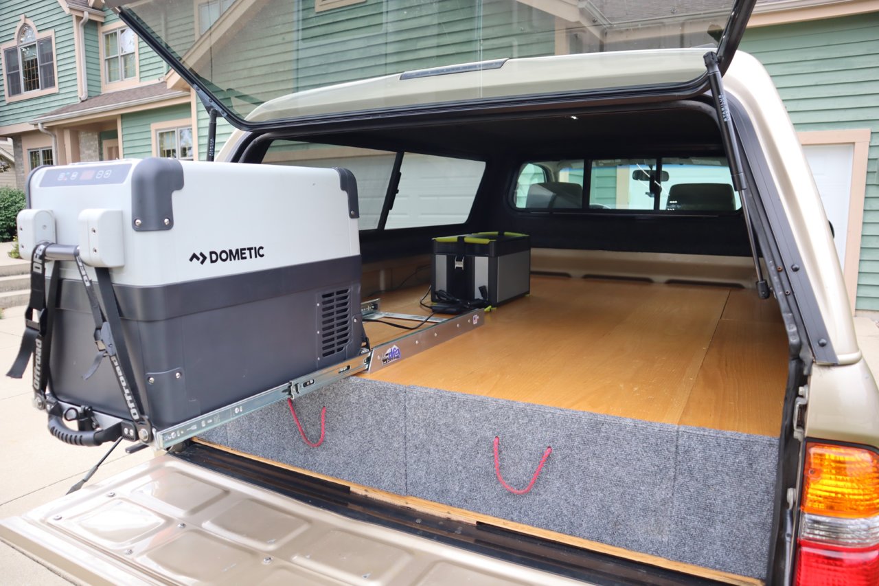

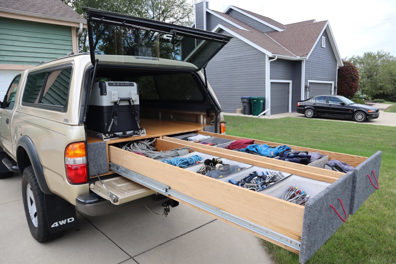

    I can share a few. I built a bed frame with sliding drawers out of 3/4" plywood. Sanded, coated with urethane on wear surfaces. Drawers run on 500 lb heavy duty slides:

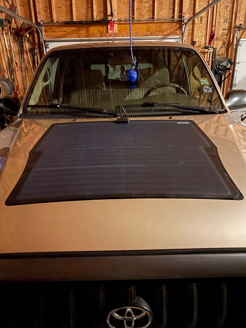

    I have a 12 V Dometic fridge on a pull-out slide from DFG Offroad with a 1,000 Wh Goal Zero. The Goal Zero is charged by my alternator when the vehicle is running (120 watts/10 amps) and by an 85 watt max hood-mounted solar panel when it's sunny. The panels covering the wheel wells are removable and can also be used for gear storage.

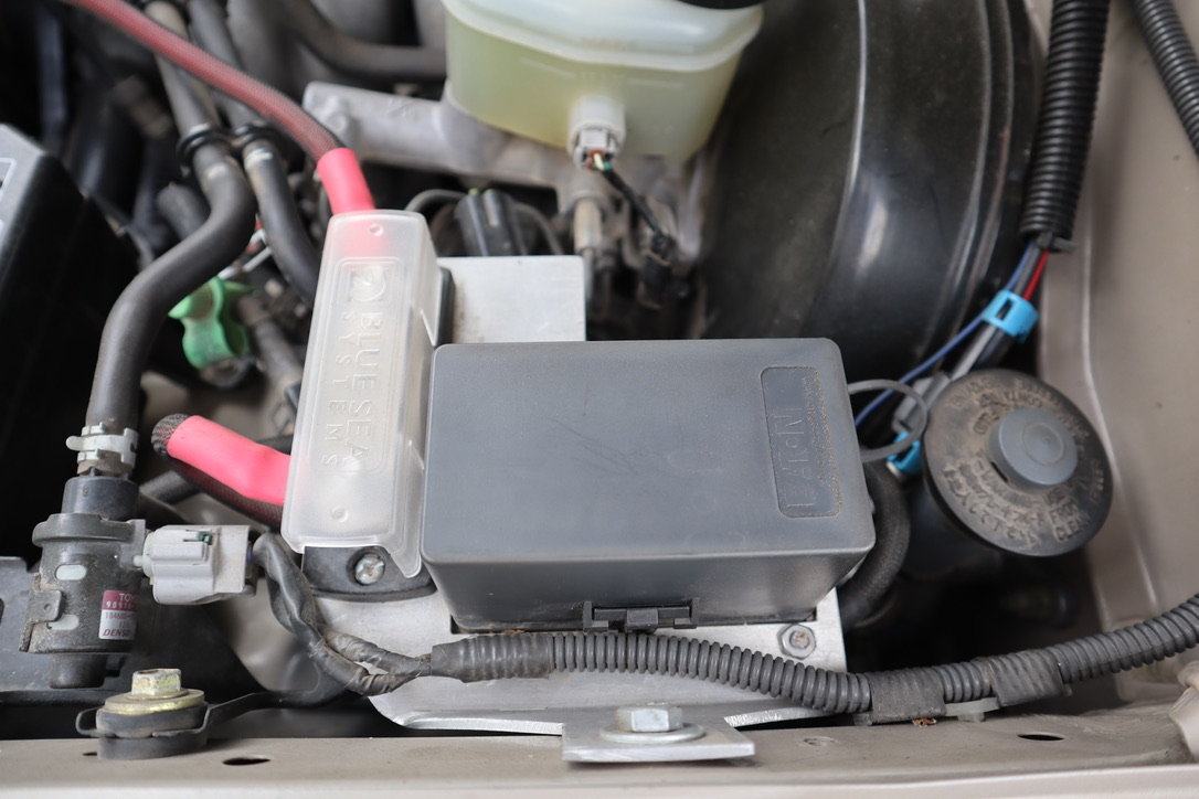

    All of the house wiring is run off of a Bussman panel that I mounted under the hood, rather than tapping the OEM fuse box. I've got a thread out there somewhere that describes how I fabricated mounts for it in my specific truck.

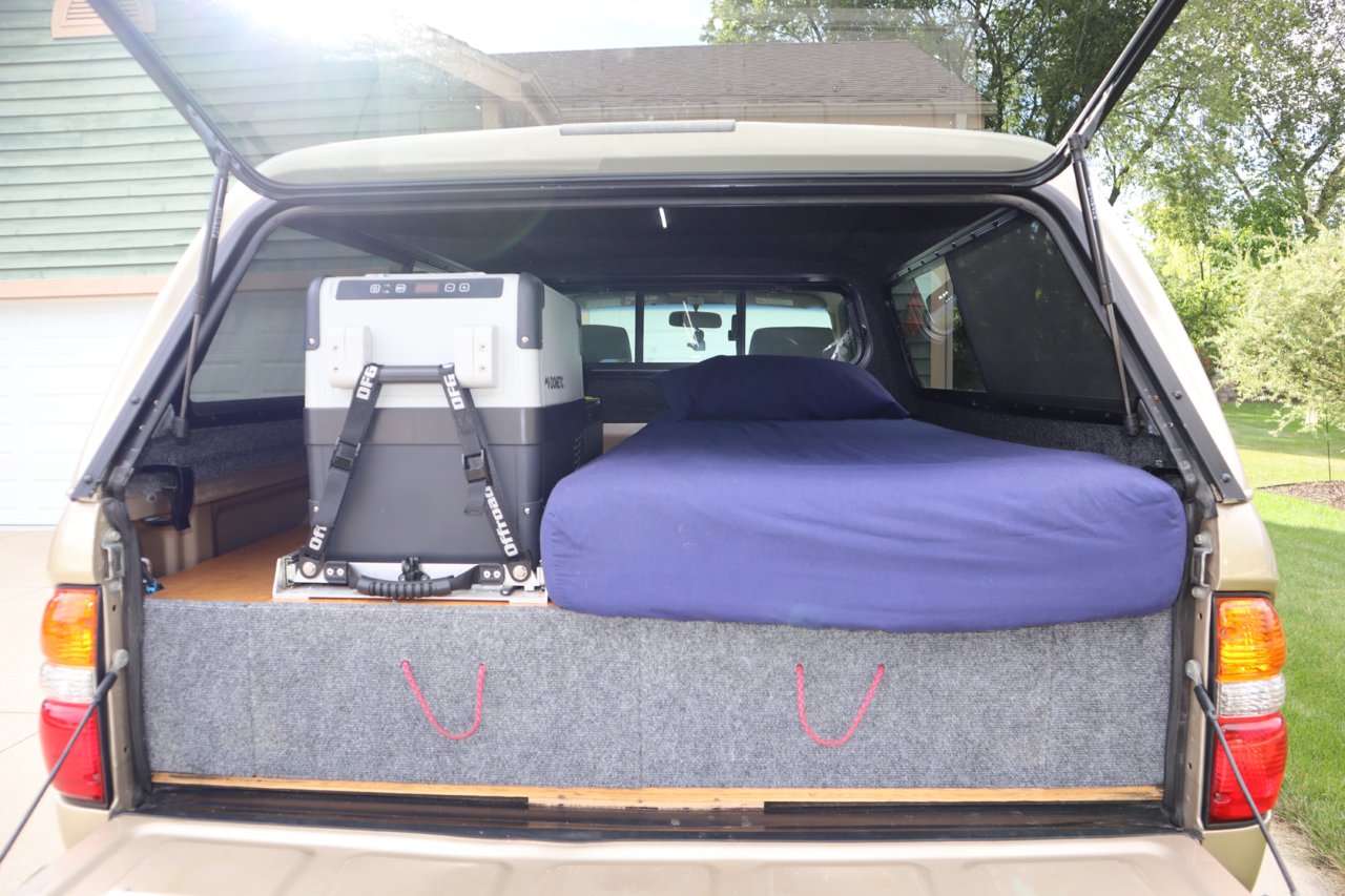

    For bedtime, I use a trifold 6" memory foam mattress with cot sheets and a sleeping bag. Works awesome. I added a rubber tailgate seal kit to keep dust and water out of the topper as well.

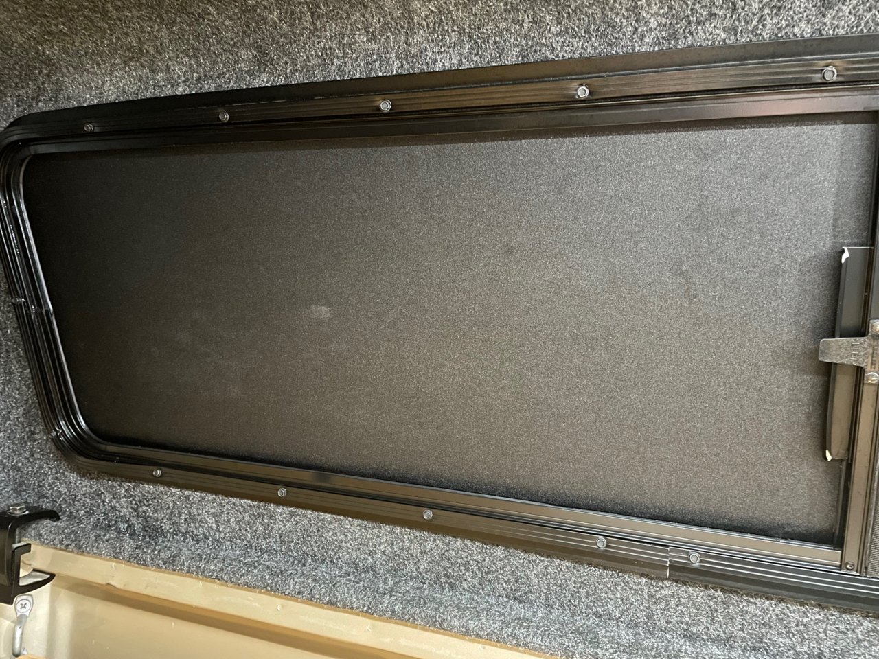

    I also recently blacked out the topper windows to keep my gear away from the prying eyes of crack heads (and to not get woken up by the sun when camping!). I used static cling blackout film and spent a very long time getting it to match the window contours, but it was well-worth the time.

    1. I must have a link to that hood-mounted solar panel that is genius.
    2. What are those metal drawer rails for your Dometic?
    3. Does the Goal Zero charge on the stock Alternator?
    4. Last one, any suspension upgrades for the rear with the added weight? Add-a-leaf?

    Thanks! It's been a year or two in the making!
    1. Here's a link to the Lensun panel I used. Expect a few weeks for shipping, mine came from Shanghai. Instructions were rather poor; familiarity with installing automotive vinyl will help you out a bunch. Happy to answer questions for you if you decide to buy one. Cascadia 4x4 used to sell this panel in the USA for 1st gens, but is no longer on their website. I have always suspected they are rebranding/kitting the Lensun panels, they look very similar.
    2. The aluminum slide is from DFG Offroad, link here. It lets you pull the fridge out of the topper so you can open it (otherwise the door runs into the topper roof!). A lot of the fridge manufacturers offer their own slides but Dometic for whatever reason does not have one for my fridge (the CFX28). DFG was the only place I could find one that had the features I wanted.
    3. Yes, I have it set up to draw off the alternator when the vehicle is running. I use a 10 amp charger, but there are "fast" chargers that pull up to 40 amps. The wiring job is more complicated, and you'd probably have to upgrade the stock 70 amp alternator.
    4. Yes, I am running Nitrochargers plus Dakars with the extra leaf in the back and Nitrochargers with 880s up front. I'd say I achieved about 1" - 1.5" of lift after settling. Been on for a year now and have settled nicely with no sagging. I regularly haul 500+ lbs of gear/platform around with no issues. Stock suspension sagged like a MFer with my setup.
