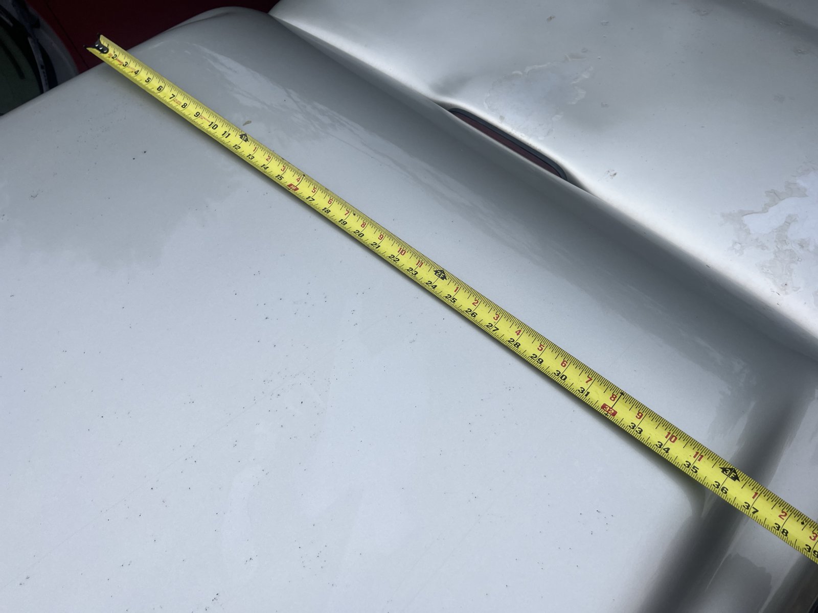

    However, the snugtop has a raised portion that tapers near the front, making the space narrower for mounting the tracks than what I have typically seen. I think most tracks are spaced about ~40ish inches apart, but I'd probably only be able to get them about 33 inches apart at most on my camper.
    Is this a concern for mounting something like a hard shell tent from a weight perspective? I'm considering something like a roofnest sparrow, so somewhere in the neighborhood of 130-150 lbs.

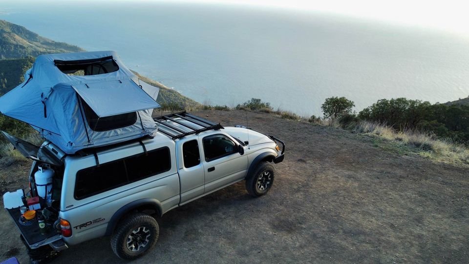

    Here's a pic of some else's rig I had saved with the exact same camper shell + truck as mine. Looks like it's not a problem for a light soft shell tent, but wondering if what I'm after would make a difference.

    I have also wanted to do this but everything I have seen shows that eventually the fiberglass will begin to crack and eventually fail.
    That would be my primary concern, the mounting width of the frame rails probably wouldn't have too big of an effect.

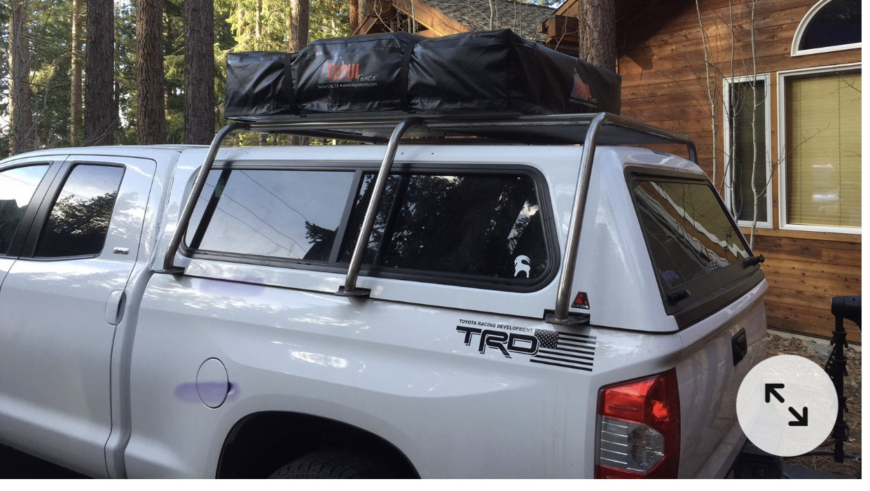

    If you can fab, you could build an exoskeleton of sorts around the shell to carry the weight of the tent directly down onto the bed rails, keeping all the weight off the shell. Like this:
    Or in the same vein, an internal frame that your roof rails bolt directly onto.
    The ARE CX HD shell comes with an internal frame for this exact reason.

    1st gen specific stiffeners: Of course there's always a chance you throw it up there and never have any issues, but you should be aware that fiberglass shells are not very well suited to carry all that weight. People have done and will do it.

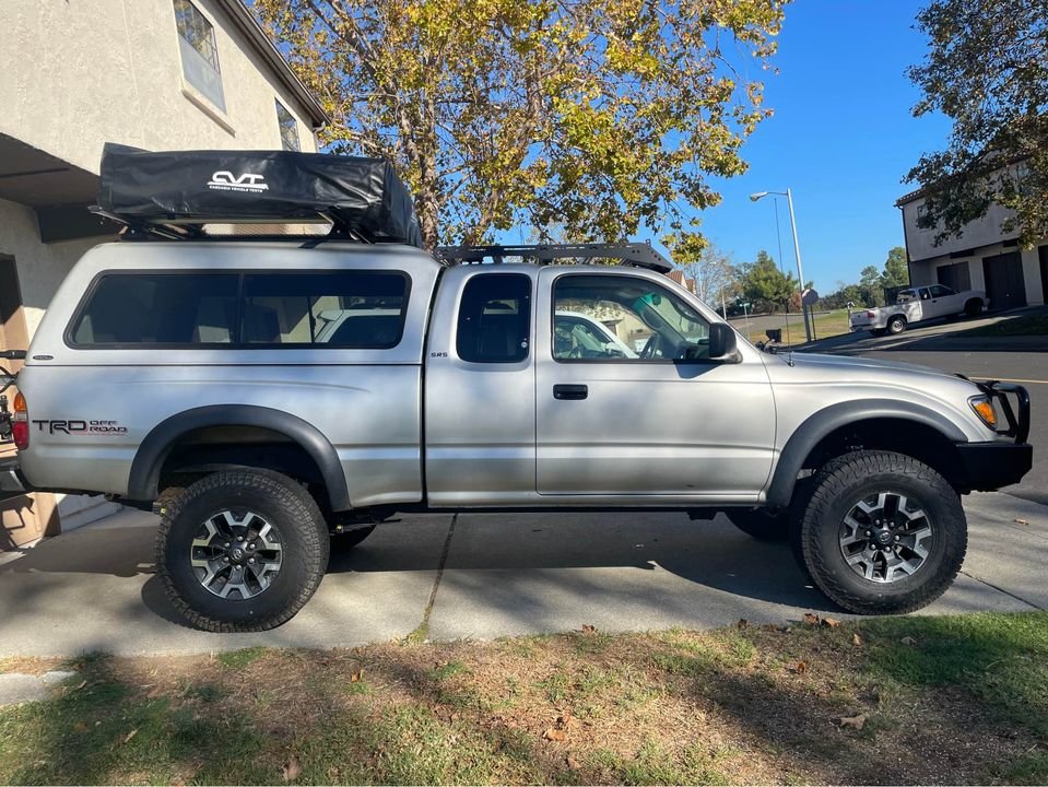

    Another option is a ladder/lumber rack, there are some that are made to mount over a shell like this:
    You can see how the shell didnt have to be notched here.
    Drawback is you look like a contractor, but youd get over cab storage space too. May have to add a couple cross bars too to make it work for a tent.
