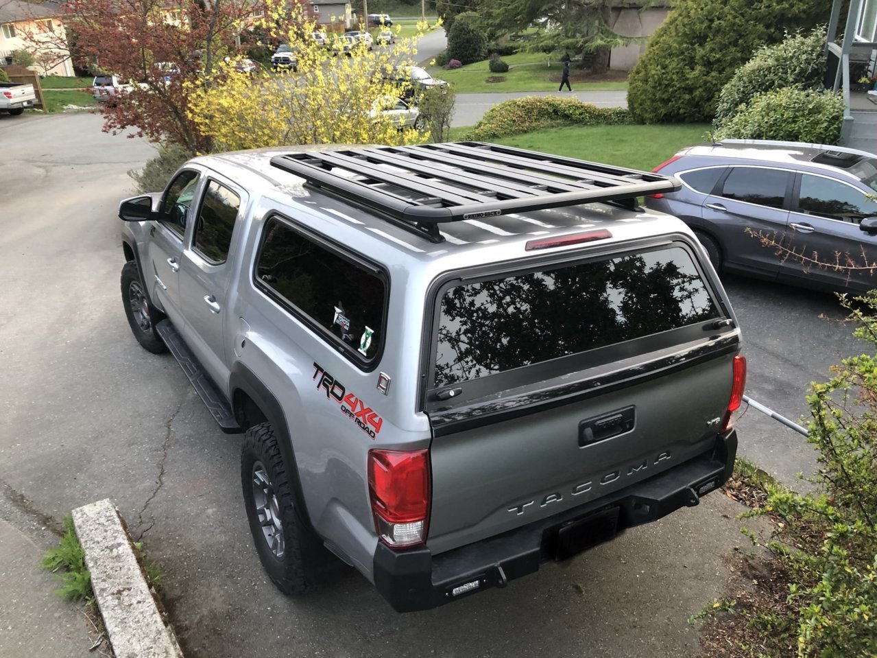

    My shell does not leak. Not a drop, ever, even after two years parked outside in the PNW rain. You just need to avoid the following:
    1-Avoid crappy installers who don’t know how to seal the two front bed gaps that are notorious on the Tacoma
    2- Avoid vent style pop-out opening windows (they always leak)
    3-Avoid “flush style SUV” windows without a proper window frame an gutter (water sits on top of the seal and will find its way in)
    My cap has opening windoors on the sides and a solid removable front window (to clean the cabs back window). All windows, including the back are the “framed” style with gutters.

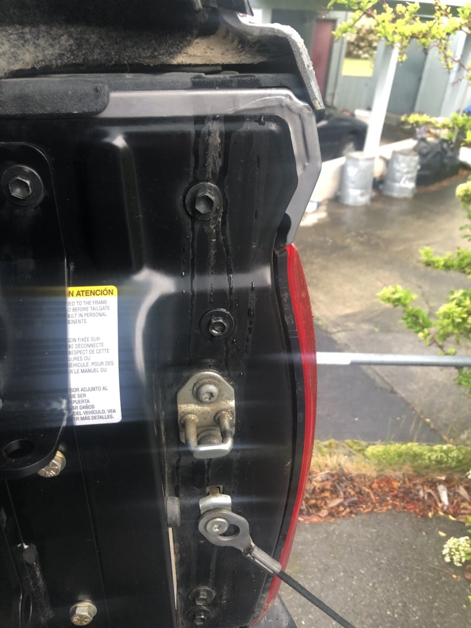

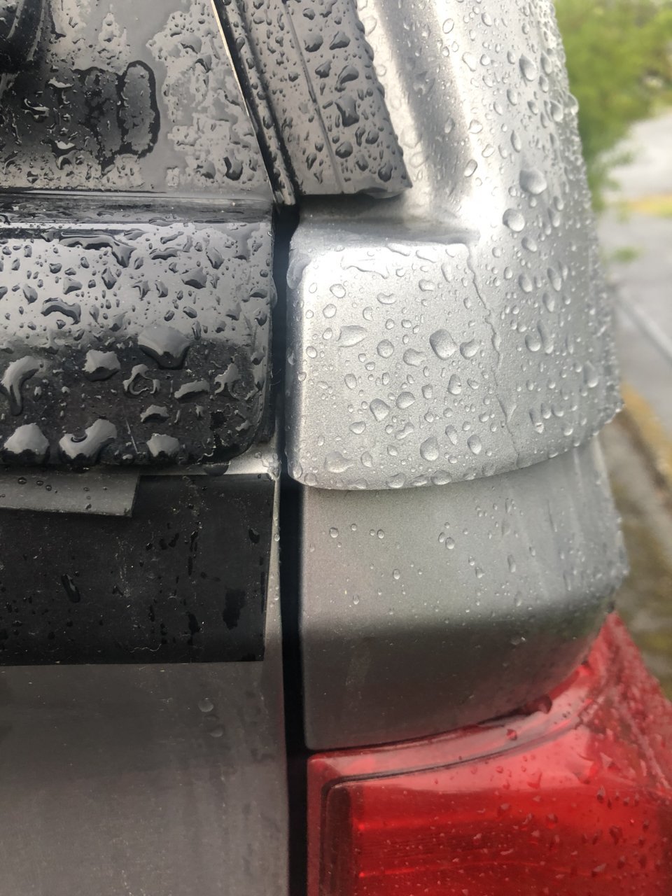

    Would you mind posting pictures of the lower corners on your shell's rear hatch? I have a similar shell(Leer 180) and I can't figure out a good solution for sealing the point where the aluminum hatch frame ends and the curved plastic piece begins. Just down and out from the latches.

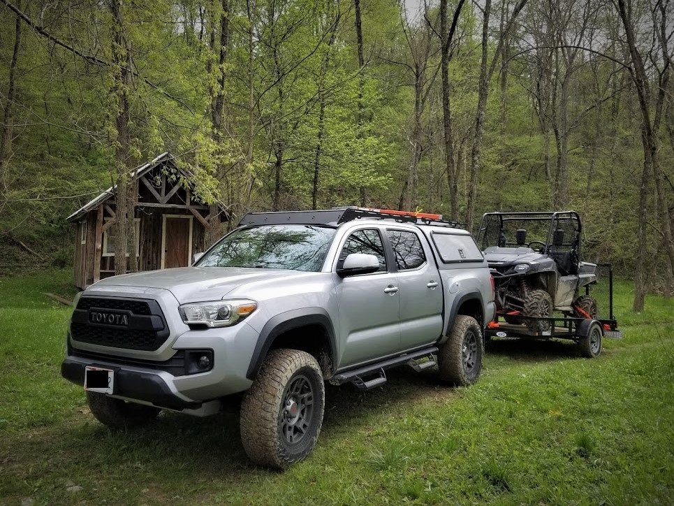

    No problems. No leaks. Not an afterthought.
    Just make sure there is a good gasket installed before the topper is placed.

    I guess there is a gap there. I never noticed. The water seems to shed to the outside.
  17. May 14, 2019 at 7:55 PM
    #17
    Stocklocker
    Stocklocker Well-Known Member
    May 15, 2017
    #219125
    12,741
    17TRDORDCSBAT
    So looking at this. The water runs down on the outside of the bed pillar. If any is ever in the bed, it either runs out the tailgate or is under my bed mat.

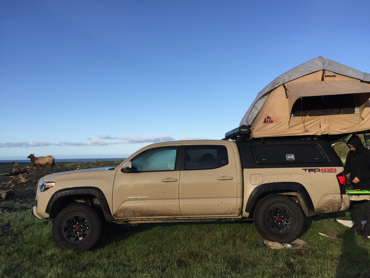

    Happy with mine in Black.
