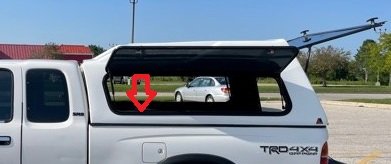

    Hi folks, wanted to see if the considerable knowledge pool here could help advise on where to find some of the window seals for my Leer 122 75K.

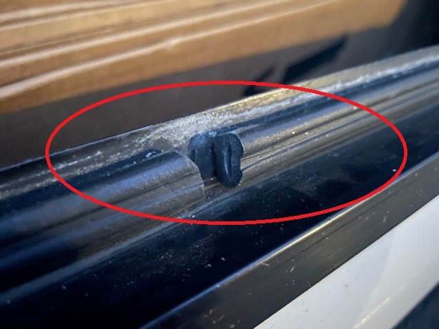

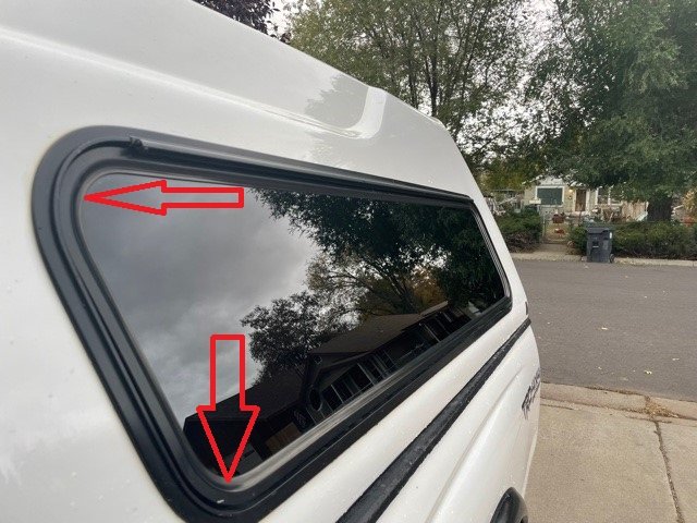

    1) Exterior perimeter seal for windoors, it has a profile that allows it to be jammed into the frame on the outside and it basically holds the glass in place.

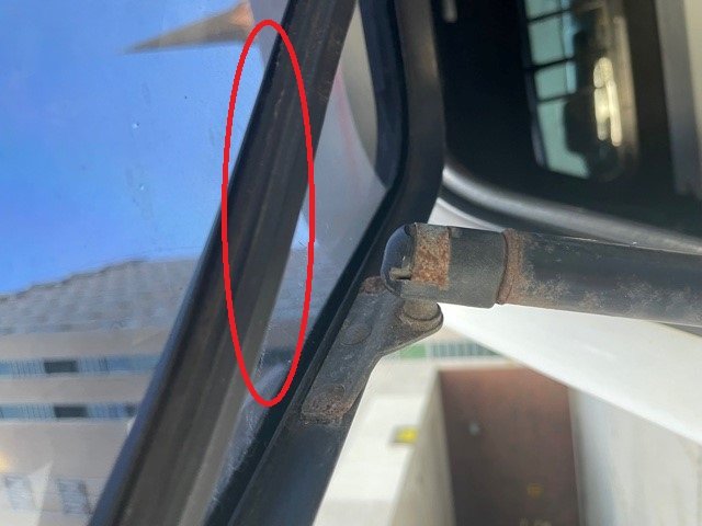

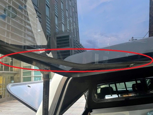

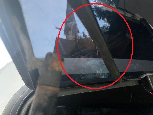

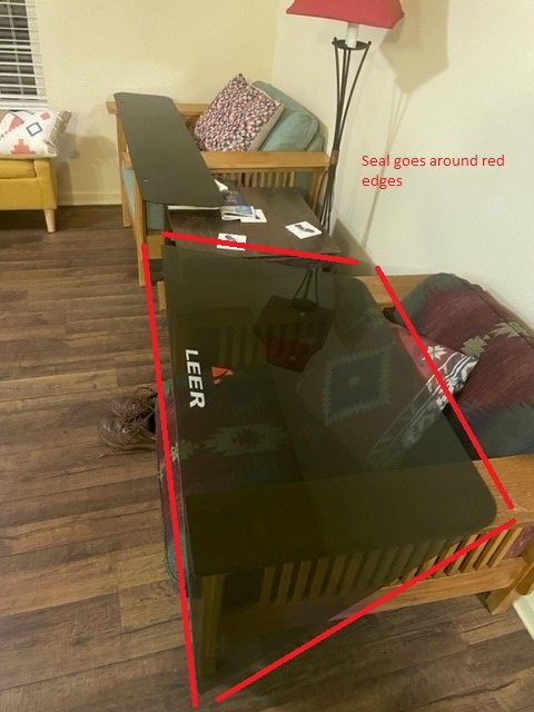

    2) Seal that holds the rear window glass and is shoved into the rear window frame. One youtube video suggests using a kind of channel glazing that's used in glass shower doors like this, but wondering if there's a more OEM/Leer/cap specific seal out there.

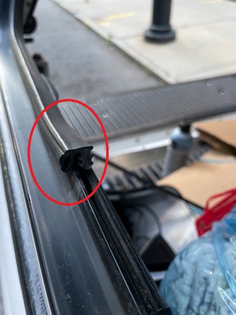

    3) Seal that goes on the inner part of the windoor frame (still facing outside), which mates with the windoor frame when it is closed. Meaning, the seal that is part of the windoor open/close contact but is in the stationary frame that stays on the shell and does not flip out. It goes into a channel in the window frame and then also has a bulb on the other side of the channel.

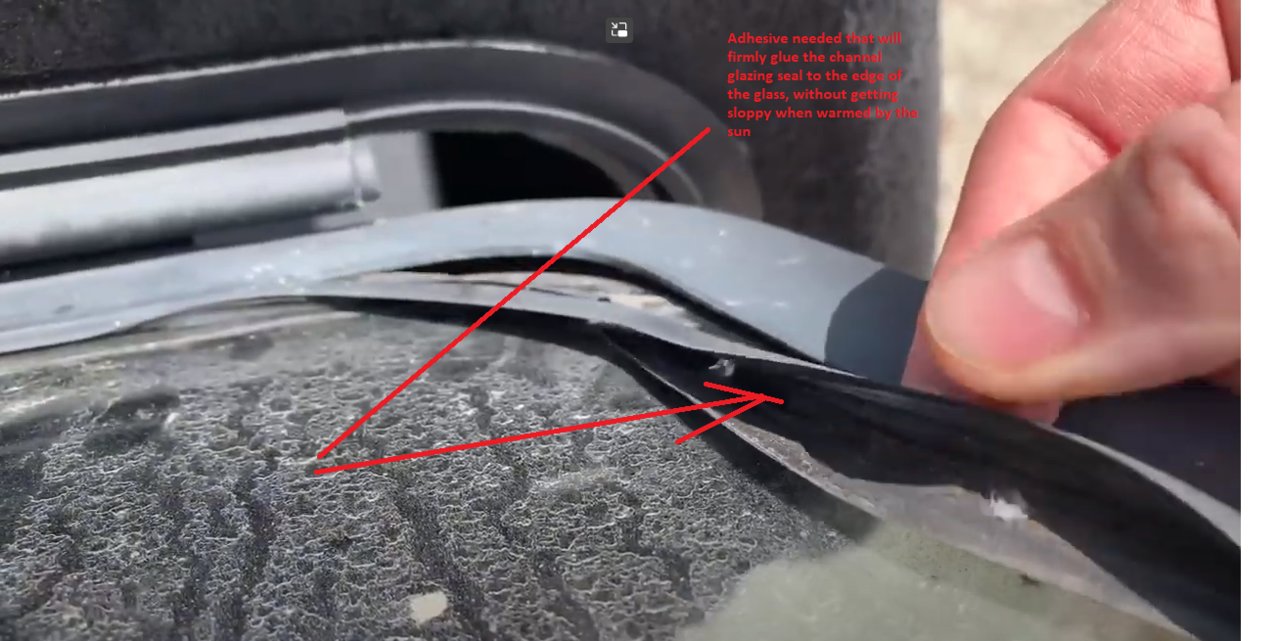

    Any thoughts on what the best adhesive is for gluing the edge of the window into the channel glazing seal that goes around the back window? Basically, I did what the guy in the video below did but I used a cheap glue to try to keep the seal from pulling through on either side over time. Worked for a while but the back window gets hot and the adhesive just becomes goo and the seal slides around the glass after a couple months. I took it all apart again in order to re-tint the window and figured I should glue the seal on better this time.
    DIY Truck Top Rear Window Glass Repair - YouTube
    So, would be grateful if anyone can help with: 1) what's the best adhesive to glue the channel seal onto the edge of the glass all the way around and 2) what works best to soak an old thin seal in so that it regains some of its pliability and heft (simple green, wintergreen oil etc.)?

    OP, did you ever find something similar to the weather stripping that you reference in #3 of your original post?
    I just scored a used Leer 100XL (I'm pretty sure) and that would work great on the interior fiberglass on the fixed/frameless windows.

    Regrettably no, I did a fairly comprehensive search and bought samples from a number of companies that sell seals for older camper shells and motorhomes. I also went to several large camper shell places and they let me sift through their old seals and junkyards--no luck. My conclusion after wrestling with it for a while is you're unlikely to find exact matches for those camper shells that are from 10+ years ago and so you can (i) try to restore the old seals using evergreen oil and other tricks and/or (ii) find "close enough replacements" which doesn't work on like the glazing seals where you need an exact fit to get the bead of the seal to snap into the frame.
    For that one (#3 above) I tried several off of Amazon and this one was the best. Still going strong over a year after I replaced it. It's not perfect but it's slightly too big which is actually a good thing, makes a tight seal, even though I have to push the window gently when I latch it to get it to snug all the way into the seal.
    Amazon.com: VITAM AMO Weather Stripping Seal Strip for Doors/Windows 18 Feet, Self-Adhesive Backing Seals Large Gap (from 5/16 inch to 15/32 inch), Easy Cut to Size : Everything Else
