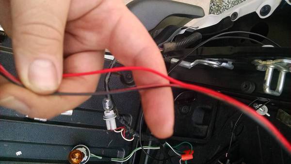

    I took the 2 bolts holding the brake light out and removed it. After I removed all the bulbs/bases from the light, I set it aside. I then pulled 2 sections of black 16 gauge wire from the brake light compartment into the truck bed area. There is just enough room under the bed rail to fit a few pieces of wire. This is what the brake light bulb wiring looks like.

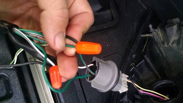

    I found out on this post, http://www.tacomaworld.com/forum/2n...ring-third-brake-light-bestop.html#post774429 , that the green/red was for my brake light and the white/black was my ground. Normally I won't trust a Phillies fan but I decided to give it a try after testing with a meter. Not a good picture of the splicing job. The in-line splices I bought from Advance auto were horrible so I had to cut and splice with wire nuts.

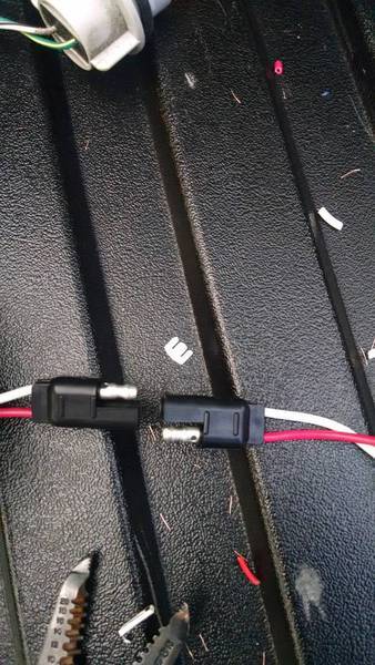

    I used plenty of electrical tape to ensure the will not come loose. No pictures of this. I used the following quick disconnect so I can take off the shell if needed.

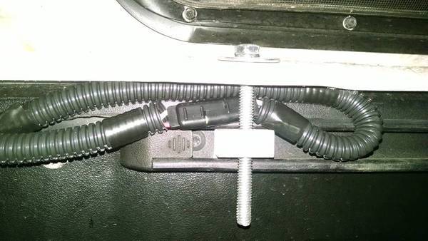

    After I used butt connectors to attach the 16 gauge wire to the quick disconnects, I used heat shrink and flexible wire cover material to protect my wire. This is how I chose to place the pigtail to look neat and clean.

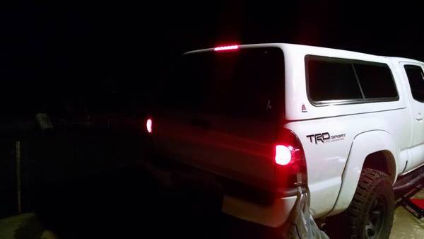

    The finished product.

    what? no, do not use household wirenuts for 12v wiring on a car. do it right man.

    Didn't have anything else around. I had to use what I had.
