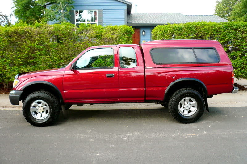

    The leading edge of a reg cab topper vs that of an extra cab will be different.
    The rear portion of a reg cab is pretty much straight vertical. The rear portion of an extra cab is curved forward. The respective toppers match those different contours. So if you were to get an extra cab topper for your reg cab, the top of the topper would rub against the back of your reg cab.
    Any years from 95.5-04 will fit.
    Here are pics so you can see the difference:
