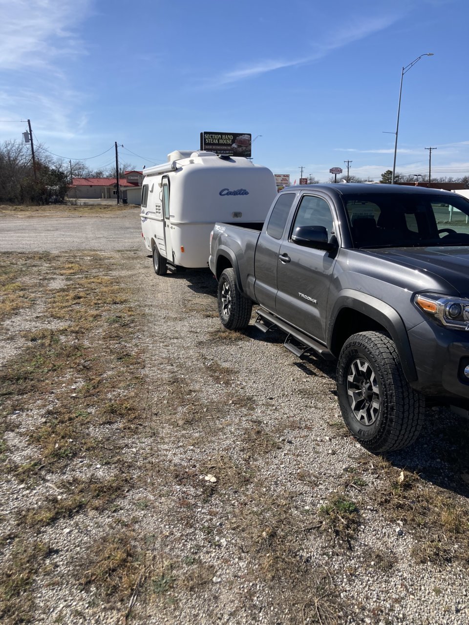

    Mine is a 17ft casita. Tacoma handles it very well, and gets about 15 mpg while towing. They are more narrow than most and not near as tall, dry weight is about 1500lbs. I’ve heard camper shells can help with towing since the air goes over the cab and then the camper, but I don’t have one and can’t prove that.

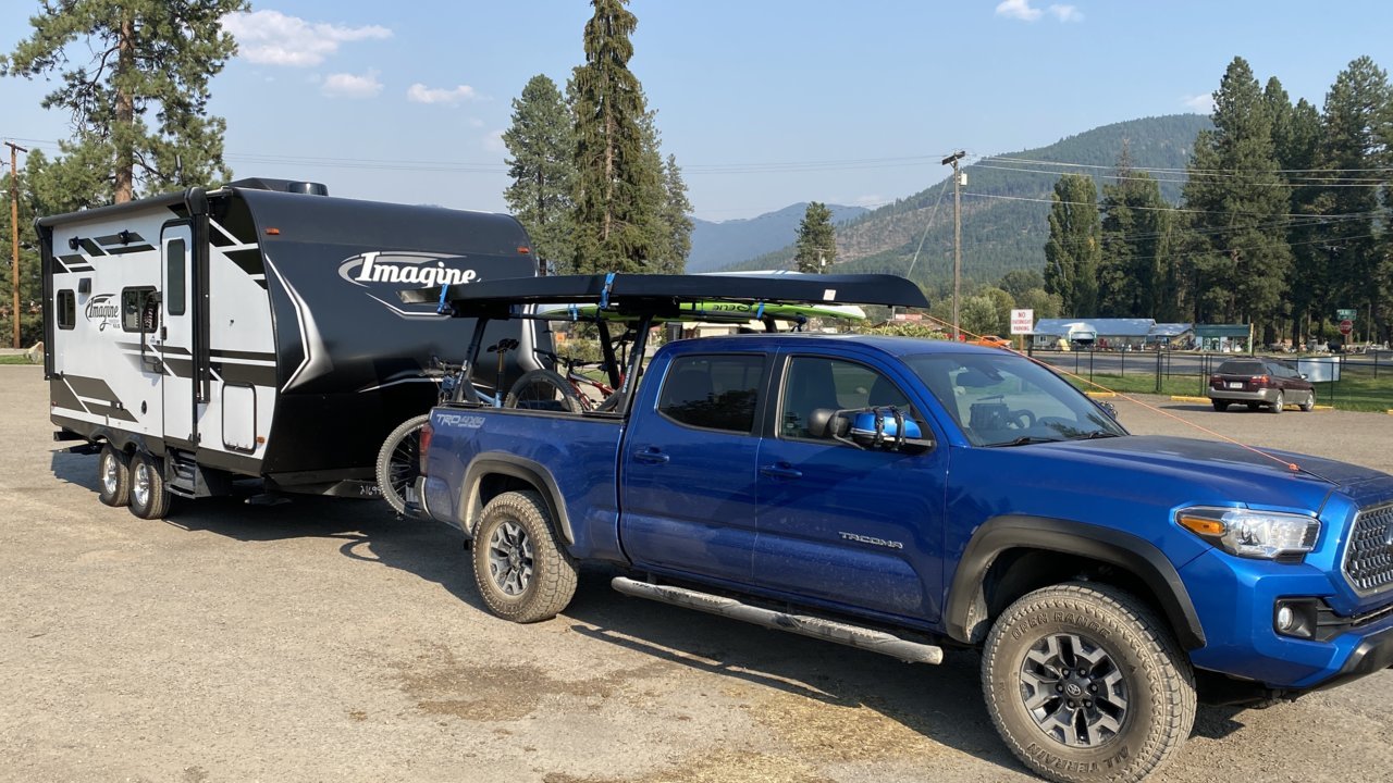

    Grand Design 17 MKE about 5,100 or so loaded. Have not actually weighed it. Two MTB bikes in back (carbon fiber and less than 30 lbs each) SUP is 30 lbs and kayak is about 30 lbs. Misc gear is another 50 or so. Dual axle tows really nice and stable.
    Tekonsha P3 brake controller, larger aftermarket transmission cooler, Roadmaster Active Suspension in the back, and Equalizer E2 weight distribution hitch. OBD fusion to monitor temps.
    MPG is about 9-10. On flat trips it can get to 11. Stay in S mode. and as prior post, its ok to let the engine rev to 5k. It's a V6 not a V12 20 liter diesel! LOL.

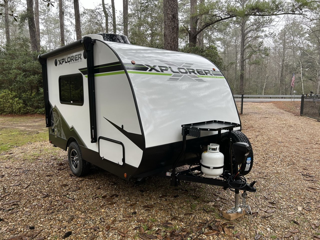

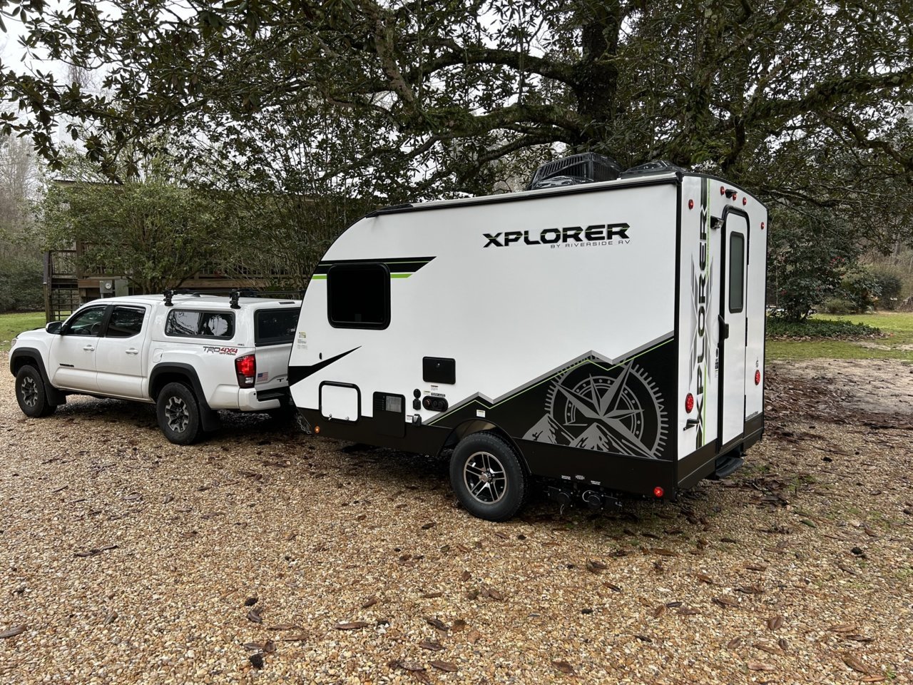

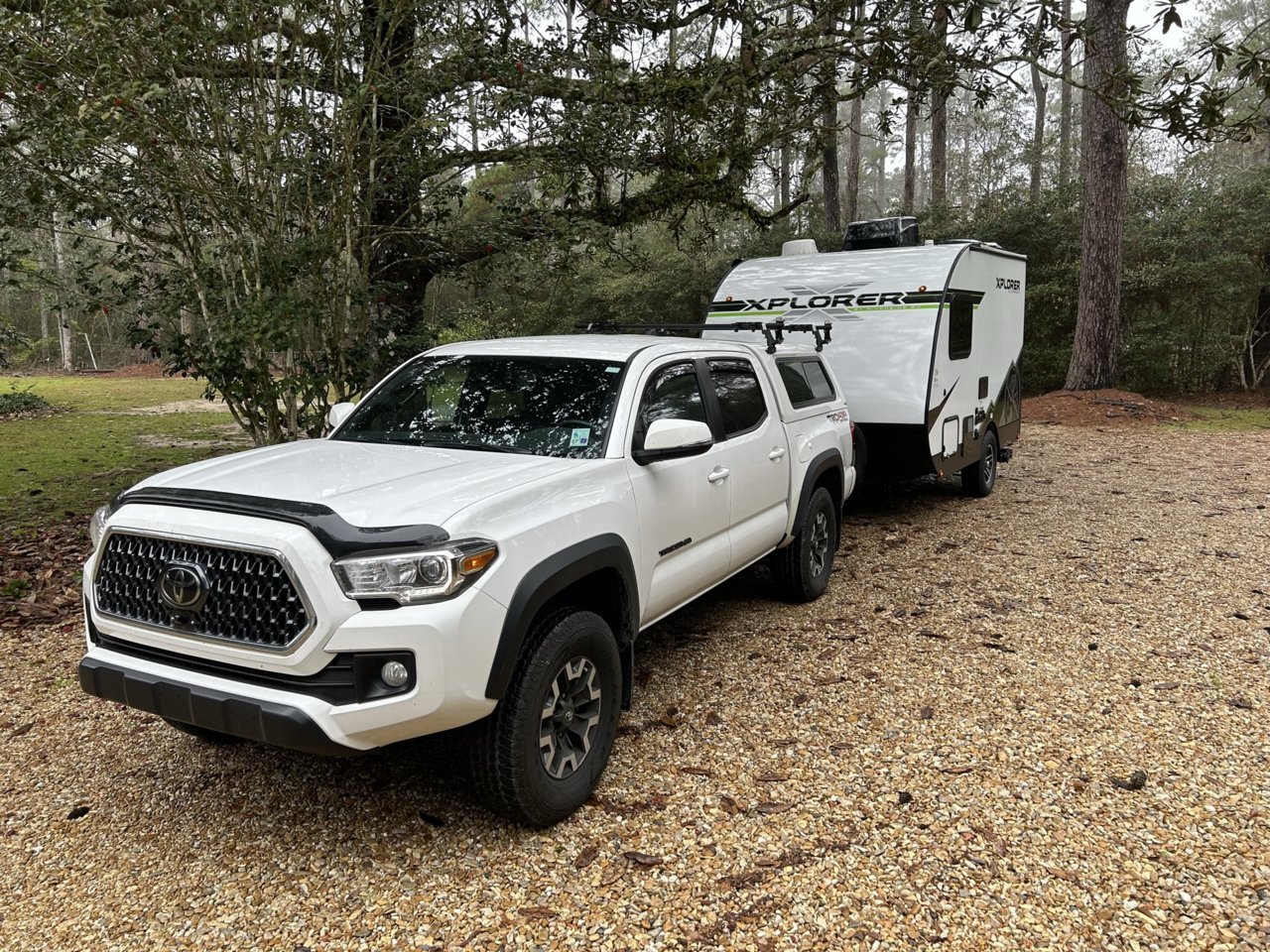

    Downsized from an F250 diesel and 5th wheel to Tacoma OR and have been looking for something light and small to use as a “bug out box” for camping and escaping hurricanes. Wife demands shower and toilet which REALLY limits the options. Decided on this Xplorer 135x. Azdel, full bathroom, 35 gal fresh water, AC, solar, full size fridge, and lighter than you expect. Dry hitch weight 160lbs. Very pleased so far and fits the bill for the two of us and a yellow lab.

    I really like your RV. I'm downsizing from a 32' Class C. This would be perfect for us just to get away for a few weeks in the summer. At this point in my life smaller and lighter would be better. Good luck with it. I'll be looking for one now.

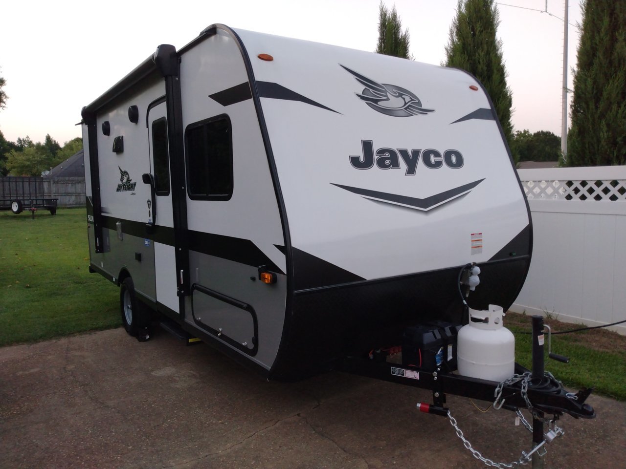

    Add a full propane tank, fresh water tank, equipment, food, beer, etc. Also consider what you'll be hauling in your Tacoma. I HAD a Jayco 154BH showing 2,700lbs dry weight. My 06 Tacoma V6 with the 5spd tranny thanked me the day I sold the TT, after 3 trips I figured I was killing my Tacoma. Bought a small class C-RV

    I had a 2021 Jayco 154BH Baja Edition (solar panels, 2 propane tanks, larger fresh water reservoir-Canadian Specs.) I really like the fit and finish of the Jayco and their warranty was excellent. I managed somehow to bend the axle (Must have been a really big rabbit!) and Jayco replaced the entire axle assembly. If my 06 Tacoma did a better job handling the weight (2,600lbs. dry weight) I'd probably still have it...sold after 3 trips.

    Is the photo at Valley Forge by chance?

    No. The old Fairfield Hills Hospital

    wonder what the inside is like

    I'd recommend considering going lighter. Take a look at the Riverside Video From Tallwalker or go to the Jayco company site and look at the 154BH (2,600lbs. dry weight).
    I really liked the interior layout of the 154BH. Twin bed, 2 bunks which could be used as storage above. Bathroom was very easy to navigate in and out
    of the shower/tub. There is a solar panel option which worked great with double batteries. I think mine had 2 propane tanks? Units built in Idaho are "Canadian Specs" which means the
    bottom of the TT is insulated. Jayco customer service is excellent and will answer any and all questions. I wish I could have kept mine but my 06 Tacoma with the 5spd. tranny just could not hack it without beating it up.
