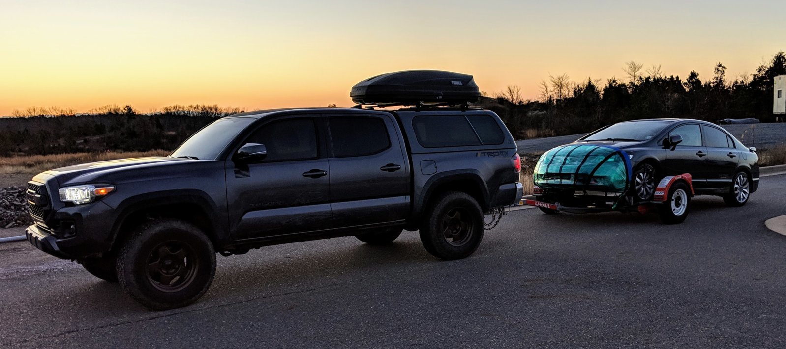

    If you think that's bad, try doing this.....

    Well it’s like having a passenger in your truck. That definitely doesn’t affect MPGs
